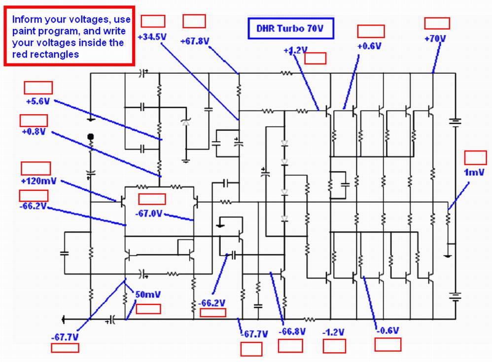

Check also the VBE multiplier board.... if you have external bias control
I do not think the Toshibas, even fake, can do that.
Measure all voltages from base to emitter and inform...maybe we gonna see where you have troubles.
inform each transistor base to emitter voltage.

VBE measurements help us to identify failures, wrong connections, missed connections and shorts.
Voltage chart was published... certainly it was, so, compare your voltages with the ones published and inform your readed voltages written above the ones informed... this will help us to see were we may have errors.

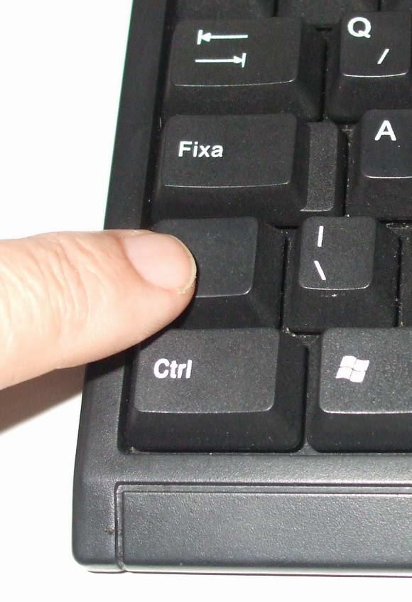

Inform the needed voltages..here you
have the image to you.... them open it, push the button you have above the Ctrl..keep it pushed and them push the Print screen button.....and them open your paint program and paste the image into the paint program screen...now you can type the values on it.
Save it and them crop and copy to GIF or JPEG and publish the image this will make us able to help you.

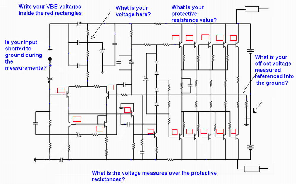

To help people to inspect boards, we need to have the board layout used as reference
and a very good picture...NOT that awfull thing i am showing you.

1. input is shorted
2.output wire to ground wire is 320 mv
3.my protective load resistance is 10 k 10 watt
4.voltage measured over protective resistances are 25 volt over the negative resistance rail and for positive rail is 25v as well but the ground is connected to earth and output ground as well.
5.offsett voltage is with ground attached to earth is 5.5 volt and even with ground wire is removed it is 5.5 volt.
6.base to emitter with input shorted is 407mv for all transistor on the negative side of the board.
Now for the positive side of the board with input shorted are: also 407 mv
My power supply measured over the caps is dc volt of (negative of cap and positive of cap measured = 62.8volt.
images will uploaded in few hours just getting camera charged up.
The series resistance cannot be 10K...this is too much
100 ohms is the maximum value.... a good value is 10 ohms as easy to divide without calculator using the "ten" base.
If you have 25 volts over the resistance...this means the current crossing is 2.5 miliamperes, and this current is 40 times smaller than the needed.... also the resistance used is 100 times the biggest value to be used.
Also, when you have 25 volts losses into the protective resistance, you will have only a few volts to feed the circuit...and this voltage is not enougth to power transistors on.. they are cutted, not conducting, not working Joka22.
Man!... really!...if you have used 10K ohms resistance as protective..not a typping error, you have a lot of courage to build an amplifier, as your knowledge seems not to be enougth to do that.... i am not happy to say..but i have to do that.... i am afraid your chances to suceed are not so big.
Also this is not an amplifier to beginners.... it has power, and some skill is needed...no one can inject that into your brain so fast as you need to succeed...i hope to be wrong and your carefull construction results in nice operation...but i am afraid the result can be different.
Reduce the protective resistances to 10 ohms, or 12 ohms, or 15 ohms, or 22 ohms, or 27 ohms, or 33 ohms , or 47 ohms, or 56 ohms, or 68 ohms, or 75 ohms, 82 ohms or maximum of 100 ohms to 10 watts (minimum power..if bigger, the better)
Maybe you have not a problem..maybe only that 10K is the problem... this VBE shows the transistors are not biased correctly, they are cutted, not conduction, they are "off".
