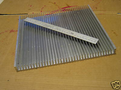

any way guys i finally got my heatsink yep long exuasting wait but well worth it all for £29.50 won it today on ebay.

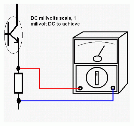

To the DHR Turbo, the difference you may have is that you will have to measure around 1 milivolts (adjusting bias) over the emitter resistances ... this is to check if all them are conducting.

This stuff was explainded, several times, into the Dx Amplifier thread, also the HRII
group buy..also into the Dx Precision 1.... the procedure is the same for every amplifier.
Into the Dx amplifier, Greg pages, you have the instructions you can apply to all wide world amplifiers.... the method to measure current over a protective resistance serves to all amplifiers..also the off set measuring system and the check up over emitter resistances into the output.
Take some time to read....this will be very helpfull to you... will save money, as errors may kill transistors.
Off set can go to 25 milivolts...better to adjust bellow 5 milivolts if possible (depends on transistor matching)
Bias can be adjusted from 50 to 100 miliamperes to each rail...positive rail may have 8 miliamperes more..no problems about that..this is normal.
Voltage measured over power transistors emitter resistance must be 1 milivolt of less than that..but you must be SURE, that all transistors are conducting..and they are conducting when you can measure something into the emitter resistances..when electrons flows througth a resistance, a voltage is developed into this same resistance extreme..potencial difference..electrons difference..electronic difference that in other words means "voltage"

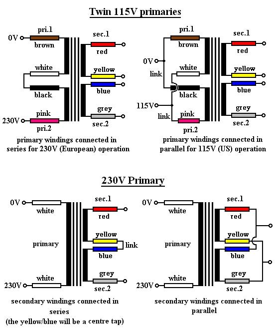

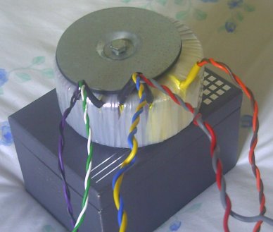

antrim toriod wiring scheme help needed
Hi i have a very heavy large antrim toriod with
two secondary wires blue,red,yellow,grey.
primary wires are orange, brown
but what are the extra wires which are:
black,purple, green, white
i like in uk 240 volt and i would like to use one bridge rectfier for the dhr turbo but the wiring scheme does not exactly match the antrim website wiring scheme.
if anyone knows how to wire this toriod for use with one bridge rectifer to dhr turbo (iwas thinking using one secondary (43vac) wiring to power the dhr turbo and the other secondary just insulated not used.

check the continuity through each of the twisted pairs.
This confirms they are the same winding.
Check there is no continuity between any one pair to any other pair.
This checks you have /have not got tapped windings.
Measure the resistance of each winding.
Post all your results.
Before you plug anything into the mains, get an insulated terminal strip and secure each wire end into a separate terminal.
Have that bulb tester assembled and ready to use. Build the simple one first without any switches.
okay for the secondary wires grey and blue conduct and the meter makes the sound and same for red and yellow. resistance over the same wires is (0.9ohm).
for primary leads brown and orange thier were no continiuity and no ohms reads zero.
okay purple and green read 1.3 ohm and does conduct on the continiuity test.
and for the black wire does not show ohm it is zero and does not conduct on the continiuity when joined to the white wire or green (white and green are joined together with spade crimp.).
all the wires that do show continiuity and ohms come from the same plastic sheating from the toriod. plastic sheating - the round black insulater from the actual toriod.
excpet the yelow sheating that is the primary wires they do not conduct or show ohms.
