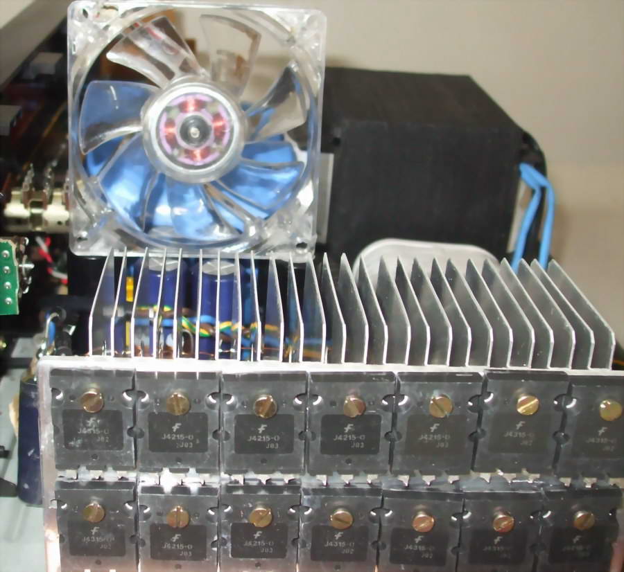

Depending how good (big) are your heatsinks it will hold 150 percent power
Along all nigth... was tested to survive such kind of heavy duty work. (this is around 3 percent distortion... and a lot of folks do not perceive this as bad sound..some folks thinks this is just "loud")
And 150% power into this beast is a lot of power... the speakers may not survive or the party folks ears will be damaged in advance this amplifier will shut down.
Was tested during one hour long...2 ohms load... around 800 watts of power (supply loose voltage) with big fan blowing air over enormous heatsink...environment temperature was 29 degrées celsius)...if survived this way..... into your Romanian winter you gonna have it working in a very confortable way.
Lovely for powerholics... reliable..... will make them happy melting speaker coils and producing cracks into home walls.... it uses to bother cocoroaches (roaches) that do not like too much vibrations and also will bother mouse... as can amplify the 40 Kilohertz sound bad filtered from the audio source..some CD players have not very well filtered high frequencies...mouse hate that frequencies..... can be lovely to people that has bad circulation and needs some massage into the legs... low frequency power will vibrate your floor... that vibration will be transfered to the legs that will receive a free massage.

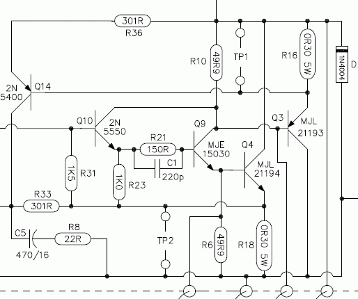

Yes ... you can use them..but they will not increase power
Power will remain the same into 8 ohms speakers......but if you decide to use 2 ohms loads, your powerfull transistor may survive..and that increase in power capacity into your output transistor will result in more power reserve capacity, this does not means the amplifier power will increase...only means you will be able to reduce your load impedance to drain more power from the output.
Installing two speaker in paralell, for instance, will drain more energy from the amplifier.... maybe, thinking this way, we can increase power, because of this new powerfull transistors you found..but only reducing output impedance.
Into 8 ohms the power will remain absolutelly the same.
Your diode can be used, check it if is a silicon diode only....but... using transistor junctions (base to emitter), substituting diodes is a better idea...and what transistor to use?.... any NPN you find... power units will be better because case is big...plastic cases is even better because you will not need insulators.

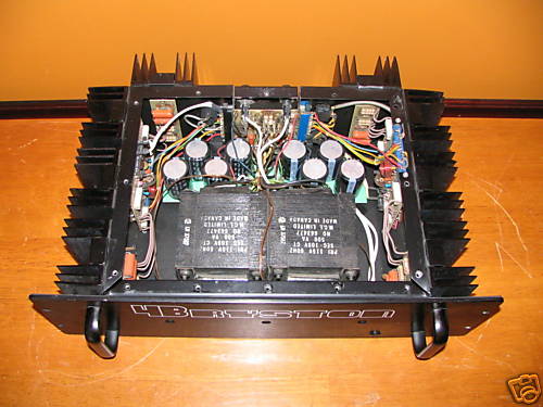

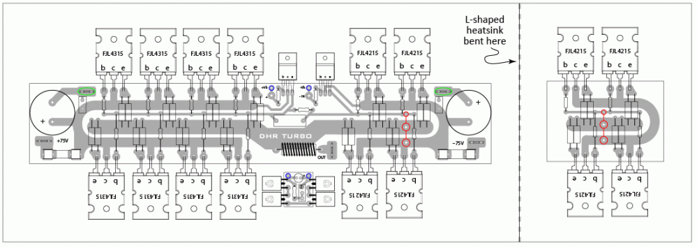

Hey Charlie,
I just thought I would show you my new PCB drawings for replacing the original Bryston 4B amplifier boards with your DHR Turbo. Just the output boards designed so far.
Do you think this idea is crazy?

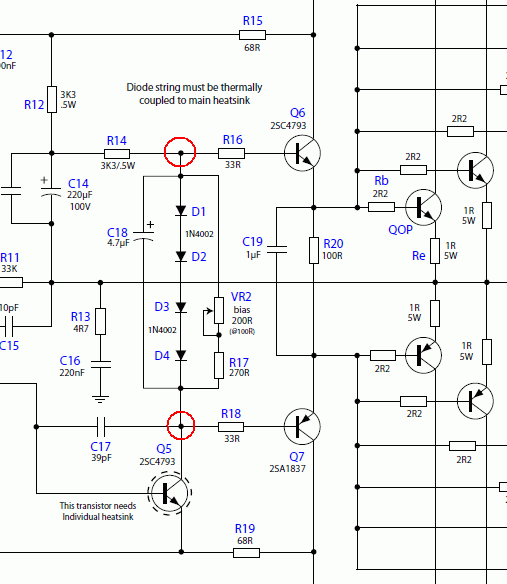

Is this place in the circuit a good spot to connect the 2 boards? The amplifier Diff-amp/VAS sections will be on a smaller board mounted above the output board, on taller stand-offs.
I don't know dear Todd as i have never done this way before
I suppose you will not have problems because sensitivity is not big into the output...so, your wire may not crease problems..but i cannot guarantee as this was not tested... voltage gain is 1..but current gain is reasonable there (more than 2500)... driver plus power output transistors are only power amplifier, not voltage amplifier.... it amplifies current only... voltage that enters comes from the Voltage Amplifier Stage (VAS) and the output add current only.
The idea is good, the layout is excelent, but what more can i say?
I do not know... this is the reality... i wish you a good luck with your nice idea..... i wish the Saint of Audiophilic spirits bless you.
Finishing your construction and poweringn the unit..... will be a good idea to place an AC voltmeter into the output to measure possible oscilations during stand by mode.... also, some inspection while operating with music and monitoring using a scope may be interesting to see if you have oscilations triggered by the signal.
This nice idea you have is something that made my bones shake ... i would be scared doing that... you are really a courageous man.
regards,
Carlos
regards,
Carlos
Well, it will take a lot of work modifying the Bryston Chassis before it will accept "foreign" PCBs without its immune system attacking. Those Bryston antibodies are strong. But if the chassis cooperates I will certainly attempt this amplifier. I have 3 of these chassis to retrofit.
I am worried about short-circuit protection. One little speaker wire accident and POOF, half of Korea goes up in smoke.
I wonder if Leach style protection circuit will work here. hmm... (one day later perhaps)
..Todd
..Todd

I got these three Bryston 4B amplifiers for free from the concert sound company I worked for 20 years ago. I don't need powerholic watts, but each chassis has 2x 104VCT 500VA transformers. So 72+ volts per rail in stereo. I wanted the heatsinks and cases for projects, and I will accept the big transformers and suffer with them.
My back hurts when I think about those days of trucking around racks full of Bryston 4B amps. 300 shows a year. Those were the days. No wonder my back is 'a bit fragile' now.
..Todd
And you're also right about me not caring about that. Let the teenagers have their 2000 watt amplifiers. Let them buy speakers that "put out" 2000 watts, it's their money. We can smile, they can smile, everybody is happy.
..Todd

Good questions. The $.25 history of Bryston . They are a Canadian amplifier company. They started by producing pro-sound amplifiers for concerts (model 3B and 4B for example), then realized audiophiles will pay $$$$$ for their amps, so they added more shiny aluminum, and improved the sonics (3B-SST and 4B-SST etc, currently) and raised their prices so that only audiophiles will buy them, not sound companies.
For circuitry, they are most 'famous' for their "krill-like" output section. (Combination of CF and EF) I don't know what name it has.
For sonics, I don't know. I have to compare. The popular opinion is that the old 4B model like mine sounds terrible, but they were the "STANDARD" in every recording studio I ever worked in.
That is why my curiosity. I will build a DHR Turbo version, and a Quasi version, and listen to all three and decide myself. To me their value is only as a DIY hobby learning tool. Curiosity.

No one has asked about this small heatsink?
Interesting that.
This heatsink holds maximum or 200 watts amplifier....so.... the idea is to limit the output power to this level.
How?
Installing resistances in series with the rails....this will force voltage drop that will limit the output power to the level i want.
The more interesting thing is into "pianissimo" musical moments, the supply will have its electrolitic condensers fully charged..and voltage will be 60 plus 60 volts.... this will give a nice peak of power... a interesting dinamics will appear...i have tested and was nice the result....but needs a lot of condensers to do that.
As this amplifier will go to my dear daugther..and she is powerholic..i will keep those resistances in series (panel switch) to her use.....and i will be able to produce a short into those resistances...a bypass, that will make the power supply very strong once again.
Two fan blowers will be helping..one into the back panel and another sending air to the heatsink fins.... over the heatsink there are vent holes, also under the heatsinks...so.... we gonna have the needed dissipation as music is average.
I have not invented nothing folks...NAD has used that....lamps in series with the supply...automobile lamps..... the idea is interesting...limits the power and give you some dinamics..some peak response.
