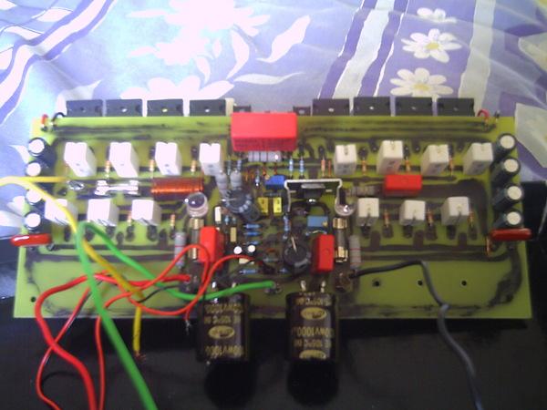

you know when you just about almiost complete well in my case i just need to attach four 1n4002(changed my mind on thermal sensor why go complicated just go the easy route). and 2 t220 type transistors 1837 and the other one. Your board really starts to add alot of weight mine weighs alot for a circuit board hav to be careful when picking it up the transistors can move out of place from the circuit board i just press them back against the board.
now talking about heatsinks they are really expesnive especially the size i need. but i have seen aluminium square blocks 300mmx300mmx50 on ebay for resonable prices. dont wnat to turn the amp on till i got the heatsink other wise trans can burn out when amp powered on just taking precautions.
Will have lot of pictures of amp when i charge the camera so everyone can see it.
THANKS CARLOS FOR ANSWERING THE QUESTIONS I ASKED AND OTHERS MEMBERS I LEARNT ALOT.

Great Joka!...thank you by the picture
Nice... very nice.

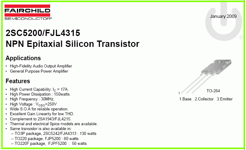

Hi Carlos,
My plan is to start building DX HR Turbo as soon as my new amp workshop (room) is finished in the next few weeks, and I move all my crap in.
A question for everyone/anyone...
As usual, I will be building this for a permanent amp, not a just a temporary project to disassemble later. I need to buy output transistors for it. I'll be running ~75v rails.
2SC5200/1943 are nicely priced, fast, but don't handle as much power.
MJ21194/93 have great SOA but are slower and almost twice the price.
MJL4281/4302 are very expensive, but fast and good SOA.
Sankens are expensive, but not readily available in Canada.
(Good, fast or cheap: pick any two.)
Am I missing any other reasonable options?
..Todd

No Todd... i think you have explored the main options we have
at least the most used and reliable ones.
I hope you decide for something having reasonable price and performance.
regards,
Carlos
There's another one....but do not remember the number.. J4215 and J4315 maybe are those the numbers.... they are a good option too... alike 2SC5200
will check this number latter and will send you the correct number if this one was wrong.
regards,
Carlos

Yes, thanks Carlos, I have that number: FJL4315. It's Fairchild's version of the 2SC5200 but uses TO264 instead of TO246. And cheaper. Maybe I will spend the extra money saved to add more pairs. 10 pairs for 75 volts?🙄
..Todd
