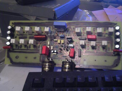

My dhr Turbo 90% percent complete
Just waiting for fuse and fuse holders and 2X220uf 100v caps and am done (already got the toshiba trans, diodes and the other stuff i solder them after completing the nitty bitty stuff).
then i connect 43ac to rectifer bridge (26mb60b) and connect after this two 6800uf 80 volts caps and then get up to 63vdc and connect straight to the dhr turbo. unfiortunately dnt have softstart.
of course got to check the pots and do the bias and offset adjust and then measure with multimeter for dc volatge and if ok connect speaker and connect input jack wire. no heat sink yet but try out for ten seconds to hear that sound as test then buy heatsink and erm start on the other channel.

couild i use spare 2sc5200 or 1943 trans instead of 1n4002 diodes as thermal tempertaure devices if not can anyone suggest me suitable thermal temper ture flat type diodes as the 1n4002 are not flat type and cannot be screwed to heat sink.
