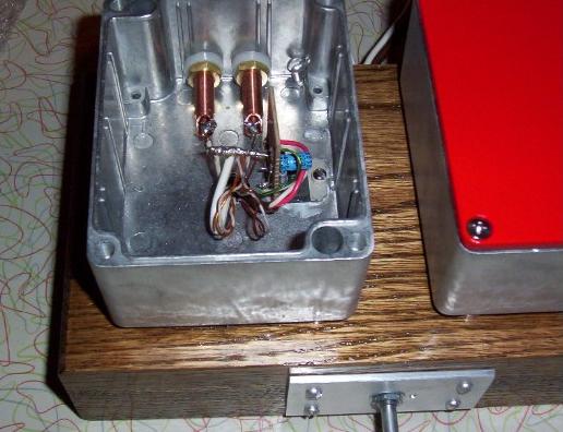

Is that block of wood hollowed out? If so, couldn't you have got the whole works in there with front and rear panel for sockets etc? Just a thought - you know what I'm like when I see a block of wood
It's made from 3 pieces of oak boards. I made it this way because I wanted lots of mass for a base and I had the wood lying around.
Yes, I can see now Vic - three layers. Still reckon you'd have a corker if you put the amp etc 'inside'! 😉
Funny you should say that. I, too was thinking of using marble or granite. In fact, I was looking at 12" X 12" tiles and thinking about cutting them. I have a diamond wet saw from one of my home improvement projects. But, I got anxious and decided to build it this way.
My next project will certainly use marble or granite firstly because of the mass to reduce microphonics and secondly because I just like stone!
BTW, the amp is actually in the two aluminum boxes. The input and pot are in between in the wood.

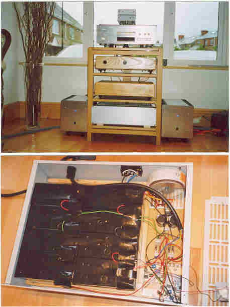

SLA batteries & caps
I tend to think of batteries as a great replacment for transformers & diodes but I do not think they are fast enough to replace the high quality electrolytic caps
batteries & 1uF gave a very smooth sound, quite pleasant, but once I put the electolytics in they was no question for me which was best.
I'm using DNM 10,000uf slit foil T network types. I have not compared these with black gate or panasonic etc 1000uf types.
If anyone out there has done this comparison I would be interested to hear what your conclusions are.

What charger are you using and having 8 batteries, is it complicated to switch it between them when charging?
