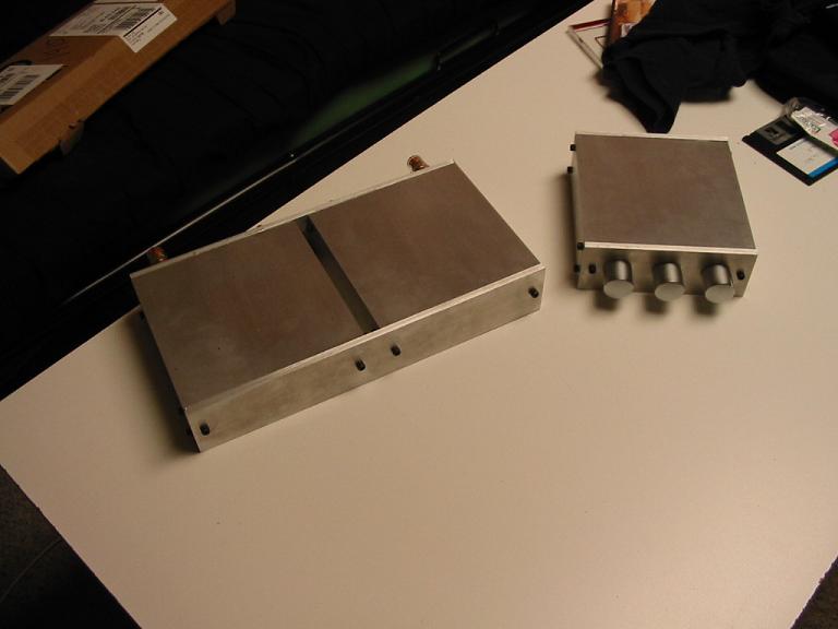

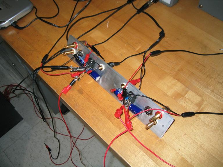

my gainclone!
Just thought I would post a picture of my gainclone. It uses Peter's simplified circuit, although I'm considering changing the 4.7uf with 22uf. Has anyone else tried this? I also have not received my transformer yet so I have it running on lab power supplies in this picture. In the next picture are the complete chassis of the control and amp. When the trafo gets here I can complete the chassis for it.
