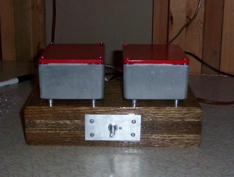

I just finished both channels of my amp. I used the schematic as posted on the amp chip forum. I left out the .22 Ohm resistor at the output. I don't have my power supply finished so what I am using in the meantime is two 12 volt 3A AC-DC convertors in serial with ground centered in between. I don't know why people bash the bass. Even with this setup the bass is quite well controlled although it falls apart higher demands. I suppose that once I get a decent power supply made (battery) things will improve subtantially. The mids and highs are very clear and neutral. My speakers are homemade Audax two-ways which are neutral. Sorry, no pics yet but I will post some ASAP. Overall, I must say that I am quite pleased.

This is a general pledge to those who have made nice cases*: please mention something about how you dit it, if there was any unusual techniqes/methods involved, please share!
* As for you vic, we'll see from the pictures whether you are included in that group 😉
vic said:Sorry, no pics yet but I will post some ASAP. Overall, I must say that I am quite pleased.
Your wish is my command. Please click HERE .
