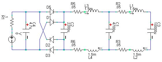

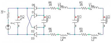

I had a battery supply lm3875 based balanced wkg system and I built a friend similar setup, mains powered, using lm1875's.
I used smallish low voltage transformers as chokes and ended up with the following which seemed to sound about the same as the batteries. ( the batteries had just the 10,000uF across them ). The 10,000uF in both cases are T network caps and the others are DNM slit foil so there is some serious filtration happening in the mains cct !
The 4.7uF across the TR secondary really improved the sound but with my newfound knowledge of snubber ccts ( after reading & spice simulation ) I would put 1uF in paralell with 4.7uF in series with 10ohms. This might mean I could get away with less inductors!

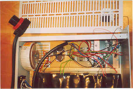

Peter Daniel said:What charger are you using and having 8 batteries, is it complicated to switch it between them when charging?
Here is a better detail of the charging circuit which is a current limiter lm317/337 followed by a voltage reg lm317/337 x 4 so that I charge each two bat in series at 27.6v.When I want to charge them I just switch the circuit on from the power switch at the back.The gc has two 3pdt switches to switch the dual mono rails and ground from battery to ac.You can also see the connector I use which is a heavy duty 8-way speaker type connector.I was ucomfortable using the more popular xlr type first of all because they are usually not more than a couple of amps rated and secondly they donot allow a thick 6 conductor cable to be attached easily.And of course I use fuses on the output of the batteries.I was very scared working with this circuit since the batteries are always "on".

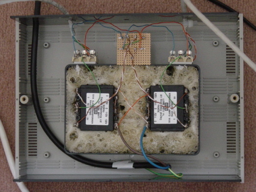

simple battery charger
Well this my simple battery charger.
One of the transformers was buzzing so I put the two of them in a box, filled up all the spare space with small graded stones and poured in polyeurathane resin. The bubbles were caused by some residual moisture on the stones !!!
now it works completely silently, stays nice and cool and get the batteries up to about 13.3V🙂
