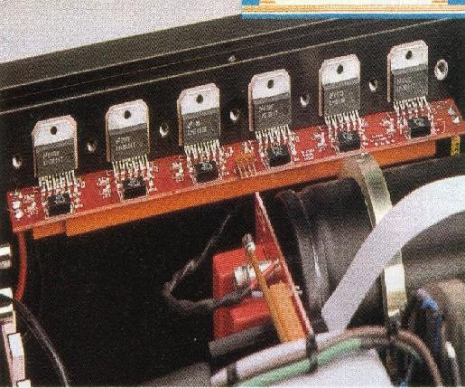

Wow, looks like the paralled and bridged configuration right out of the national application note - without servos - unless those are teeny op amps near the device pins.
Hmm...
I was contemplating paralleling 4 of these biased at 300 mA each for a ten watt class A special.
