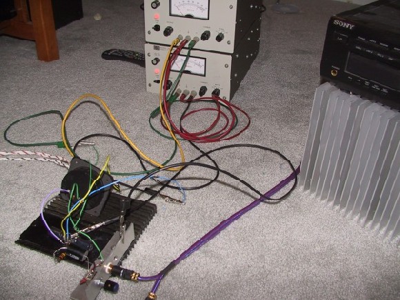

This chip amp stuff is just too easy not to try.
So Brian and I went ahead and threw together our own gainclone (single channel inverted lm3875). The initial impression was that it was a bit harsh, but otherwise pretty good for the invested money, parts, and time. Of course, this wasn't ideal conditions.. Mono, no shielding, and no burn in. As for configuration, we left out the output resistor, scrapped the rail to rail cap, and tied the positive input directly to ground. The power supply is a pair of HP bench power supplies (on loan from Georgia Tech).
So how long do these chips take to burn in? I don't think it would do much good to test different configurations until after burn in, right?
The next step is to finsih another one (yay for stereo) , and replace the bench supply with a transformer.
If you can trust Stereophile, at least 3 weeks.

Jordan is getting to be more ambitious them me now with these gainclones. He working on a pair of channels now, after powering up my first channel. He is using Riken resistors and Auricaps, so we will do a comparison of the two setups once they are done.
We will also try a broad range of power supply voltages with the power supplies, before deciding on the desired voltage for the transformers.
Regarding the power supply, would it be better to use 4 bridge rectifiers for 2 channels and keep 4 pairs of primaries from the transformer, or keep it to 2 pairs of primaries and 2 bridge rectifiers? I would assume 4 bridges is better, but one gaincard reviewer said that one power humpty sounded better then 2 power humptys... Anyone have any suggestions? I would like to keep it to one transformer, and don't mind spending a bit more to get 4 pairs of secondaries instead of 2.
