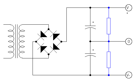

Isn't it possible to take a single winding and make it look like a +/- supply? Something like the diagram below (i don't know whether the resistors in blue are required).

The resistors are generally necessary to insure that the voltage divides equally between the capacitors. This sort of thing works fine for low current loads like op-amps, but I think you'll have problems if you try to run a power amp off this, unless you use very small resistors which will then burn a lot of power.
You also have to be careful what you connect to this "0V" point. If it goes to the chassis, and the chassis connects to the power system ground through the line cord (or through the shield of a cable that connects to AC power ground in another box), you could have big problems.
