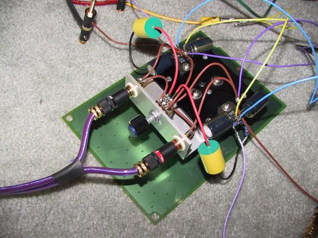

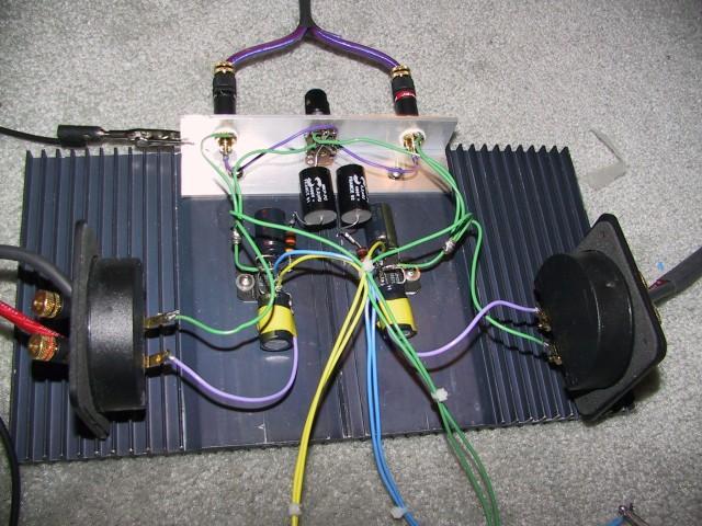

Jordan finished his first gainclone, his first amplifier. He used higher quality components then I did, Auricaps and Riken resistors.
My 2 channel is basically done, and we will run comparisons over mine with Allen Bradley resistors and Solen input caps. Besides these 2 components, the only difference is the heatsinks.
first picture of Jordan, after discovering that it works:
Brian
Brian
Brian,
You might try it without Solen caps. But check DC offset before. Removing Solens should bring substantial improvement.😉
Won't that mean the amp would be more prone to oscillations?Peter Daniel said:Removing Solens should bring substantial improvement.😉
--Jordan
Not necessarily. In my acrylic amp, which doesn't have much shielding, after removing caps I had much less oscillations. The big caps were peaking some radio frequency noise.
Peter Daniel said:Not necessarily. In my acrylic amp, which doesn't have much shielding, after removing caps I had much less oscillations. The big caps were peaking some radio frequency noise.
We tried bypassing the solen caps, and the dc offset didn't seem to change at all. I didn't have time to do much listening, but after 5 minutes of switching back and forth several times, it does seem to see less harsh with the caps bypassed.
Is there any disadvantage to removing the caps? One funny thing, for the bypass, we initially used a 3ft long banana plug wire with alligator clips, and when you hooked up one side, there was a quite audible radio signal playing on the speakers. With both wires connected, there was a barely audible signal. By changing it to a 1.5" bypass cable with alligator clips, the radio signal was gone when both sides were connected, bypassing the input cap. I don't know what kind of radio signal. It was advertising for Hair club for men. I would assume that it was AM radio or something.
Thanks for the suggestion. I definately will do more playing around with the gainclone for parts. I have some dale rn55 resistors that I will try next for the feedback resistor. I also want to try skinning my caps, once I get used to the sound, and see what difference it provides. The commercial product has naked caps.

None of my amps was ever guarded against DC, I just take my chances.
I used inverted version with most parts gone, so I'm using only 2 resistors (10k for series input and 220k for feedback). Positive input is connected directly to the ground with 20mV of DC. 100k pot at the input.
By big caps I meant 2 x 1.5u from Hovland. Normally I would be using 4.7u N BG but I wanted to try film caps. My amp is shown at the thread's beginning. Because it was an open concept without much shielding the big caps were prone to picking up all sort of noise.
