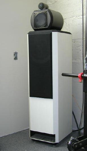

hey peter can you post a pic of your speakers from the rear
The rear looks like the front, just no drivers. I also have a rear tweeter installed there. It seemed to be a trendy thing few years ago, but I don't see it being done now.

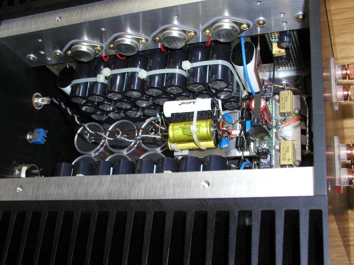

Here's how I mounted caps. I paralleled Silvertone silver foil with Jensen copper foil (paper in oil type) for positive side and Silvertone with MIT RTX for negative side. I didn't have enough of Jensen caps. Although people say good things about those Jensens, I'm not totally satisfied, they seem to be heavy sounding with not too much detail and all voices sound kinda low. If I wouldn't parallel with siver cap (which BTW is great)< I wouldn't use Jensen at all.

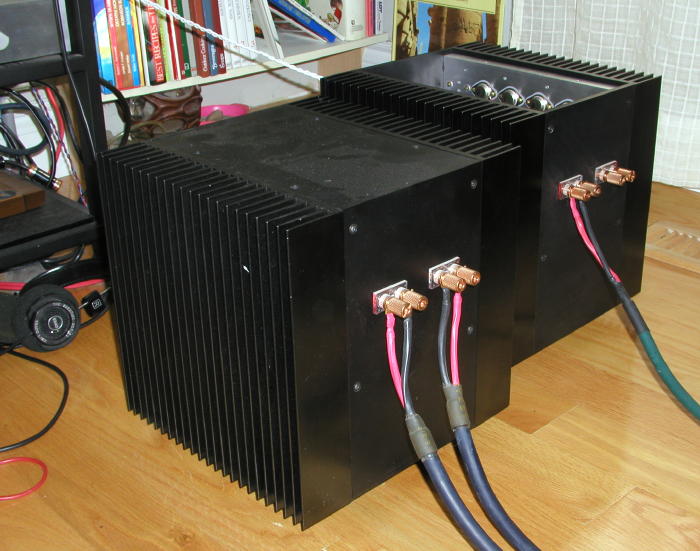

And here are the amps. Most of you've seen those chassis before, yet, they deserve their spot in this thread. I find this type of chassis design very attractive both visualy and practically. Normally I stack them one on top of the other. And the inspiration comes from original Alephs. Thank you again Mr. Pass for all your contributions to DIY Audio world.![up :up: :up:](https://files.diyaudio.com/forums/images/smilies/up.gif)

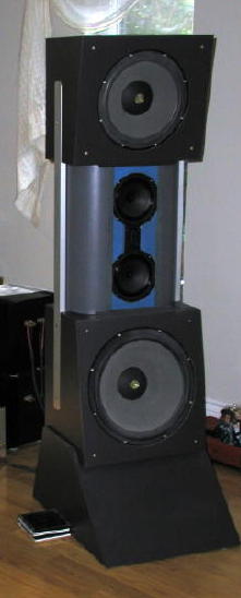

I'm using 2 amps per channel. What you see here is one channel. Bottom amp is Aleph X and it feeds tweet and mids. Top one is A75 used for subs. I have two (12" and 15"), that's why two cables.

As for the large speakers, what do you crossover the 12" and 15" at? They are quite interesting looking.
