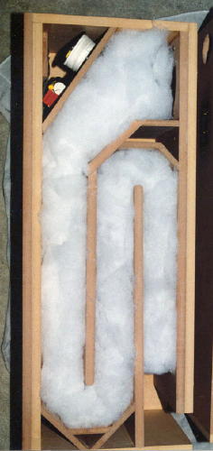

Peter Daniel said:I'm using original B&W tweeter, Accuton ceramic midrange and Cabbase 8" woofer in transmission line design.
