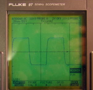

And here's at 10K. The -3db response occures at 70kHz. This might be caused by high input impedance which is 78K in my case. Feedback resistor is 220k. Compensation caps in feedback loop are required, otherwise square wave shows ringing (if it's correct expression😉 ). I'm using 10p silver mica. Sinewave looks OK with or without caps.

BTW, you may like to try a slightly smaller cap at the feedback to get an almost perfect sq wave at 1KHz, say 6 or 8 pf, I know you haven't even started to tweek this baby, but just an idea.
You are right, I put 2 x 10p in series and it looks almost perfect. Also with a cap the high frequency noise is gone. But I didn't had that noise with Aleph 5 which is still caps free.😉

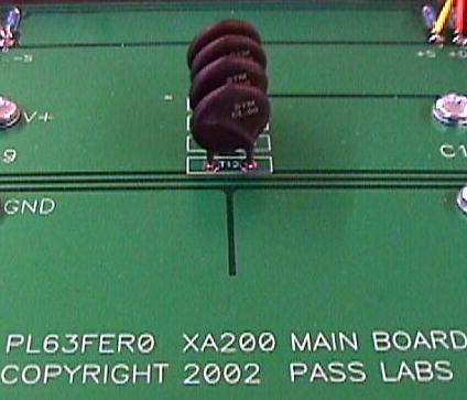

On noise and startup oscillations I would try to replace the Thermistors at the Pi filter in your PSU, even though I have never tested thermistors in that position my impresion is that they are not very stable as resistors and they mey wonder in resistance at certain intermidiate temps. IMO a good wire wound of say 0.8 or 1 Ohm of 20 or more W (or combination of) is the most desirable resistor in that position. And you will still retain the inrush current control you are seeking. 😎

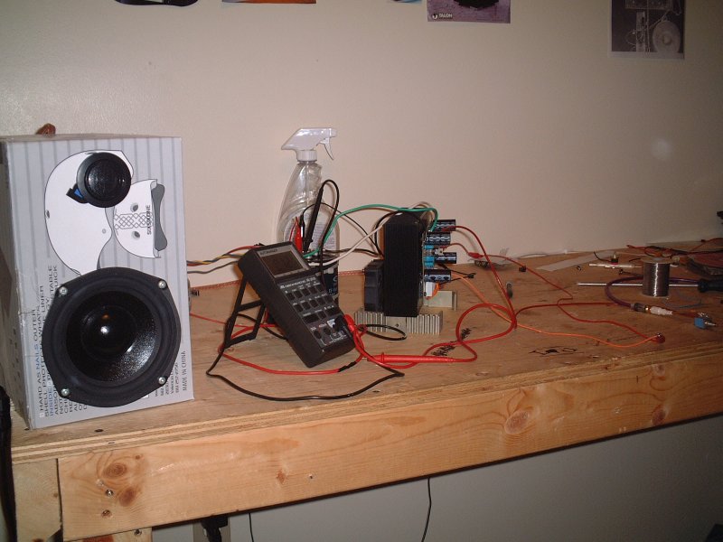

Here's my tonight's setup.😉 It's only temporary, till I install proper drivers in this dividing wall. The other room, which is my workshop, will make the drivers enclosure.😉
So here's what I'm listening on to the amps. First thing that comes to mind is how effortlessly the amps present the music. They seem not to have the character of their own. The highs are smooth and silky, the midrange very natural and detailed, bass full of authority and well defind (and I'm not full of BS, BTW 😉). I think those amps bring the listener closer to the music that my other Alephs. As I said, it's almost like a curtain is removed. Still the real comparison would be done when I placed them in my main system which I am more familiar with.

More to the point of thermistors as an R in an CRC Pi filter.
At power-up the thermistor will get hot and the resistance will drop quite steeply but as soon as the caps are filled the temp will start to lower to the regular duty and so the resistance will start to creep up, I guess in not a very ordely way and may be with a lot of noise. Moreover, I think that thermistors will differ quite a lot from sample to sample from its temp/resistance caracteristics so you may find that your + and - rail behave differently. I guess this is the last thing one may want to have on an AX.
I dont know who, but someone posted a link to KC00X thermistors spec sheet in this or other thread, you may want to check the tolerances for this devices.
Also, NP indicated that on some of Pass Labs X power amps he uses CRC filters on PSU, I guess the R stands for a resistor since he did not mention using a Thermistor.
