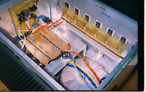

Peter,
I was looking at some of the Aleph-X pictures that you posted on this thread and I noticed that the weight of the whole amp is basically supported by the 4 stand-off that are located right below the transformer. Could you explain why you did it that way?
Edit: But then again I don't see any feet under the bottom plate or is there? If no feet, then I would say the weight of the amp is supported by the heatsink.
The weight is indeed supported by those 4 standoffs. Under the standoffs, there is a bottom plate and 4 feet. The same screws attach the plate and feet to the standoffs. Actually, it's the mid-plate that supports most of the amp: transformer, PS caps, heatsinks, front-end board. Everything is attached to this plate and the plate itself rests on those standoffs.
I did it that way, because I like simplicity. Taking in consideration that the standoffs are 1/2" brass, I don't thing it's too much weigh for them to support.😉 Also the plate makes the whole assembly more rigit, comparing to standoffs alone.
