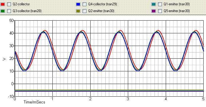

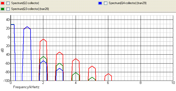

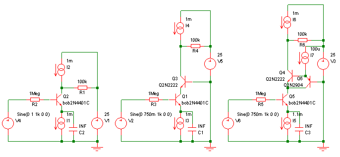

I just spent a while fiddling around with this. As long as the common-emitter stage was driven from a low source impedance, I couldn't see any improvement with cascoding either. I guess the Vbe non-linearity dominates the distortion, masking the other distortions that cascoding can reduce.
However, with a high source impedance, there is a dramatic improvement with cascoding. This is representative e.g. of a VAS transistor driven from the input stage via a current mirror. Here's a couple of circuits with the results to give an idea.
Warning: I used perfect current sources and infinite capacitors to get the biasing to sort itself out, so the emitter of the first transistor is at about -5V.
Cheers - Godfrey
p.s. Oops, just realised I forgot to change the cascode transistors to Bob's models. Too bad.
Godfrey, your results match my experiments. So it seems an amp is unlikely to benefit from cascoding unless it is very sensitive to the Ib of the VAS. This may be bad news for FET VAS. Either way, results are highly variable, mileage will vary, so it's worth testing in many given circuits. One important improvement is the increase in speed, especially for the hawksford/baxandall variations, but you can shoot your foot here too.
SWF, I greatly encourage you to use real transistors for this, better than simulation in this case. It would be of great edification to many of us!

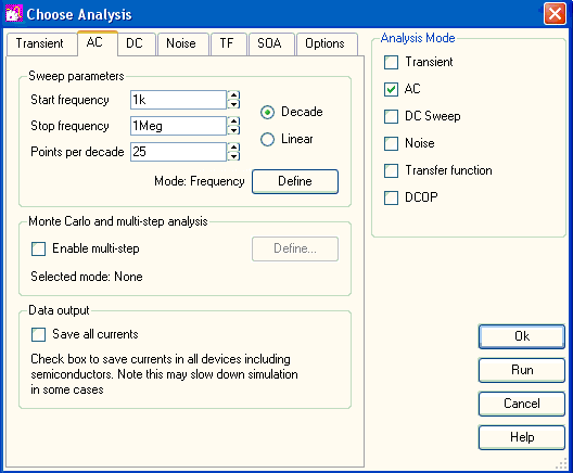

frequency sweep
[help=]%[/help]
I want to sweep the input over a frequency range.
What is the statement for AC1?
This is what the help page shows. I don't understand what it is telling me.
[help=]%[/help]

I have no idea. The most important thing I learned about LTSpice is that there are alternatives which work as well, but are easier to use. Here's what SIMetrix looks like.[help=]%[/help]
Seriously; what was anybody thinking when they designed the LTSpice user interface?😱
[help=]%[/help]
you specify the frequency range on the .AC statement - start, end, and number of points per octave or decade. Or in LTspice with the Edit Simulation Command dialog box.
example .AC dec 100 1 10e6
does an AC analysis from 1 to 1MHz with 100 points/decade.
