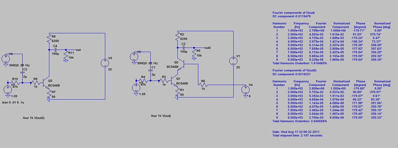

I am trying to sim a simple common source fet cascode in LT spice. No matter what I do, I always get increased distortion with a cascode when compared to a non cascoded circuit.
Am I doing something wrong, or could this possibly be because the models don't properly account for changes in gain and input capacitance with current, voltage and frequency? If this were the case, a cascode would model worse than a non cascoded circuit as it is the influence of exactly these things that a cascode reduces.
Have you been able to successfully model a cascode in lt spice?
I am trying to model a cascode using two irfp240s and a resistive load as a proof of concept. I have a 80v rail voltage and the cascode voltage is 15v. So far distortion of the cascoded circuit is always about double the distortion of the simple common source amplifier. I have no idea why. Even if I use BJTs I get a similar result.

Kean, here is an example I whipped up using the included models in LT spice. It does not matter whether I use BJTs or Fets, or what my cascode voltage is. I can not get cascodes to sim better, full stop. Either I am doing something wrong or the models do not account for miller effects, etc. Help!

First of all, LTSpice compresses the output data by default, and this will destroy any distortion measurements. To turn this off, add this line:
.options plotwinsize=0
Now try again. Hmm, maybe you just forgot about this?
After that, try deleting the 1k base resistors; these will add distortion to your circuit in ways that may be misleading if you do not understand well what effect they have.
Finally, you could very understandably delete all of the default LTSpice models (which are copies of vendor models anyways and just as bad) except perhaps the MPSA18 and 2N4124/4126 (very good transistors), and just use the models from Cordell's website, which are guaranteed to model accurately. Cordell has BC550/560 models which are basically equivalent to your BC546, just with less Hfe (which can be altered in Cordell's models and still probably do better than the LTSpice defaults).
