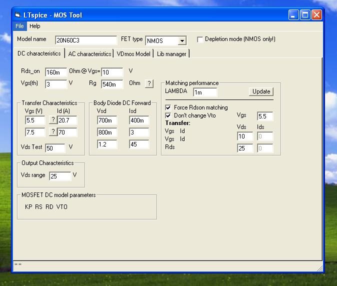

MOSFET model generator LTspice
This came about a few years ago but I'm not certain it has been brought up here.
"Hello,
Anyone who is interrested to make there own power mosfet model for
spice can now easily do this with a tool i made.
It's a windows application and can be found on the yahoo groups
LTspice.
The programs needs dot net framework 2.0 to be installed on your
computer in order let it run.
Features:
1 Datasheet information of the mosfet to be modeled is entered in the
program.
2 This data can be saved for later use.
3 The model created is a .model statement which only will work in
LTspice because it makes use of the VDmos device in LTspice not
pressent in any other spice.
4 The program has a library manager to keep all your models in one .lib
file.
The model generated by the program matches the datasheet ouput graph,
transfer graph and all the capacitances of the device. Especialy the
nonlinear gate drain capacitor which is the power of VDmos model in
LTspice.
It now allso includes the reverse recovery of the body diode. (only
basicly because the spice diode only covers the storage time)
Best regards,
Hendrik Jan Zwerver"
I tried this out, it works. BTW why does SPICE not have it's own forum category here at DIYAUDIO? Weird in these times, don't ya think?
Carry on...

Hey, that's nice.
With this we could devote a page to MOSFET modeling. We could in fact make models for all the most common devices.
I edited in the information in my last post (quite some time ago actually), but something happened and it never got saved (on my end).

MOS Tool
For MOS Tool to work on a PC, you gotta load Microsoft's "dot frame Network" software. I think there is a better way around this but that would include the author writing alot more code. Mos Tool uses the Bill Gates stuff to work from.
Also, I still had errors running MOS Tool even after the dot frame stuff was loaded and running. 😕 There were still some dll and ocx files missing and in need of registration. When that stuff starts up, I figure folks will back away but with some minor tinkering it all gets settled.
I used the older version of dot frame network...version 2 without service pack. Perhaps if you download the latest and greatest version from Microsoft's site, then perhaps the dll and ocx files don't give hassle?
If you take it on and start messing with those dll and ocx files in your win32 folder, be careful. A clean registry is required or it can bring you down.

Also regarding Mos Tool
The specifications required to build an accurate Mosfet Model in this program do not usualy exist in data sheets of "audio grade" mosfets. Some of the data can be derived and some will be left open for interpretation. As always simulators simulate; they put out what you put in...really...kind of🙄
My favourite use of this tool was building "
