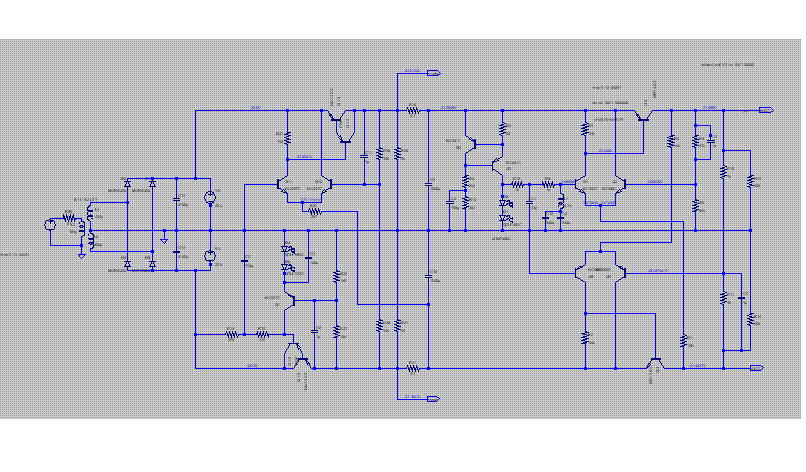

You can right-click on the .model text and select "not visible". That will get it out of the way. It will be back next time you open the schematic though.
There are many reasons a .model statement may not work. Go to view->Error log and tell us what it says, or whatever error message you were given.

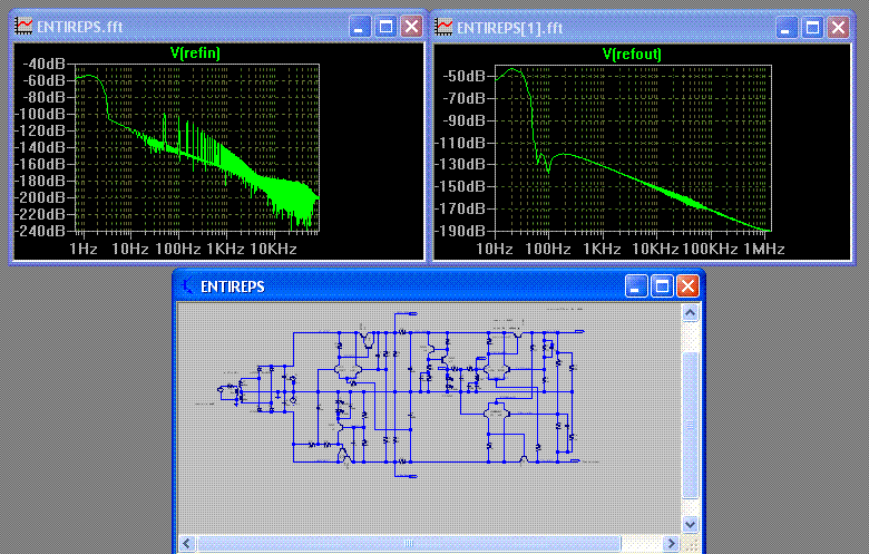

Putting the spice models as directives works, but now I am trying to get the entire power supply to work.
I have already simulated its separate parts and get around the expected -120db. ripple, when I try to put the whole thing together I get anomalous results, in this one I get far more ripple at the output than at the pre-regulator.
Putting those two d.c. sources there works for d.c. operating point but not transient.

I can't tell what's wrong based on just the image. Posting the .asc file along with the image is the quickest way to success.
This is the version of it that I hung the transformer and two d.c. power supplies off. I was trying to get the d.c. operating point and then the transient output, but it seems this scheme does not work. I you could show me how to model this correctly I would be most grateful.

Change K1 to 'K1 L2 L3 L4 1' and rotate L3 (not strictly needed).
For the input transformer you have L2, L3 and L4, but your K statement uses L1, L2 and L3. Somehow L1 got into your voltage reference which is why your output voltage is going nuts. L4 should be in your voltage reference and shouldn't be in any K statement.
4.7mH in series with the reference filter makes a series resonator, and blocks filtering except at the resonant frequency. It seems like a mistake?
transformer K shouldn't be 1 it is always strictly less than 1 .999 is fine though
power xfmr have many H Lm - not uH
there are also bias and startup problems - you can't often power your Vref from your regulated supply without some other current path - sometimes provided by real world parasitics - but it is bad practice to rely on such - plan how to get required starting currents

I would leave the trafo K at 1. Otherwise, it will have leakage inductance which will resonate with the rectifiers and cause unwanted effects in the simulation. If the intent was to simulate and design a rectifier, then yes I'd adjust K to give the correct leakage inductance.
In some regulators the pass transistor turns on immediately and in others it must wait for the small-signal circuitry to turn on. In the first case you can power your reference from the regulator output. This is an extremely tricky part of regulator design.

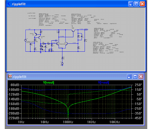

The 4.7mH. choke and the two capacitors are a notch filter, the components before them a low pass filter.
The capacitor across the top resistor of the feedback divider gives the whole thing unity gain for ac down to around 50Hz.
Since this is essentially a lead compensation capacitor the overall regulator has a very good phase margin, frequency response bellow.

The ccs has no bootstrap.
Because the input is from the inverting follower in the pre-regulator there is a lot of phase cancellation of the ripple, and as you can see from the trace, at the output of the ccs the ripple is more than 100db. down, the second trace, after the filter, does not register any Fourier spectrum.
The ripple reduction is overall dependent upon the gain of the error amplifier, and since this is intended to power a headphone amp it is already overkill.

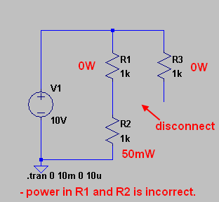

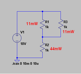

Referring to the attached asc file:
1) Make the wire connection to the collector so that the diode and LED are across the L1 inductor.
2) Run the sim
3) Place a power probe on Q1.
4) Do a ctl-right-click to get the average power in Q1, and note the value.
5) Break the connection on the anode side of D1 so that it is no longer connected to the collector of Q1.
6) Re-run the sim.
7) Do a ctl-right-click to get the average power in Q1, and note the value.
8) Delete the trace in the wave form window.
9) Place a power probe on Q1 again.
10) Do a ctl-right-click to get the average power in Q1, and note the value.
At this point you should see that the average power for Q1 changed to the correct value.
Test1: With the connection made to the collector, the correct average power in each is:
PRL = 109.93mW
PQ1 = 16.44mW
Test2: With the connection removed (as shown) to the collector, the correct average power in each is:
PRL = 105.26mW
PQ1 = 385.23mW
The problem occurs if after the Test1 measurement you remove the connection then re-run the sim and re-examine the average powers, the outcome will be as follows:
PRL = 105.26mW
PQ1 = 15.93mW (this is in error as it should be 385.23mW)
In order to get the correct average power for Q1, you have to first remove the power probes, then re-apply them again. Once done, then the average PQ1 power reads correctly.
Also try the simple example as per the attached diagrams:
Take for example the simple circuit I have attached pictures for. I have conducted 2 tests as before. In this case when the lower leg of R3 is disconnected and the sim re-run, both R1 and R2 power dissipations come out incorrect! (Test1 = all_connected.png, Test2 = R3 disconnected.png, and after the restoration of probes = R3 disconnected_restored.png.)
Then simply by removing all 3 power probes, and replacing them (nothing else done), the power dissipation in all 3 resistors displays correctly.
