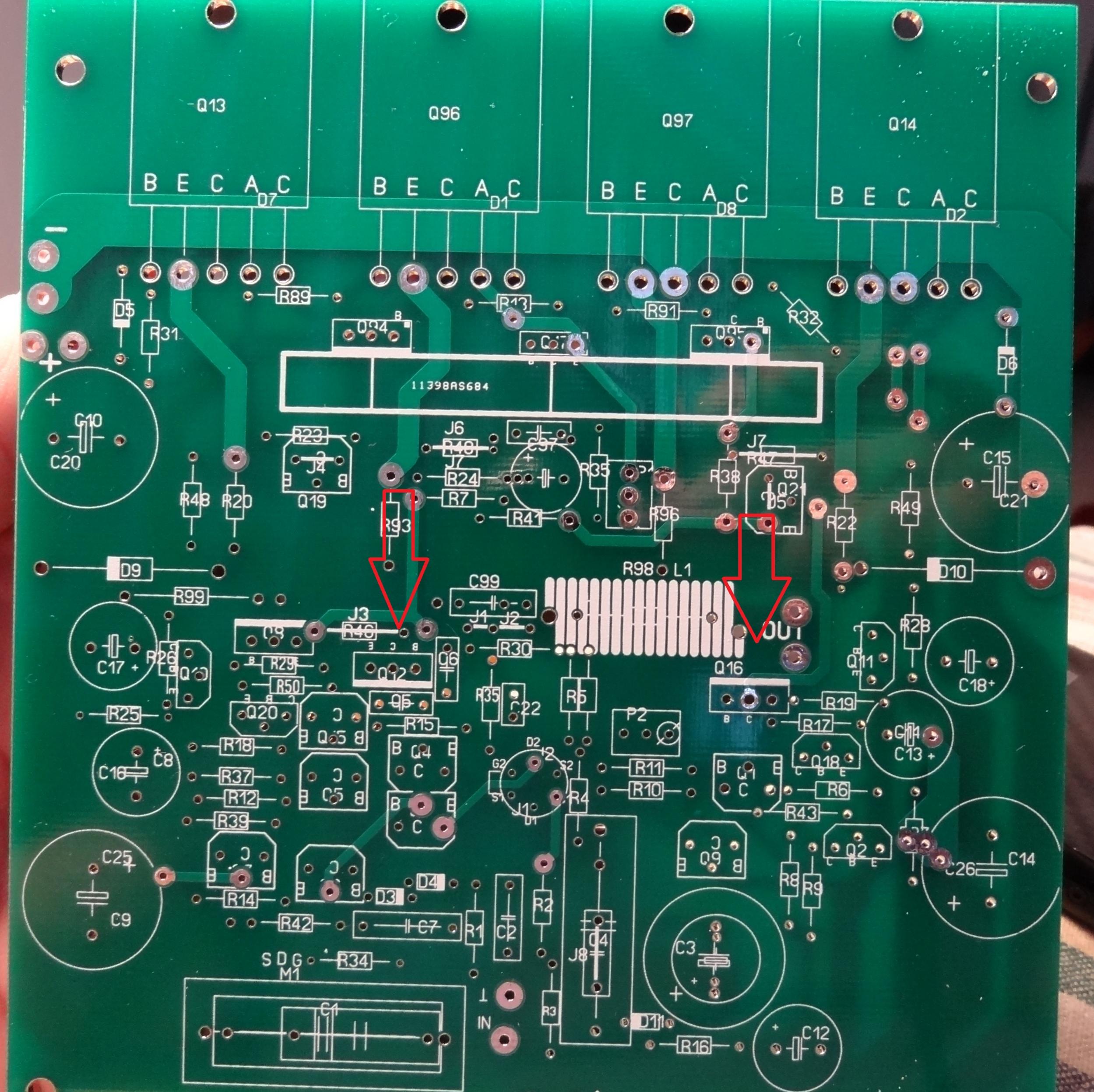

Hi Damir,
Yes I meant to say 11mA.
I don't quite understand where the jumper attaches. I see one extra hole but not the other. Are you saying to extend R42 to the + rail, bypassing the mosfet and change it to 15k? R34 would be out of circuit then, correct?
Thanks, Terry
Sorry, no jumper needed, just move R14 from the mosfet source to the next hole(+), and you don't need R34 in that case. Distortion would rise but insignificantly(in sim THD20 from 2.70 ppm to 2.73 ppm. Maybe you could ask why I complicated that part? I wanted best CCS to feed the LEDs and had the spare mosfets at the hand. In case with the mosfet that CCS current does not change with power supply sag under heavy load.
BR Damir

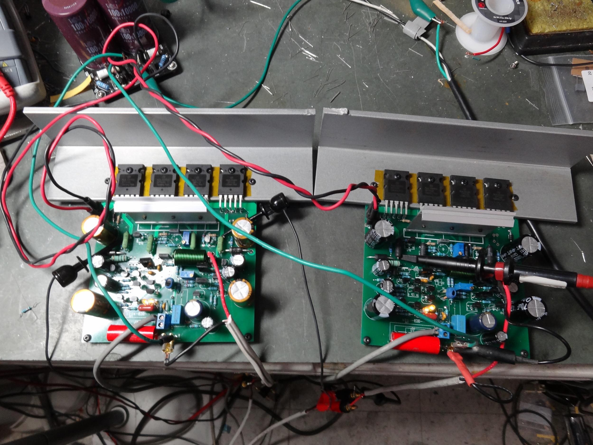

Hi Damir,
It's singing. I had a bit of a hunt initially because it wouldn't fire up properly. After some measurements and careful inspection I discovered that the indications for the TO-126 transistors have the pinout for a TO-220. The pin designations are correct but character shows the heatsink on the wrong side. This affected Q8 and Q12. Once I spun them around all is good. I'm only pointing this out for others who may build this using these boards. I ran some sine waves and square waves and everything looks good. Only a very slight sign of latching. Not worth worrying about at all. You were right earlier. The power supply I was testing with was sagging more than I realized. I hooked it up to a stiffer supply. Running +-48V at idle, the new supply only drops to +-46.5 at clip which is at 30vac into an 8R load. That's roughly 112W/8R. I don't have a 4R dummy load to test with. I have the bias set to 30V across a pair of the 0,15R emitter resistors which should be 100mA per device. Does this sound about right?
The amp sounds really, really good. Later today I will get it clamped to some good heatsinks and hook it up to my A/B setup and give it some comparisons to some of my other amps. It's very promising right now.
Blessings, Terry

OK, I clamped it to some heatsinks and have had it playing for about two hours at a pretty good volume. I had to bump up the bias two or three time before it would stay steady at 100mA. Some of this may be the drivers. They might benefit from a little bigger heatsink. I can just hold onto it. I have it hooked up to my A/B setup and compared it to a Honey Badger and a Peeceebee. It is very close to both. The Peeceebee is lower powered so at higher volume the TT leaves it behind. The HB is as powerful. They are pretty comparable. I won't hesitate to recommend this amp for someone who is looking to try something with Thermaltrak outputs. Very nice!
Blessings, Terry

Thank you Terry for your effort to evaluate this amp. About up side down of the Q8 and Q12 I forgot to mentioned that too.
If the amp is overcompensated (if the bias goes down after some heating ) try to increase R35 6k8 one step up. It looks that ONSEMI sometime used TT diode with different tempco in some production. Have you increased R37 from 1k to 6k8 or the latching is still good with 1k?

I think it is fine. It probably takes 30 minutes for the bias to settle so for that first 30 minutes the bias is a little high but not too much. There is only a hint of latching. A tiny spike at the tail of the upper flat spot. Not enough to worry about. I will never clip this amp. I suppose someone might if they run really low rails. The only reasons I clip it while testing is it gives me an idea how much power the amp puts out and it will sometime reveal an issue. Same thing with playijg square waves through it. They will kind of show you how the amp behaves but I don't think it has much bearing on how the amp will sound. We pump 100khz square waves though the amp and look at the scope. Most of us can't even hear 20khz, I know I can't. Mine is set up per the schematic. I think I will leave it right there. It sounds wonderful and behaves itself. What more could someone ask for.
Blessings, Terry

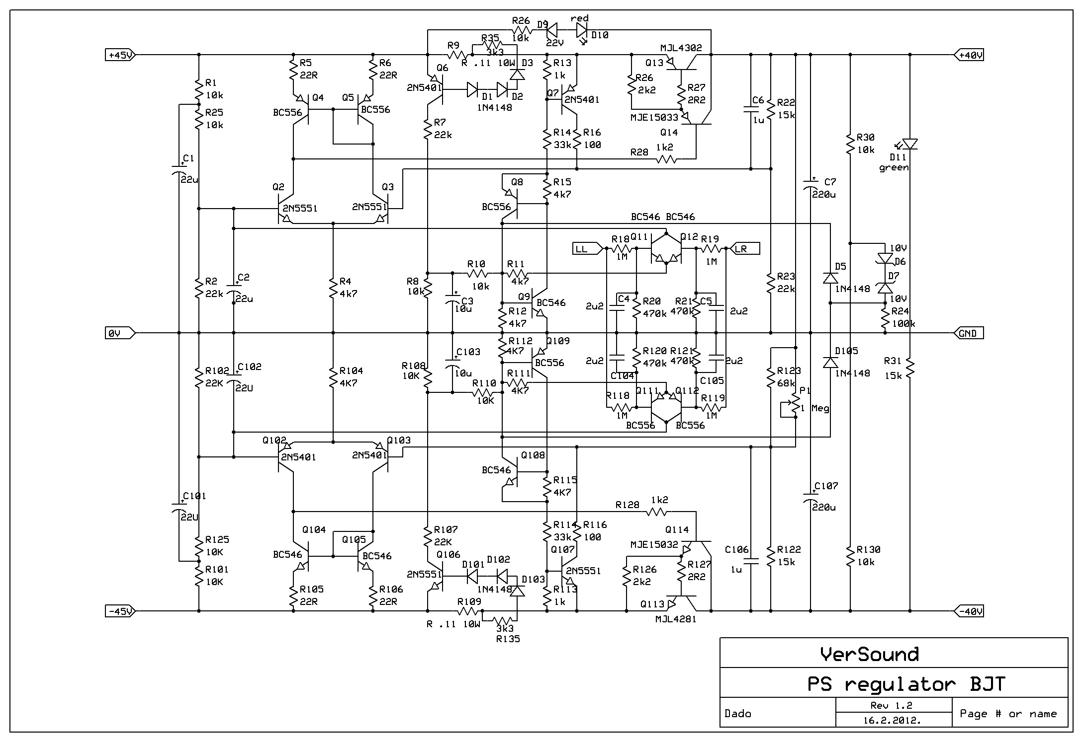

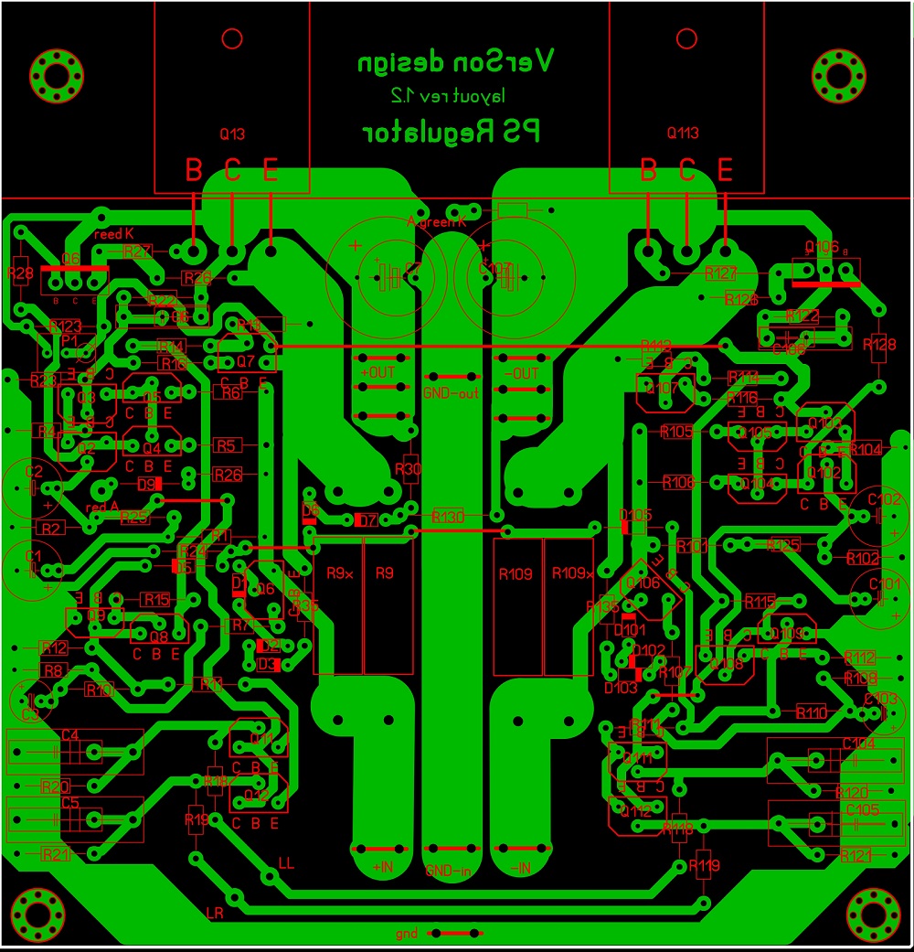

Hi Terry, I suggest you, again, to use my PS Regulator with this amp(or any other amp).
This regulator acts as a capacitance multiplier/regulator, current overload/short circuit protection and a loudspeaker DC offset protection. One PS Regulator board is enough for two TT amp channels, or it could be used two and make dual mono configuration, using one or two transformers. Probably one transformer version is cheaper and equally good and you need only one bank of big caps before the PS Regulators.
I can tell that I use TT amp together with this regulator for years now and a quiet amp became even quieter and more dynamic.
Here is the schematic, the layout and the gerbers.
BR Damir
