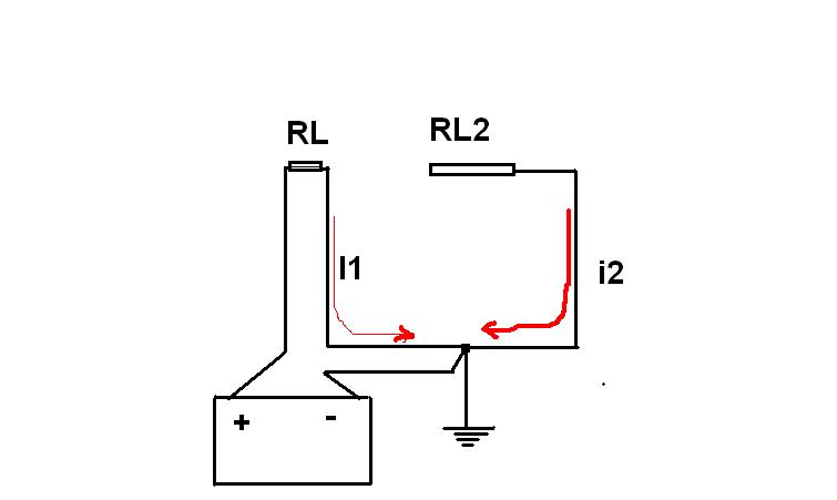

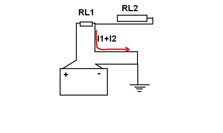

I understand how "lifting" the input ground isolates it from the "dirty" ground. I don't understand how there is any isolation achieved if both are attached to the same star. That is what I am struggling with.
I will try to explain this simple way.
Look at pictures ,option 1 & option 2.
Option 1 separate GND return
Option 2 common GND retturn.
The point that you are missing is that even though it is technically ground, there still is some minute resistance in the wires. Any load that is changing in current draw will impose that signal, a voltage (I*R), upon the finite resistance.
Although this signal is small, if it is amplified, it is both measurable by instruments and your ear using speakers.
Separating ground return paths (dirty/clean) with separate wires minimizes the effect.
A huge copper ground plane with minimal inductance and very low R, does the same thing too.

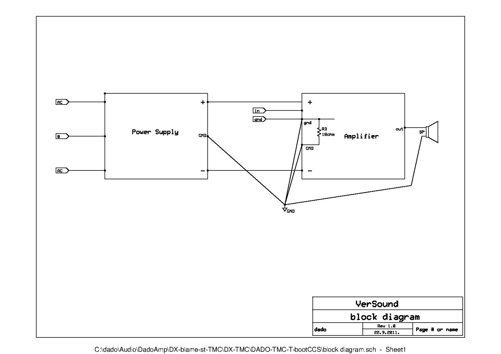

Why signal gnd need go to board (gnd) then couple with GND after ground lift resistor and then go to star ground? I'm looking for a reason but I think I didn't find any thing? Could you tell me the reason to connect that way?

Maintain rigorously twisted pair for EVERY Flow and Return current.
That is mains current, speaker current, signal current, etc.
Once you have done this, you will be left with telling each part of the amplifier what the signals are referenced to.
These voltage reference wires carry virtually no current, but can carry interference currents.
If possible run these voltage reference wires to your chosen location for the Main Audio Ground (MAG) along the route that their commensurate Flow current is likely to be flowing.
There are very few voltage reference wires in a Power Amplifier.
Signal Return at the front end of the amp, Speaker Return at the output end of the amp, Power ground in the middle of the amp (often this is already linked via the power triplet to the MAG)
In the diagrams with post395, 400 & 427 I can see that the twisted pairs rule has been broken.
As a result there are single wires emanating from various modules. This leads to confusion and duplication of wiring.
eg
The AC input wiring on the left should be close coupled.
The DC Power wiring in the middle should be close coupled triplet.
The spkr wire on the right should be a close coupled pair.
The last two will meet above the terminal with the 10r resistor.
In a Monoblock that terminal can be the MAG. or the speaker terminal can be nominated as MAG.
In a multichannel amplifier the MAG should be off board.
Now connect the spkr return to MAG
Connect the Signal Return to MAG.
other than Safety connections, the job is done.
If you sort the twisted pairs FIRST, the additional wires become SIMPLE and FEW.

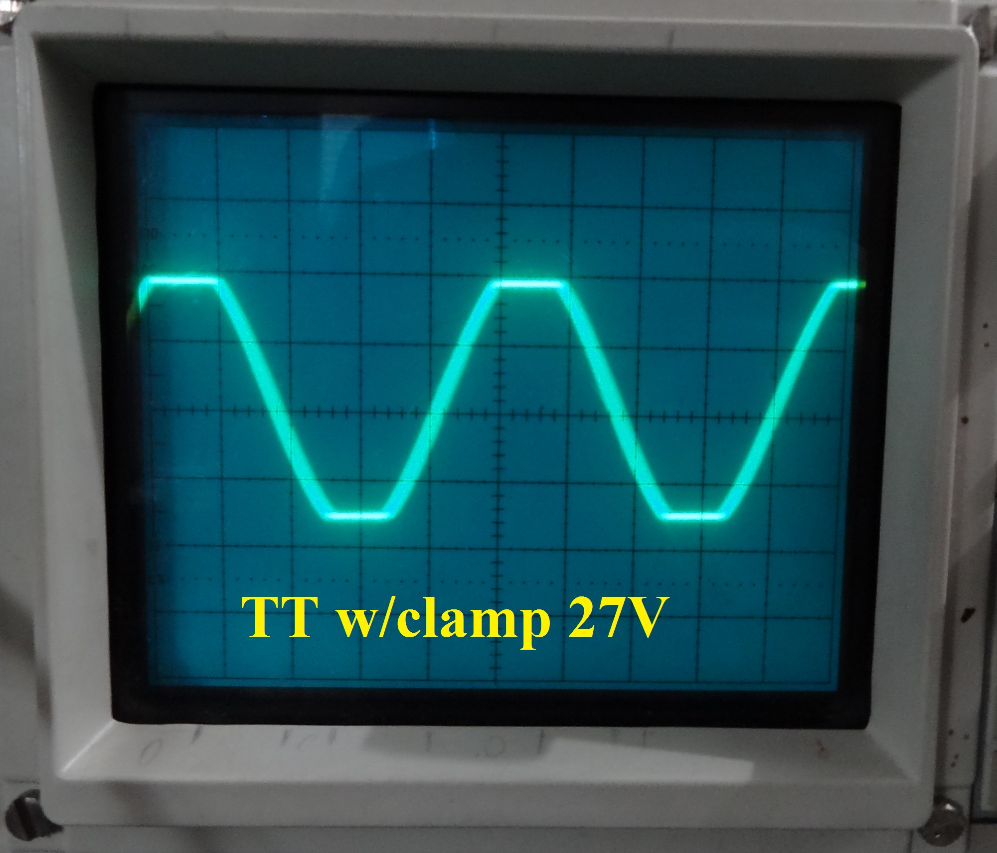

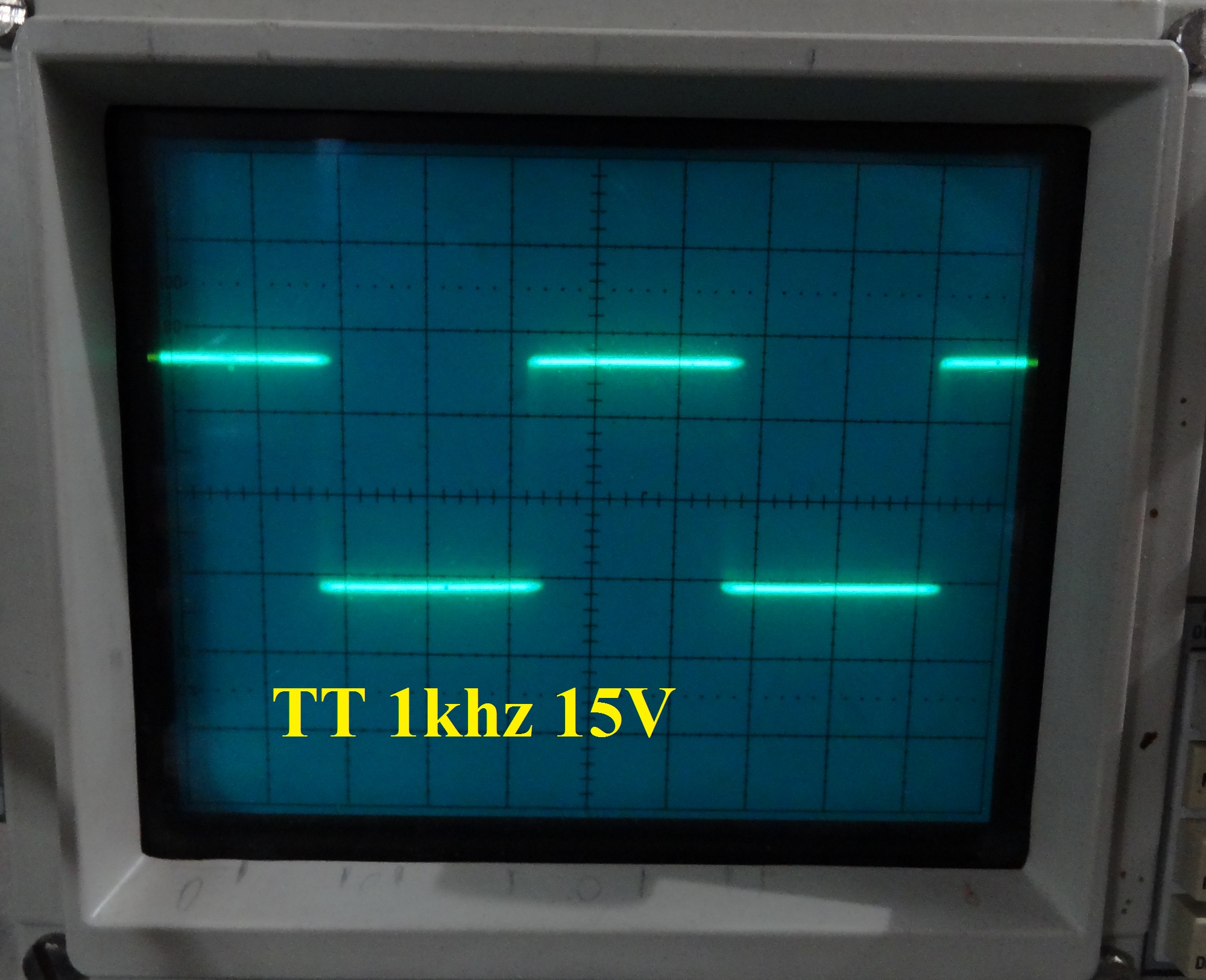

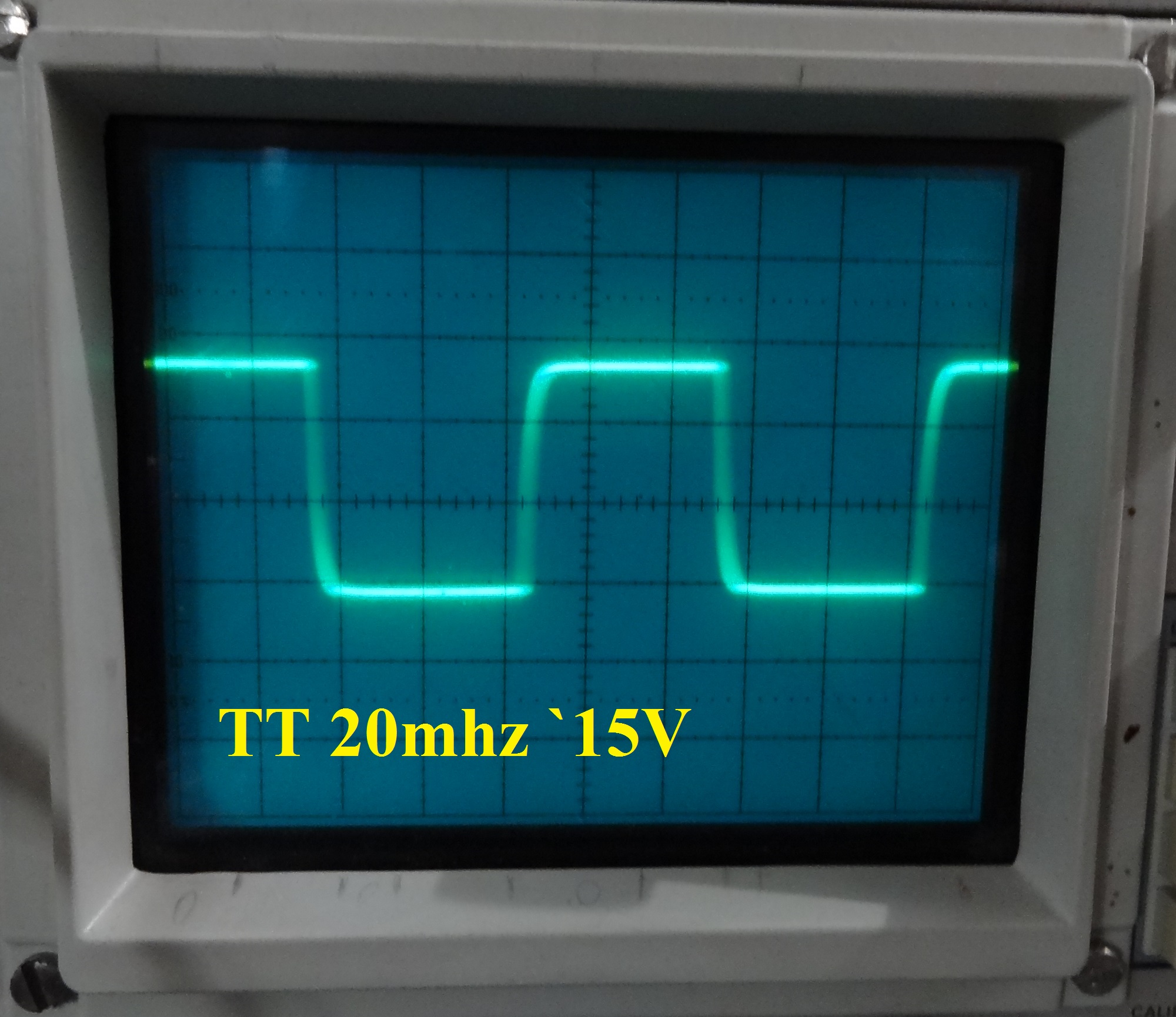

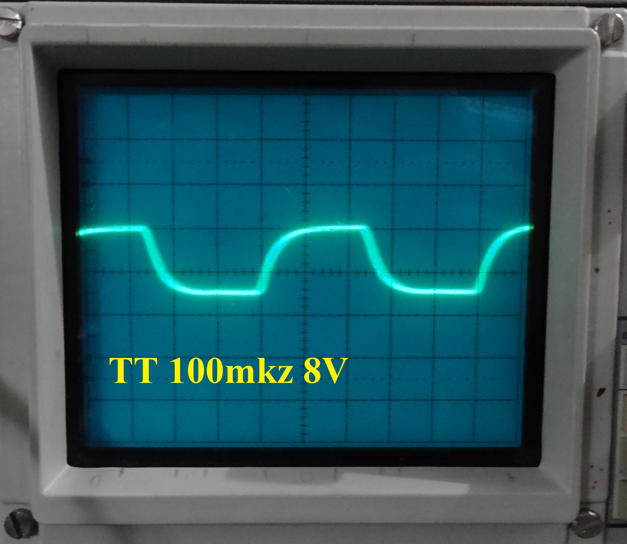

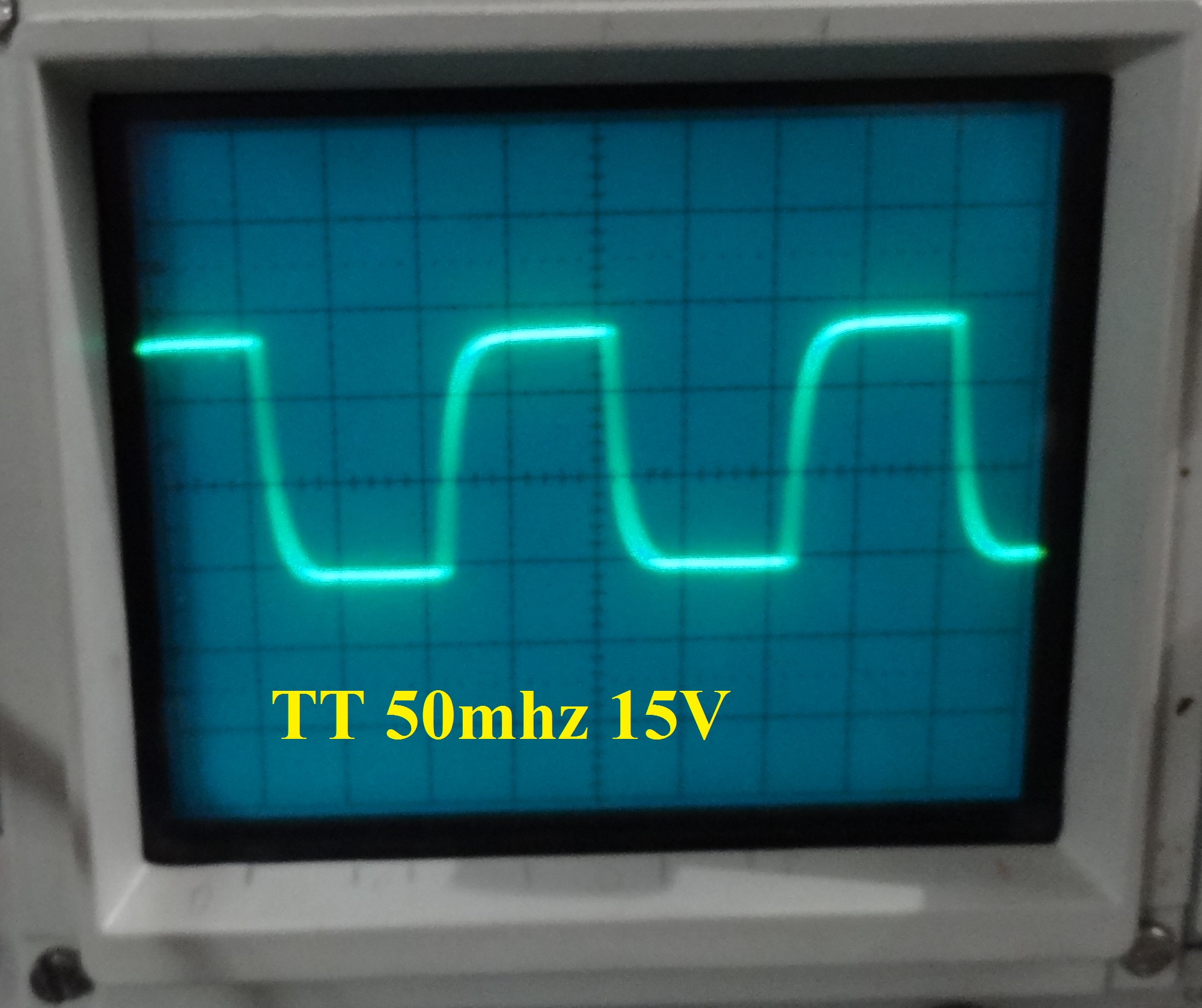

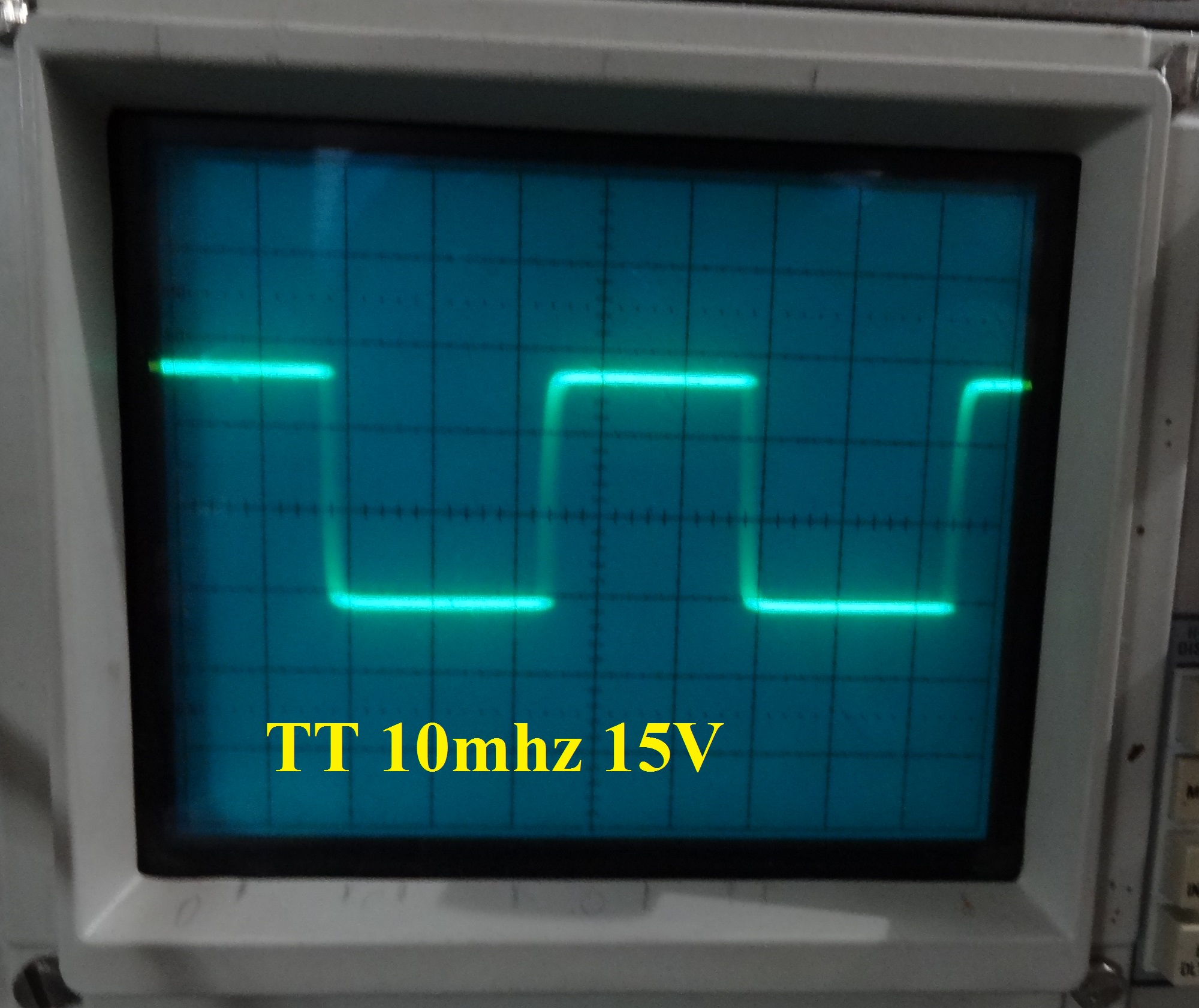

I have good news. I added a BAV21 diode from Q12 collector to Q15 base per Ostrippers' instruction for the Honey Badger which had a similar latching problem. The latching is gone. I have attached some scope shots showing the clipping as well as square waves. The amp begins to clip at about 26vac into an 8 ohm load which calculates to about 85W. A little lower than I was expecting with +-46V rails but more than enough for any listening that I do. If the clamp raised the distortion I can't hear it. The sound if very pleasing with clear highs and mids and solid bass.

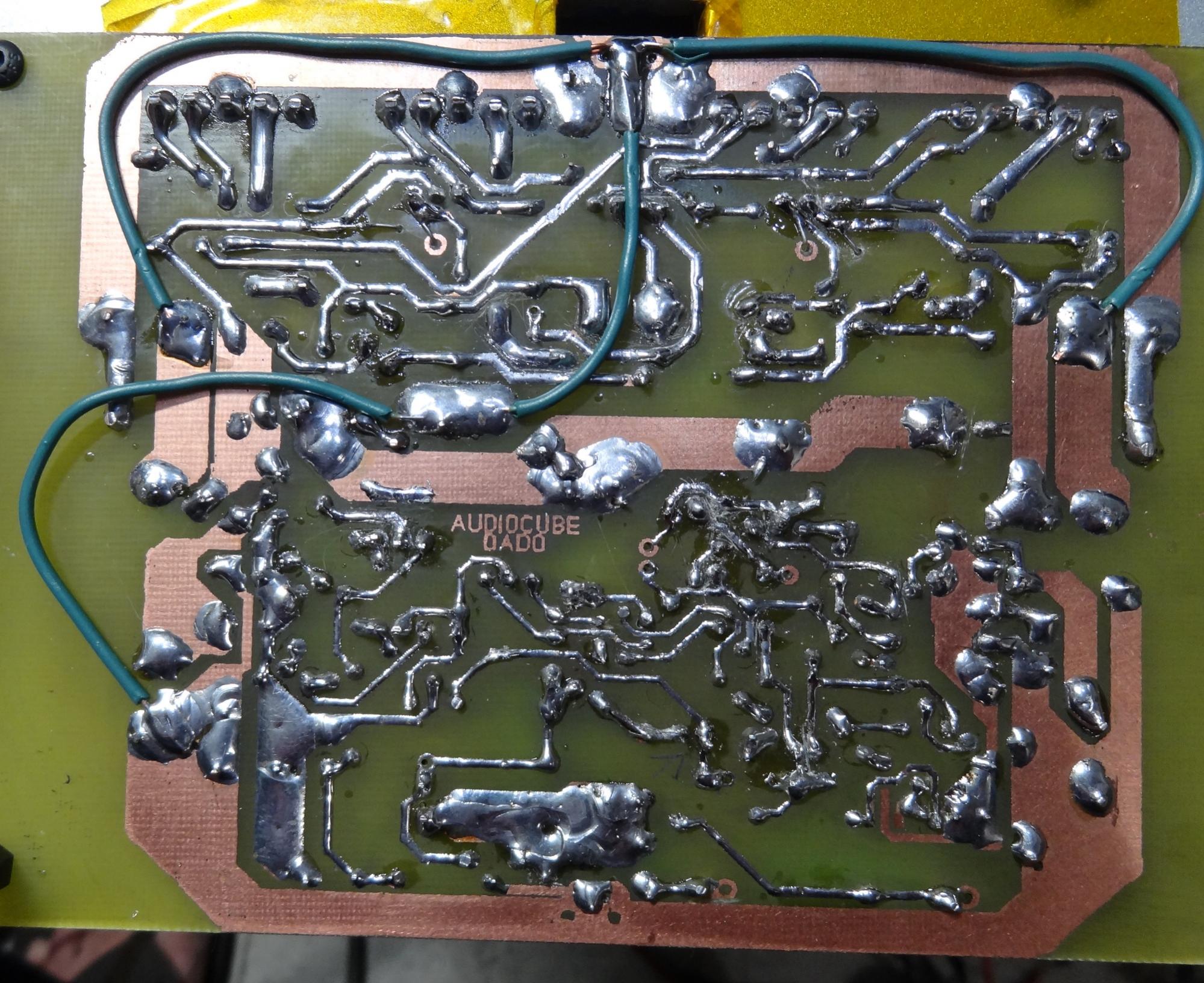

I have also attached a shot of the bottom of the board showing how I attached the ground wires. The amp is dead quite right now. I may have to add the ground from input to star if I mount it all in a case, but on the bench it is trouble free,

Hi Damir,
Do you really believe you can hear the difference between .000038% and .000003%? I don't believe I can. However I believe I can tell the difference between a speaker that is subjected to the sever latching that this amp has without that diode and a speaker that isn't. If you have a way to stop the latch-up characteristics of this amp that doesn't include that diode I will be happy to try it. I would never install this amp in a cabinet and use it for my everyday amp if I knew my speakers were in danger if someone were to turn up the amp too loud. Pick your poison I suppose.
I did listen to it after the diode was installed. I couldn't hear anything objectionable. I suppose I could pull the diode back out of one side and see if I can detect any sound change. Supposedly, the diode doesn't affect the circuit during normal use and only kicks in when approaching clipping. I never intentionally play an amp loud enough to clip.
As for the output power, you are probably right. The PSU I am using for testing is only a 250VA transformer. I did not check the rails at clipping. It wouldn't surprise me at all if they had sagged 2V. 85W is more than ample. I would be surprised if I ever listen to more than 10w during normal listening.
I will try to get this amp attached to some proper heatsinks and a stiffer power supply sometime this week. I will hook it up to my A/B setup and let compete with some of my other amps. What limited time I've had to listen has been very promising.
Blessings, Terry

I have 6k8 there per the schematic. I didn't try 10k. How does that stop the latch up? This amp also doesn't seem to like high frequency square waves. I hear sizzling from 50khz up. Sine waves don't cause it, only squares. I started with the diode because it was easy to install. The board already had pads for it. When I saw that the clipping looked nice I stopped. I don't know if you tried it. I know you said yours latches. The amp sounds very good like this.
