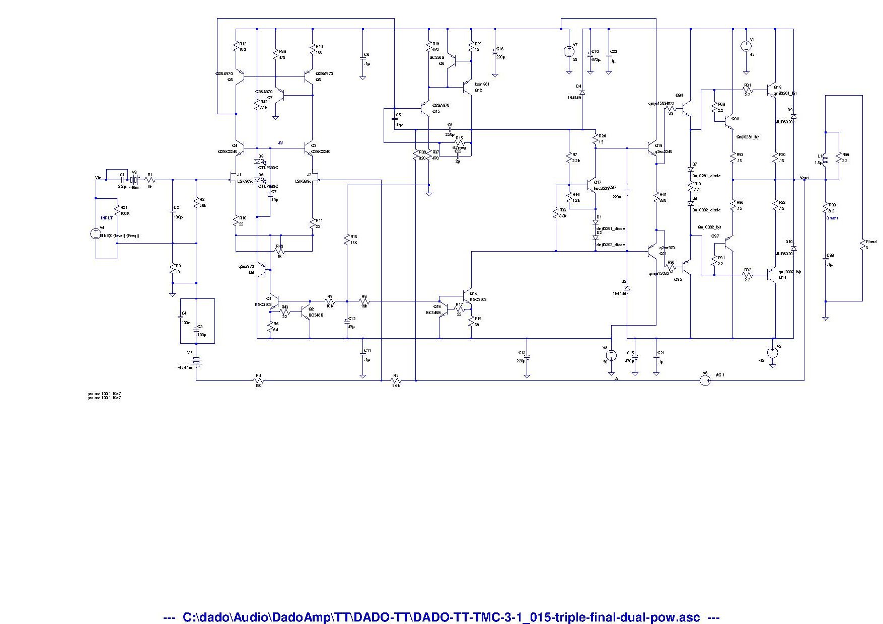

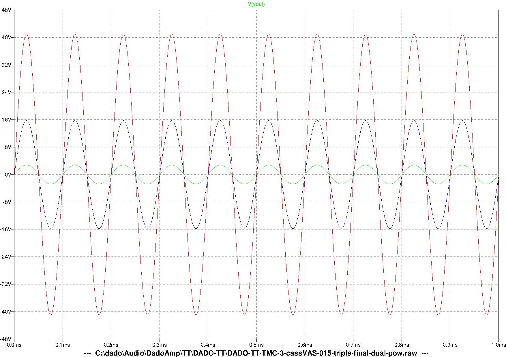

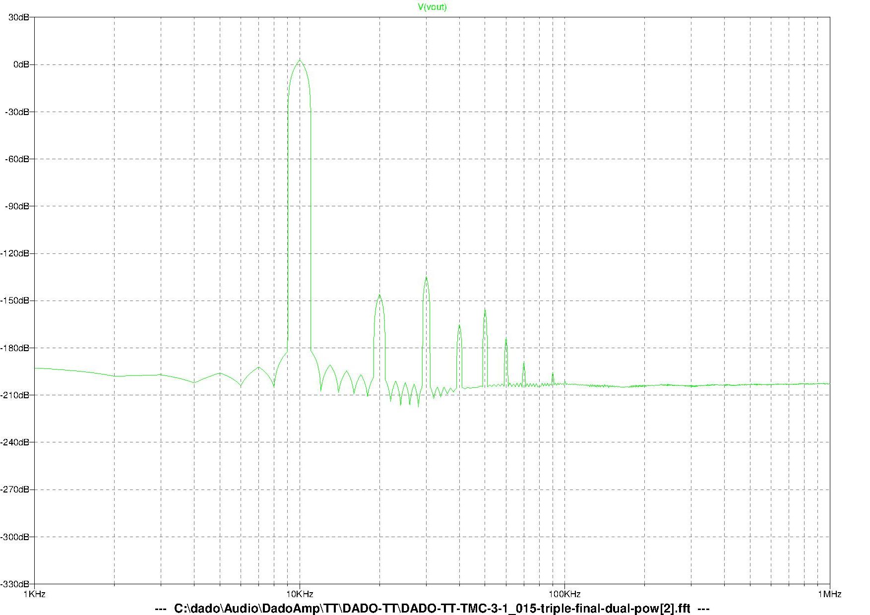

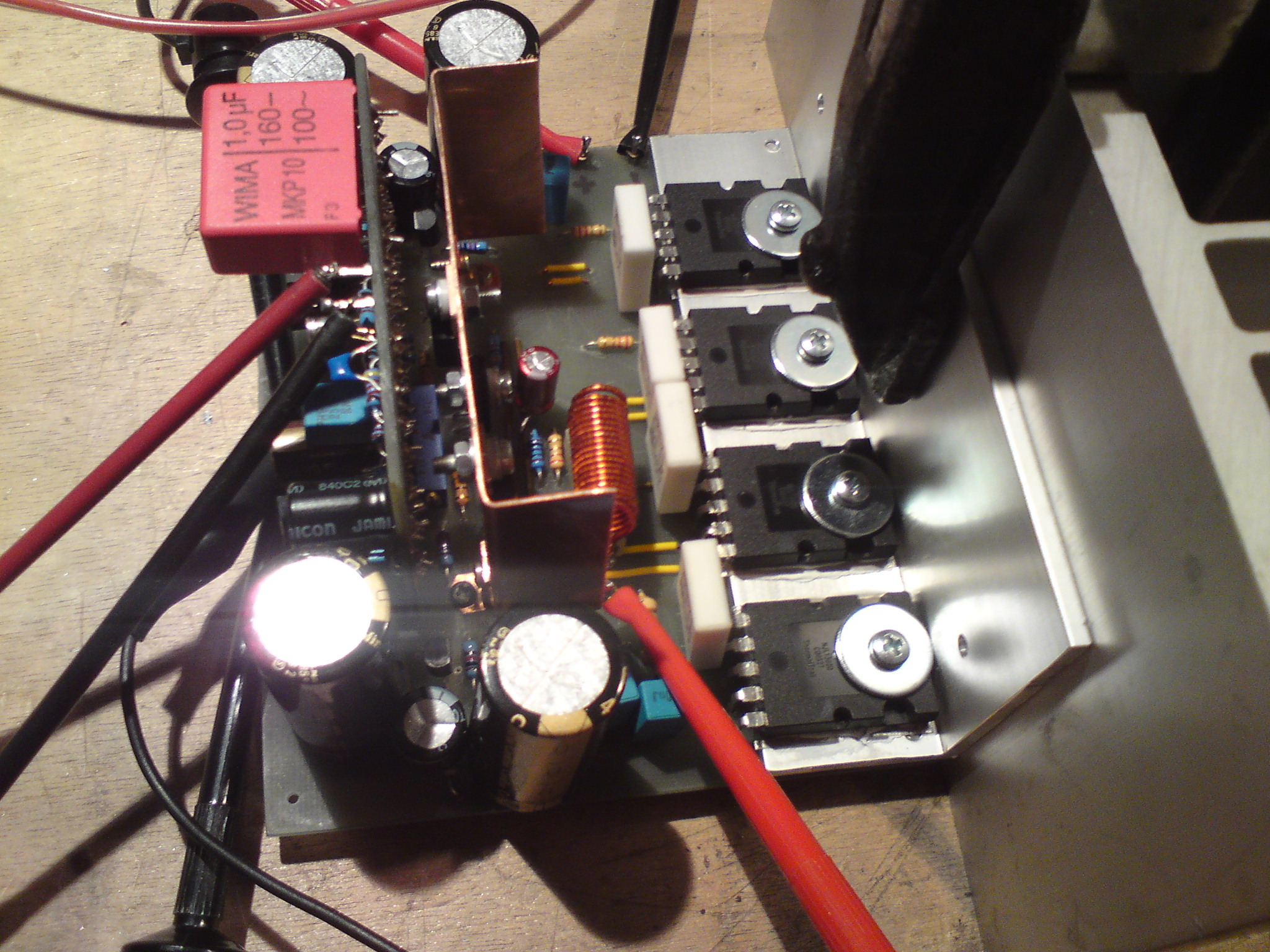

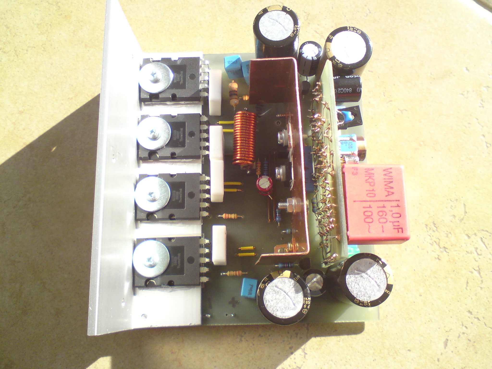

For some time I am trying an amp with TermalTrak ON semiconductor. I included TMC too and here is what I came up to now.
I simulated it with LTSpice and the results are here.
THP at 1kHz is 0.000011% and at 20kHz is 0.000186%.
I did PCT with Sprint Layout and tested it with my test bench power supply +-30V up to 2A.
I did not test it with +-50V for what it was designed.
The bias seams to be stable, it did not change from 20deg C to 50deg C.
This is just proto board, main board and small input board. I intend to mak all in one board, it was for testing porpoises. It was not tested with a musik jet, no power supply redy jet.

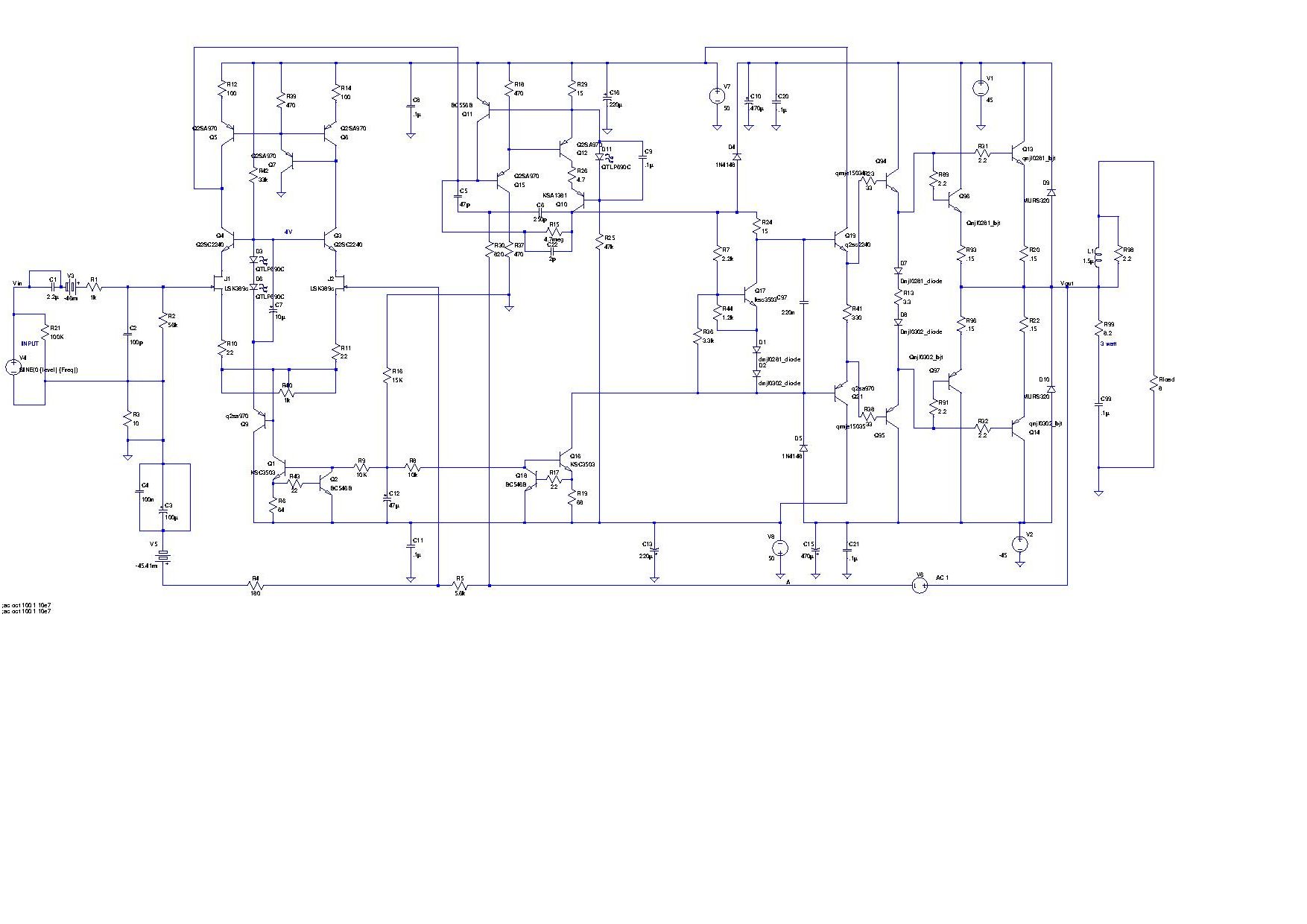

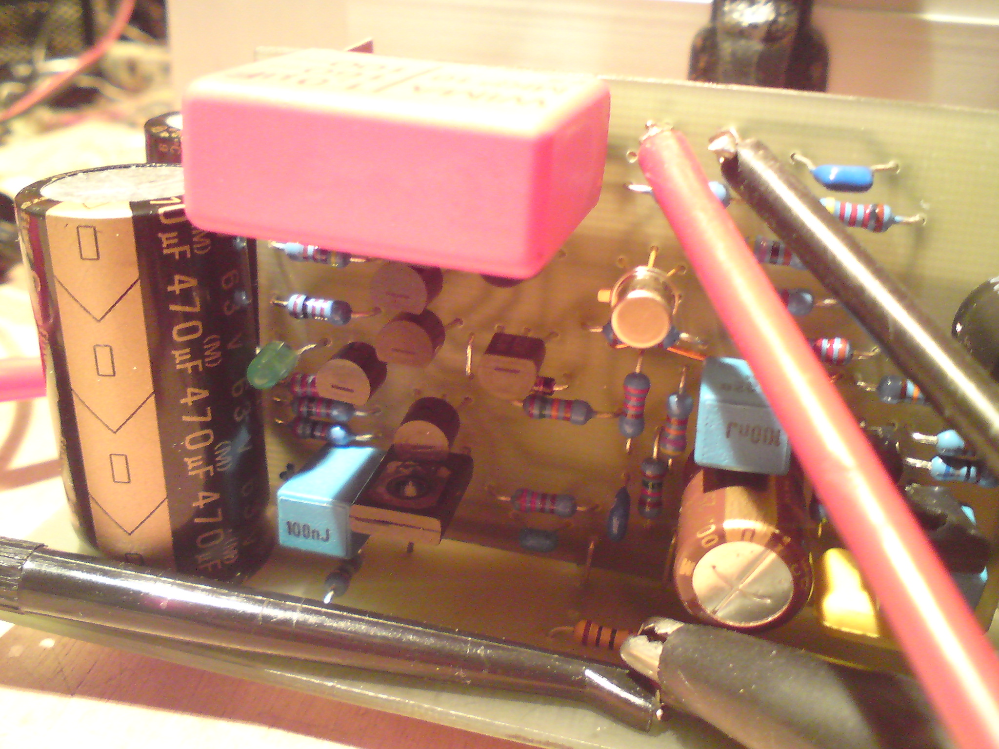

ThermalTrak+TMC
Sorry for previous post, I sent it accidentally.
The first CCS is cca 9mA, and this is 4mA per each side of the LTP. 1ma is for cascode to keep cca 10V on JFETs.

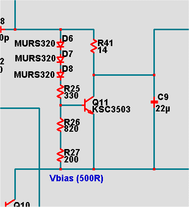

The bias control is ddivided between ThermalTrak diodes and Vbe multiplier.
Vbe multiplier is thermally connected with the drivers only as suggested by Bob Cordel.
I was thinking to use a triple as suggested by Cordel for ThermalTrak in one of the ThermalTrak treads. I will do that probably later, never use triple before. Symulation does not show important improvement.

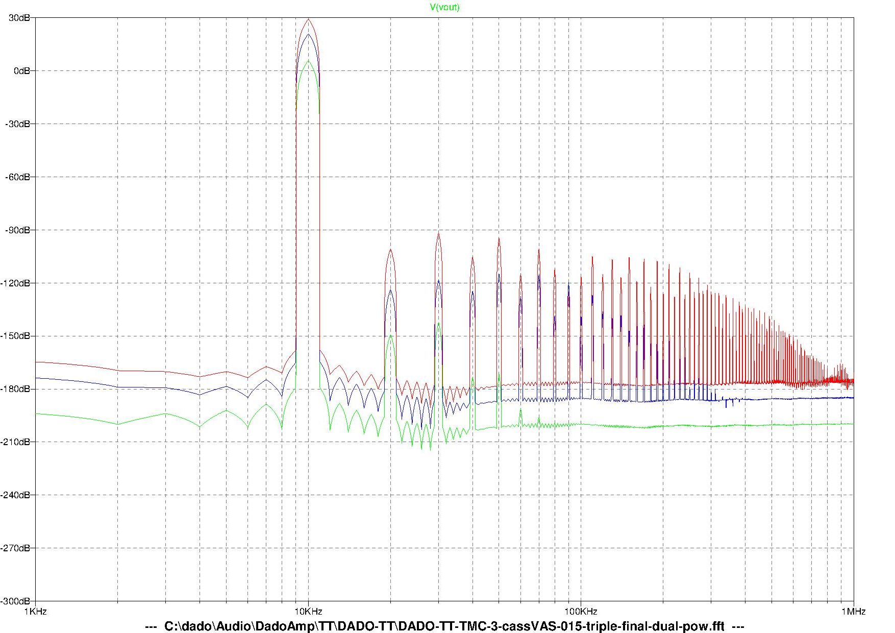

Fourier components of V(vout) 1kHz
DC component:-0.0296359
Harmonic Frequency Fourier Normalized Phase Normalized
Number [Hz] Component Component [degree] Phase [deg]
1 1.000e+03 2.665e+01 1.000e+00 -0.13° 0.00°
2 2.000e+03 1.973e-06 7.402e-08 87.49° 87.62°
3 3.000e+03 2.029e-06 7.615e-08 11.10° 11.23°
4 4.000e+03 2.899e-07 1.088e-08 -41.62° -41.49°
5 5.000e+03 1.746e-07 6.550e-09 -15.60° -15.47°
6 6.000e+03 2.994e-07 1.124e-08 -7.33° -7.19°
7 7.000e+03 3.302e-07 1.239e-08 0.49° 0.62°
8 8.000e+03 4.099e-07 1.538e-08 -6.78° -6.64°
9 9.000e+03 4.130e-07 1.550e-08 -0.83° -0.70°
Total Harmonic Distortion: 0.000011%
Fourier components of V(vout) 20kHz
DC component:-0.029628
1 2.000e+04 2.663e+01 1.000e+00 -2.61° 0.00°
2 4.000e+04 2.881e-05 1.082e-06 96.30° 98.91°
3 6.000e+04 1.920e-05 7.208e-07 143.84° 146.45°
4 8.000e+04 1.628e-05 6.112e-07 -143.04° -140.44°
5 1.000e+05 2.368e-06 8.890e-08 -34.05° -31.44°
6 1.200e+05 1.431e-05 5.375e-07 -150.17° -147.56°
7 1.400e+05 1.741e-05 6.536e-07 145.16° 147.76°
8 1.600e+05 1.129e-05 4.241e-07 -148.10° -145.49°
9 1.800e+05 1.883e-05 7.072e-07 137.23° 139.84°
Total Harmonic Distortion: 0.000186%

Simulated THD figures are far from reality. Better show real world prototype measurements.
TT+TMC Slew Rate improvement as suggested by D. Self
To improve Slew Rate I change CCS-s according to D. Self.
That I did in LTSpice only.Intereting is when change was made that controling CCS to be VAS CCS instead LTP CCS as in build protype the THD at 20kHz increased threefold.
Then, when I added small capacitor of 6pF(D. Self suggestion) between CCS collector and base of the controlling transistor, it incresed dramatically. Is it worth to increment slew rate and in the same time the THD???
D. Self CCS

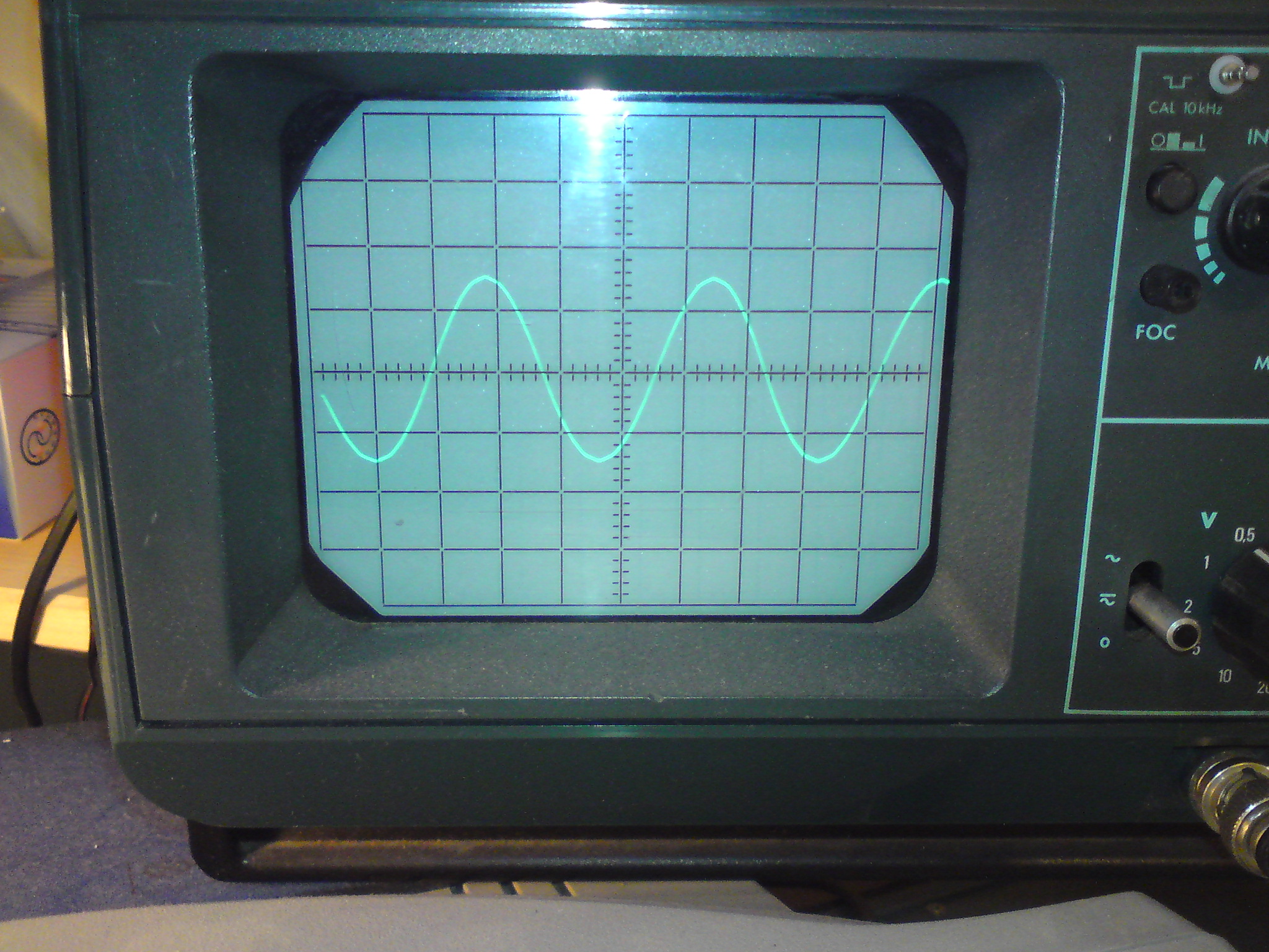

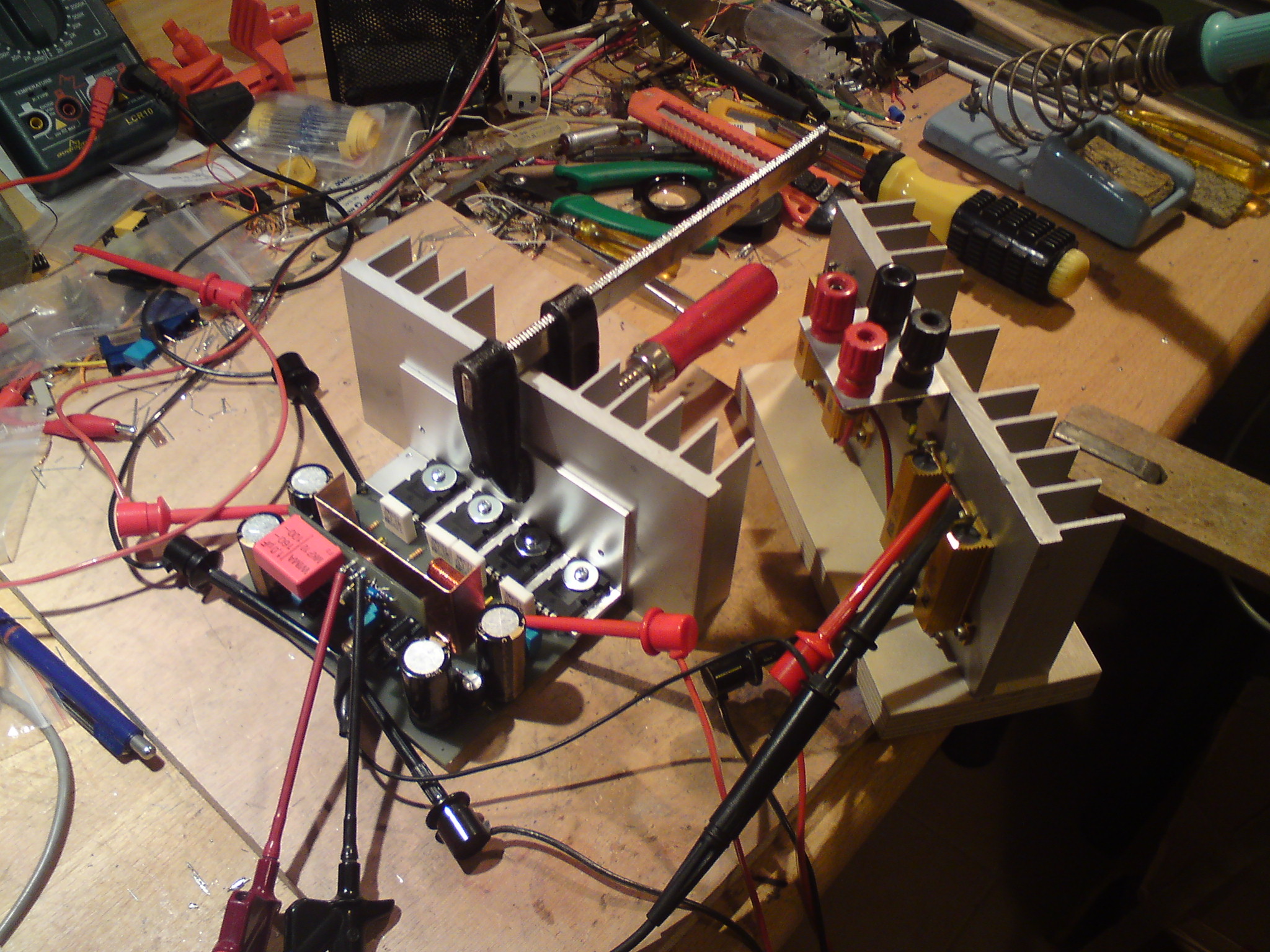

Amp powered up and some listening
I have powered up this amp from +-50V temporary power supply. You can see it on the photo.
I was listening it for short time, only one chanell, in mono. Sound was good and clear. I need stereo set up to evaluate it more accurately.
With 0.1 ohm as emiter resistor the bias increased for 17% from 25 degree C to 50 degree C.
With 0.22 ohm it increase for 15% for the same change in temperature.
I run it without input signal and no heathsink, only alu bracket. Output transistor temerature slowly increased from 25 to 50 degree C just run with bias current and at that point I switched off the power.
For 0.1 ohm I adjusted the voltage to 13mV, means bias current to 130mA, and it increased to 17mV at 50 degree.
For 0.22 ohm it was 20mV and it increased to 23mV (from 90mA to 105mA.
I think it is qute good result.

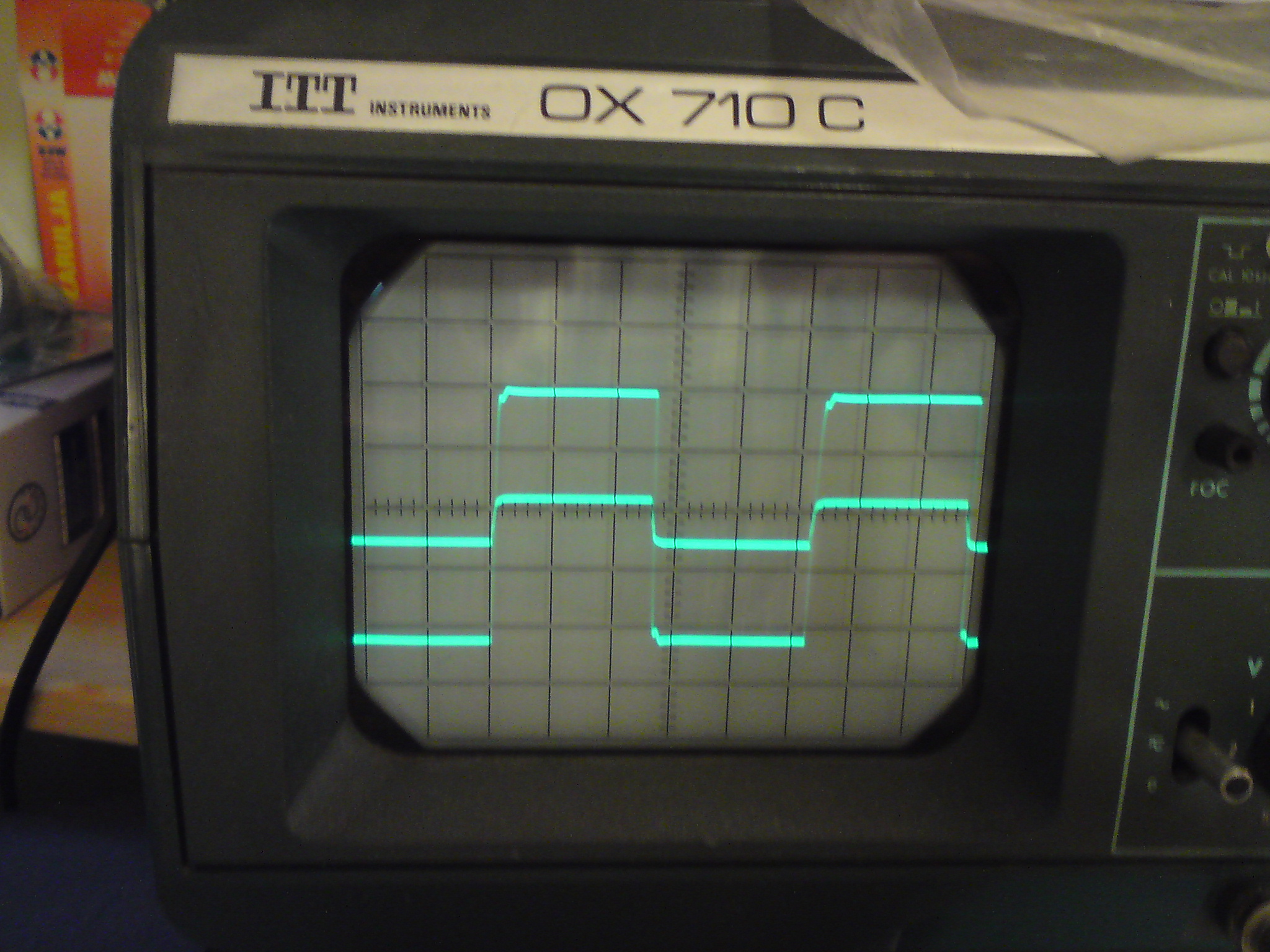

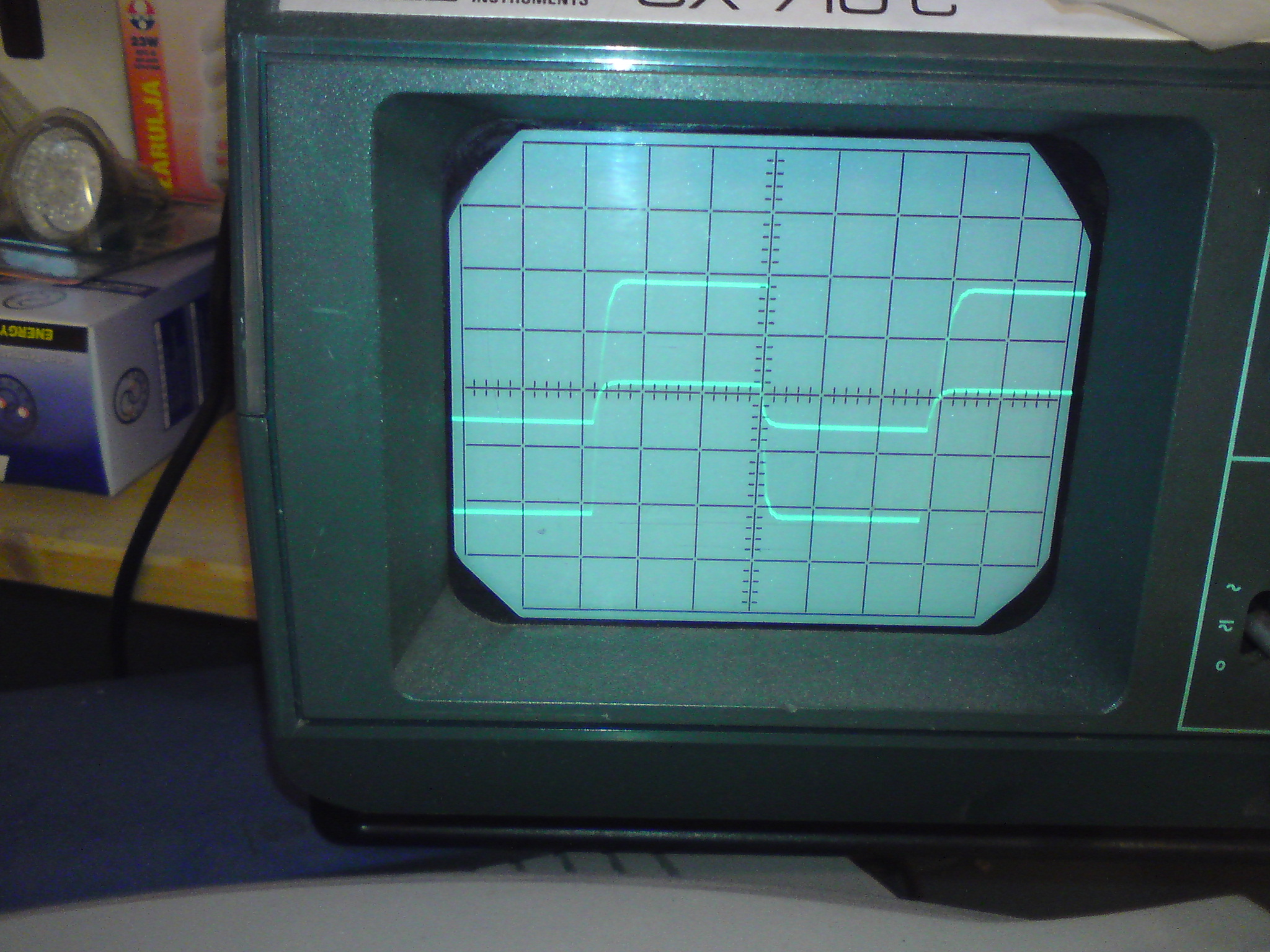

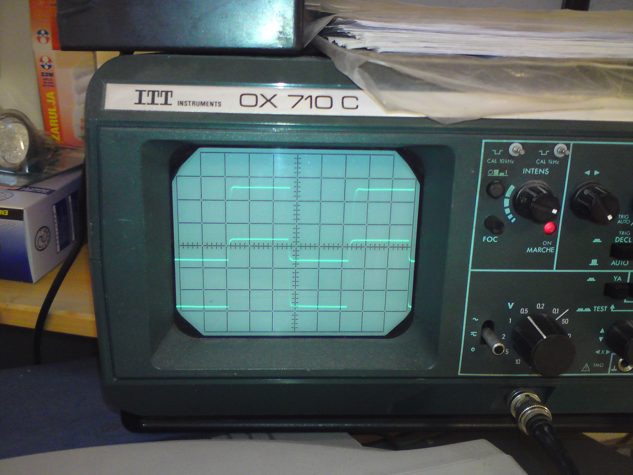

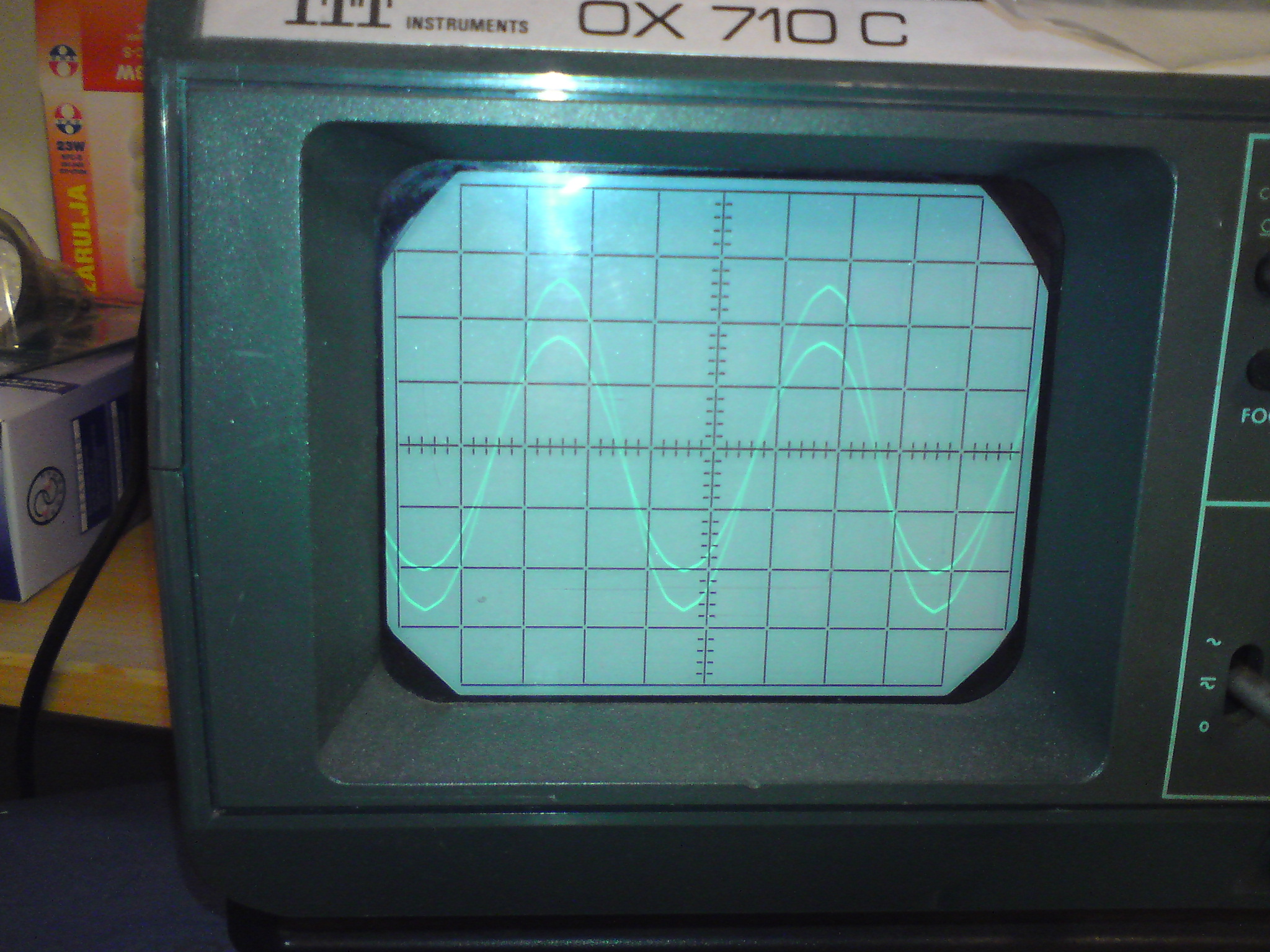

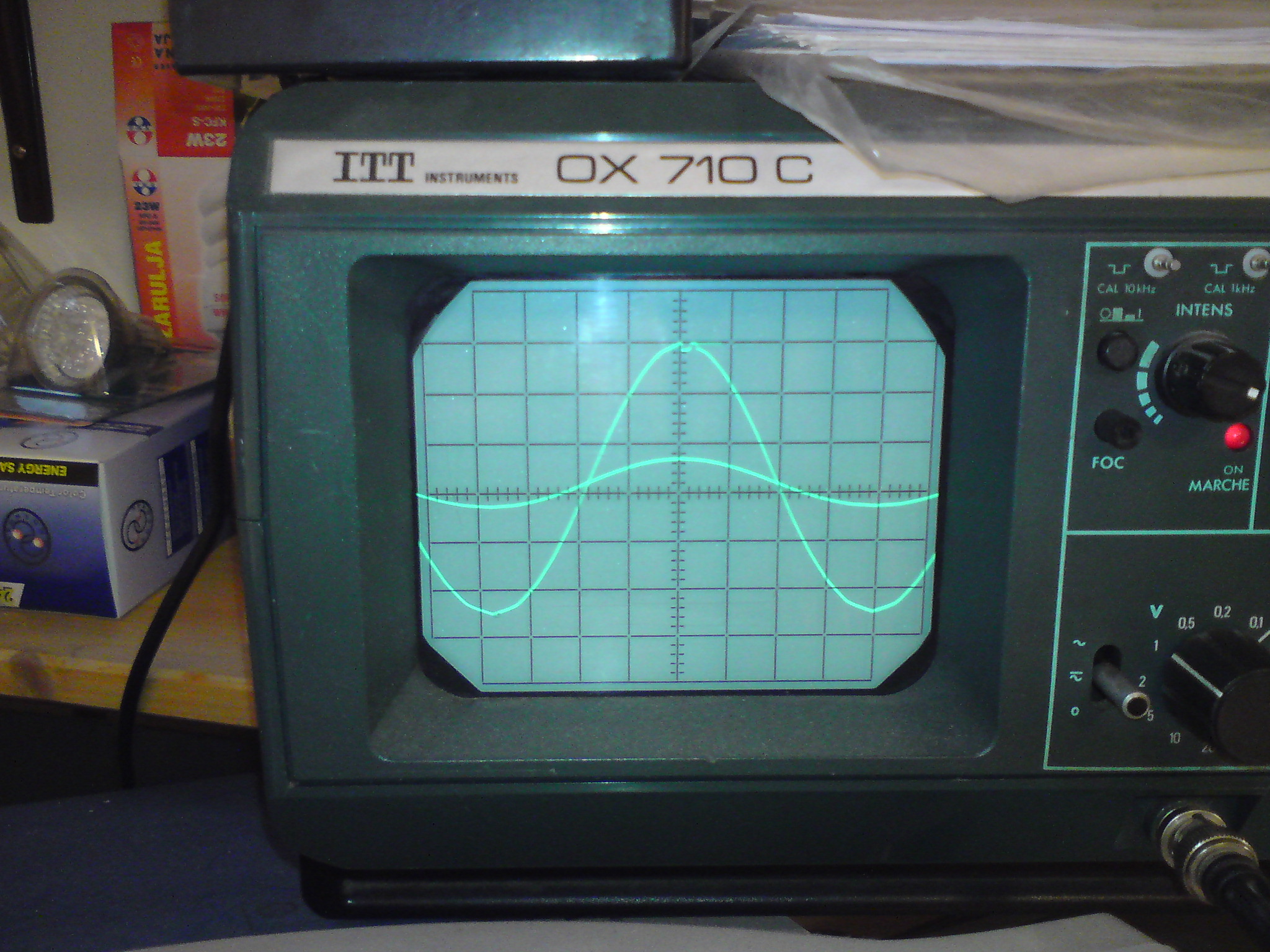

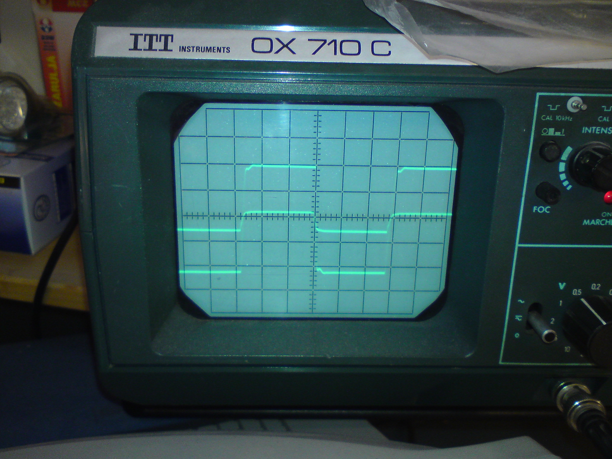

After that I connected amp to signal generator (quite high disstortion about 1%)
On the scope screen are two sinus signals input(lower amplitude) and output on 8 ohm.
Here is also sinus klipping where is visible TMC type of klipping.
With the square signall there are the photos at 1kHz and 20kHz without and with capacitor parallel to he load. First with 10nF and then with 0.1uF.

I changed a bit in a mintime and here is a new circuit diagram.
Input stage up to predriver will be powered from separate voltage higher by 5V then output valtage. Now I can use simple clamp(D4 and D5) to prevant clipping in OPS.
I apreciate commentcs before to start practical implamentation.
This one shows simulated distortion of 0.000014% at 1W and 10kHz.
dado

Do D7 & D8 reduce the driver bias current, as the outputs warm up? Or do they increase the driver bias current?
I am not sure. I think that this influence is minor, but I have to simulate it, as I have not yet.
More about this diodes look at http://www.diyaudio.com/forums/soli...al-compensation-thermal-trak-transistors.html
dado
Try this (below) , . For a EF2 -only 3 diodes (4 for triple). If over compensated , try 3 diodes , adjust the 330R. I simmed with mur320's - just about equivalant to the TT's. The 3503 is NOT thermally coupled.
PS - playin' around , I ran this just to see .... as it is a MJE/NJW OP stage is biased at exactly 75ma/.22Re with what you see. The NJL(TT), might be slightly different.
OS
OS
OS
Thanks OS, I tried this configuration as used in Leach amp. I bought Cordell book and after that decided to use his recommendation for bias spreader. In this case I use two TT diodes to stabilize the bias and other two to keep the impedance between drivers emitter very small. In this amp I use two TT pairs as that is more than enough for my project(amps for Orion loudspeakers).

Why not to use convenience of the higher voltage for the imput part and not to use cascoded VAS.
Here is circuit diagram with Hawksford cascode for the VAS.
Simulated distortion:
.step level=0.088
DC component:-0.0109679
1 1.000e+04 2.775e+00 1.000e+00 -0.75° 0.00°
2 2.000e+04 4.674e-08 1.684e-08 131.39° 132.14°
3 3.000e+04 1.078e-07 3.884e-08 111.54° 112.29°
4 4.000e+04 6.440e-09 2.321e-09 7.71° 8.46°
5 5.000e+04 2.205e-09 7.948e-10 38.68° 39.42°
6 6.000e+04 6.127e-09 2.208e-09 -4.10° -3.35°
7 7.000e+04 6.956e-09 2.507e-09 -6.21° -5.46°
8 8.000e+04 7.828e-09 2.821e-09 -4.59° -3.84°
9 9.000e+04 8.796e-09 3.170e-09 -3.38° -2.63°
Total Harmonic Distortion: 0.000004%
.step level=0.5
DC component:-0.0109674
1 1.000e+04 1.577e+01 1.000e+00 -0.75° 0.00°
2 2.000e+04 9.157e-07 5.808e-08 53.27° 54.02°
3 3.000e+04 1.722e-06 1.092e-07 110.31° 111.06°
4 4.000e+04 8.287e-07 5.257e-08 -152.95° -152.20°
5 5.000e+04 2.511e-06 1.593e-07 141.56° 142.31°
6 6.000e+04 5.673e-07 3.598e-08 -124.60° -123.86°
7 7.000e+04 2.376e-06 1.507e-07 154.46° 155.20°
8 8.000e+04 1.740e-07 1.104e-08 -80.98° -80.23°
9 9.000e+04 1.428e-06 9.057e-08 161.87° 162.62°
Total Harmonic Distortion: 0.000028%
.step level=1.3
DC component:-0.0109574
1 1.000e+04 4.099e+01 1.000e+00 -0.75° 0.00°
2 2.000e+04 1.297e-05 3.165e-07 7.47° 8.22°
3 3.000e+04 3.698e-05 9.022e-07 110.09° 110.84°
4 4.000e+04 7.739e-06 1.888e-07 -151.51° -150.77°
5 5.000e+04 2.625e-05 6.404e-07 -42.79° -42.04°
6 6.000e+04 2.595e-06 6.332e-08 74.68° 75.43°
7 7.000e+04 1.305e-05 3.184e-07 144.61° 145.36°
8 8.000e+04 3.457e-06 8.433e-08 -140.42° -139.67°
9 9.000e+04 7.925e-07 1.933e-08 -68.20° -67.45°
Total Harmonic Distortion: 0.000121%
