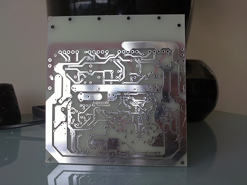

With Mason help we double checked the PCB layout and now I show three wersion of the TT amp.
First here is full version with TRIPLE output and buffered VAS. Schematic attached and the PCB layout, PDF inverted bottom layer(for hot iron method) and PDF layer for standard photo development.

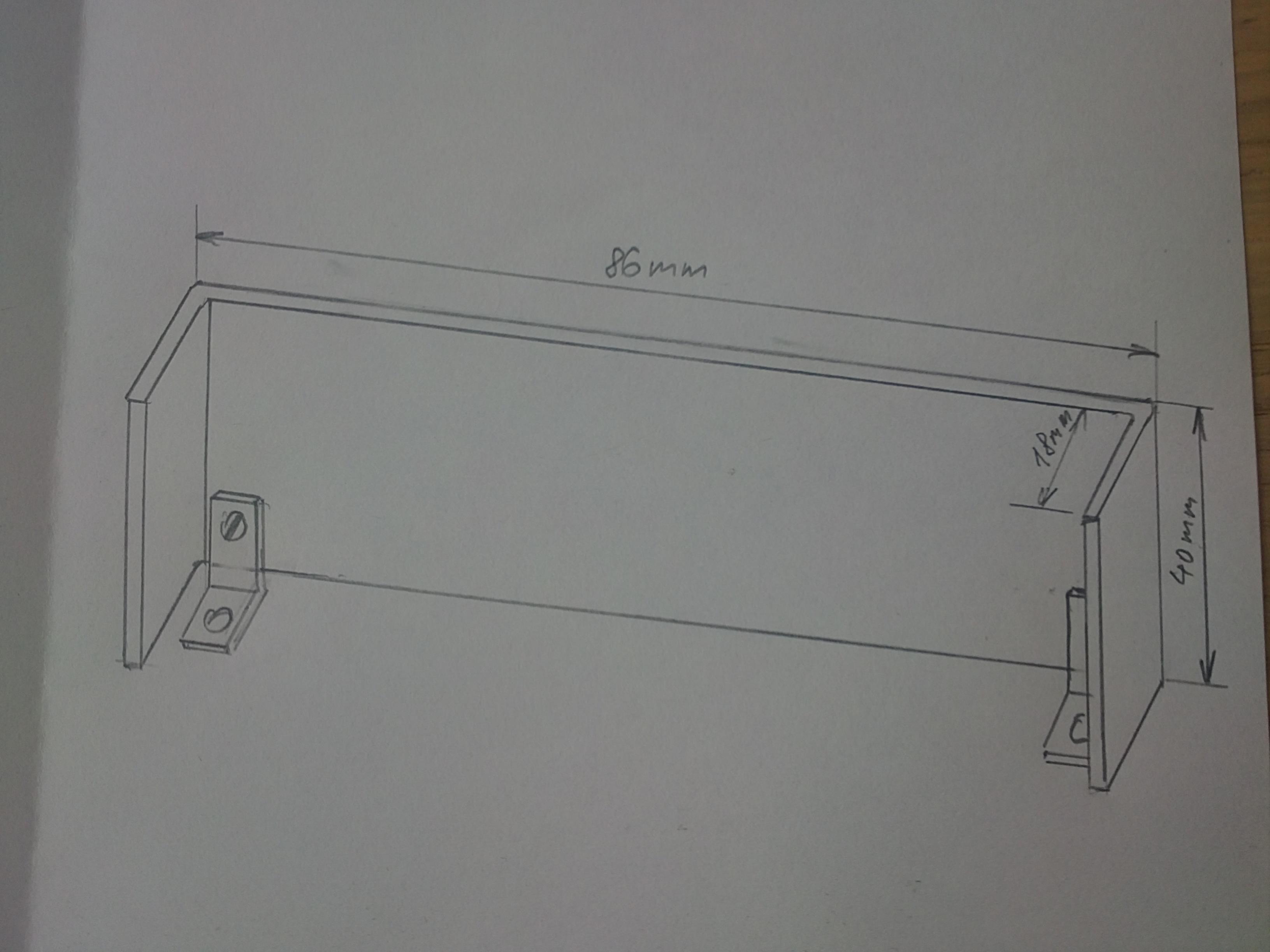

Also shoved home made drivers heathsink.
There some jumpers to be inserted and transistor not to be populated:

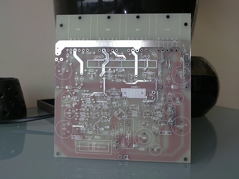

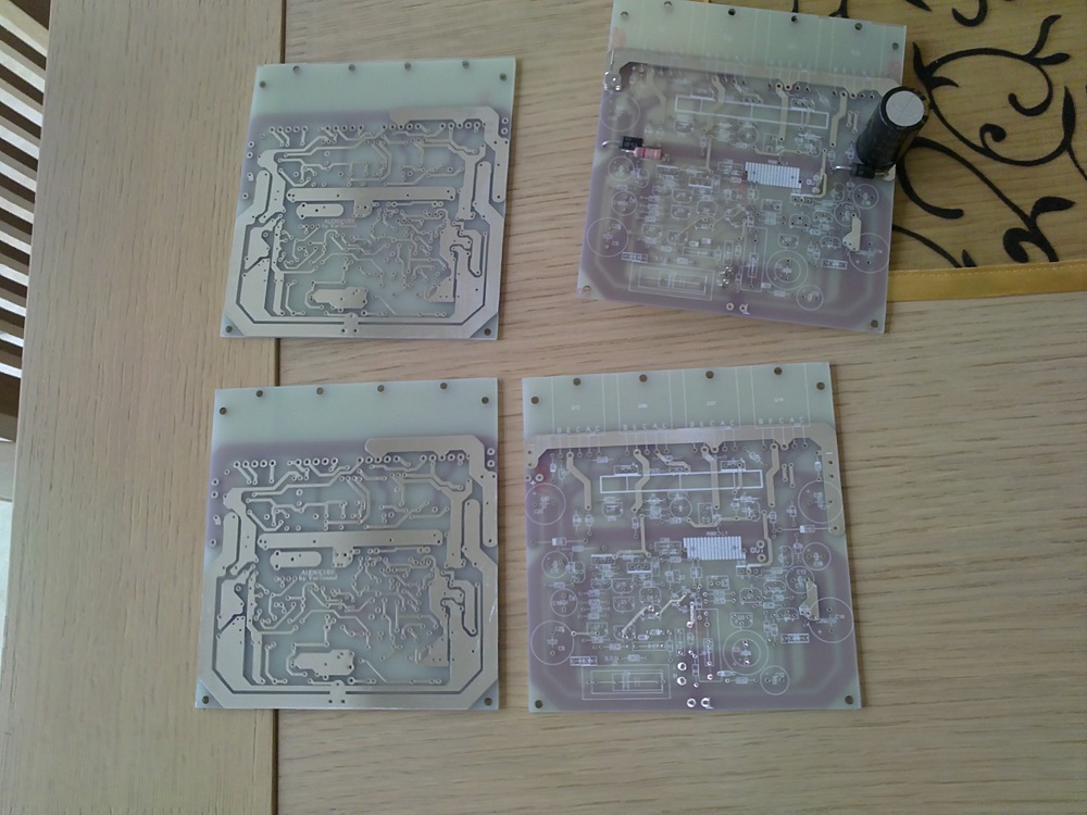

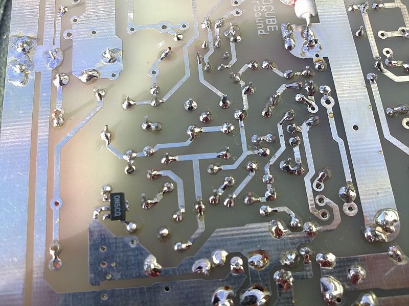

PCB
Today I received professionally made double sided PCBs. I hope that I will find time to finish soon one board at least.
dado

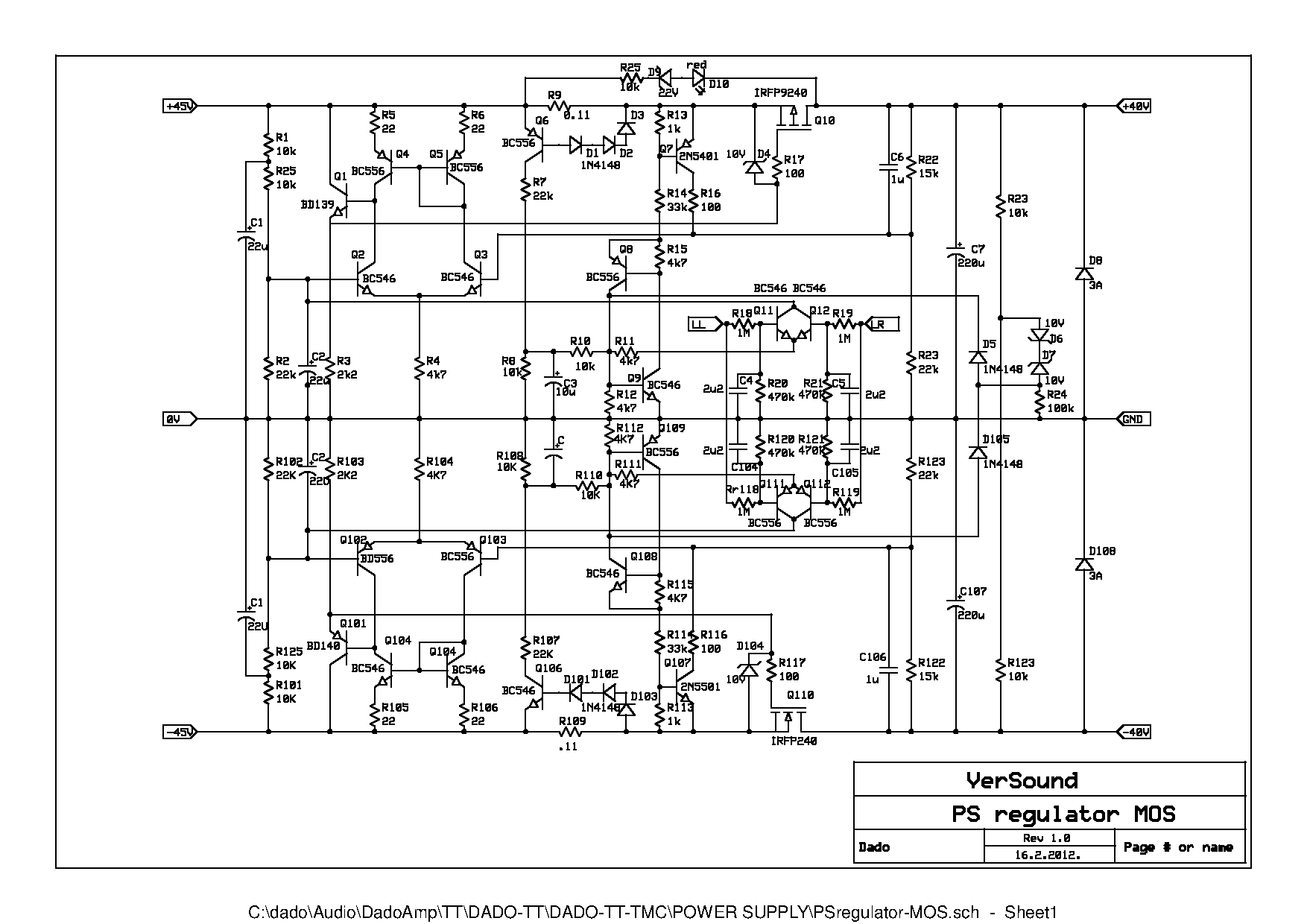

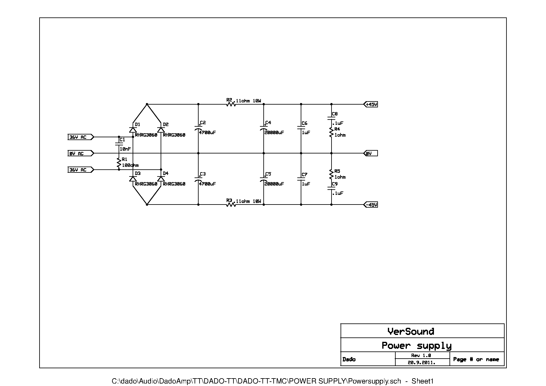

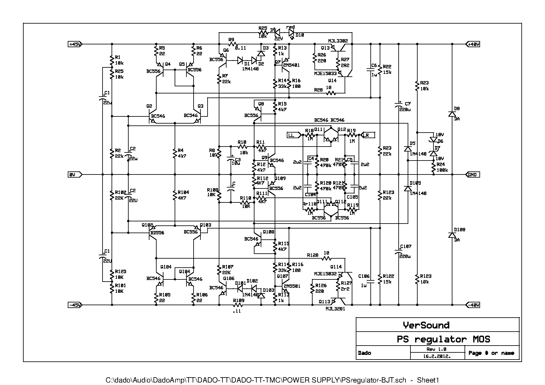

Power Supply
This is power supply I will use with TT amp.
First schematic is main power supply with fast diodes and big electrolytic capacitors.
Next are two schematics of a regulator and protection part, one with MOSFET regulator and one with BJT regulator.
The regulator part acts as capacitor multiplier, electronic fuse and loudspeaker protector, all in one.
Electronic fuse will act after some threshold set by series resistor(0.11ohm in this case) and with a delay, smaller toward higher current.
Loudspeaker protection will be trigered if DC voltage persists on power amp output. This is controled with 1Mohm resistor and 2.2uF capacitor.
I did not get any comment or suggestion for improvements on the power supply thread, so I hope, here I get some responce.
dado

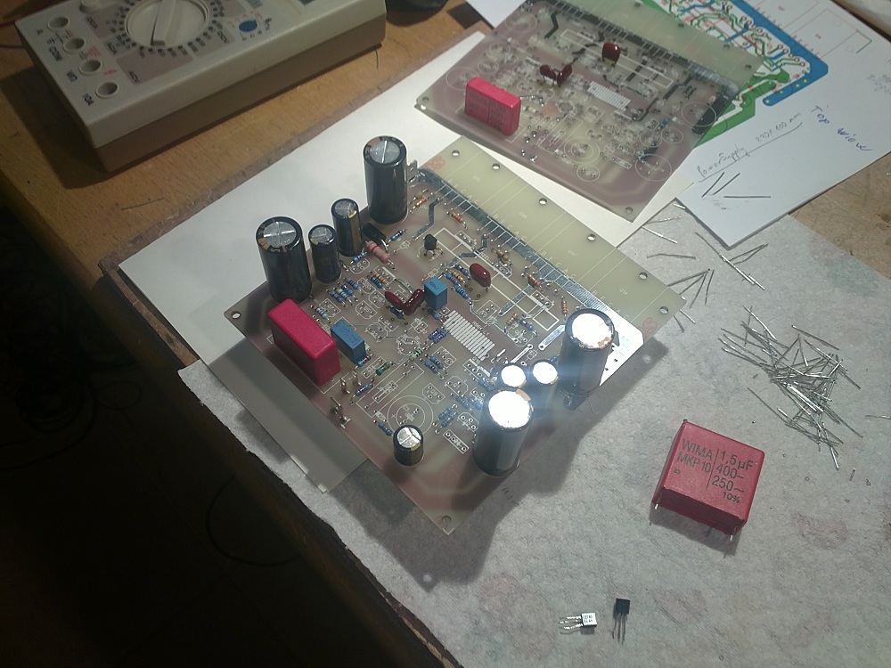

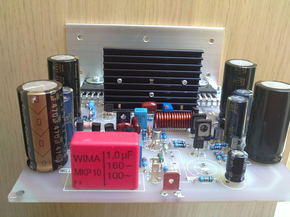

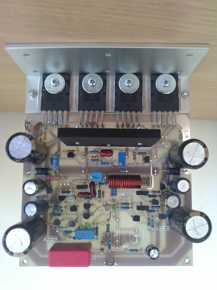

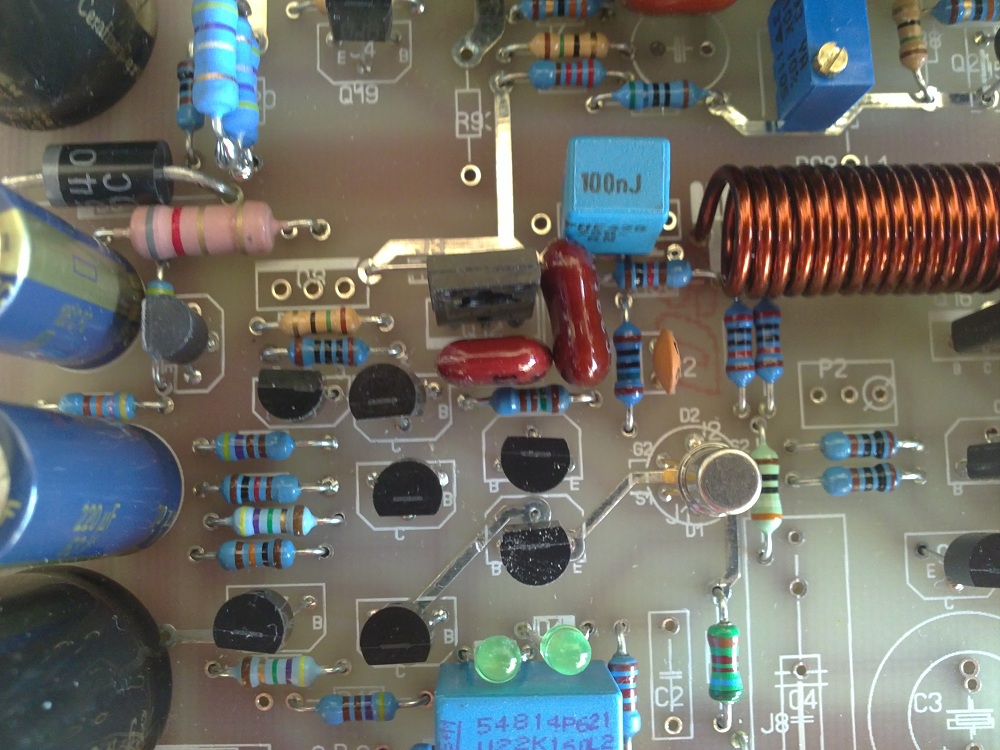

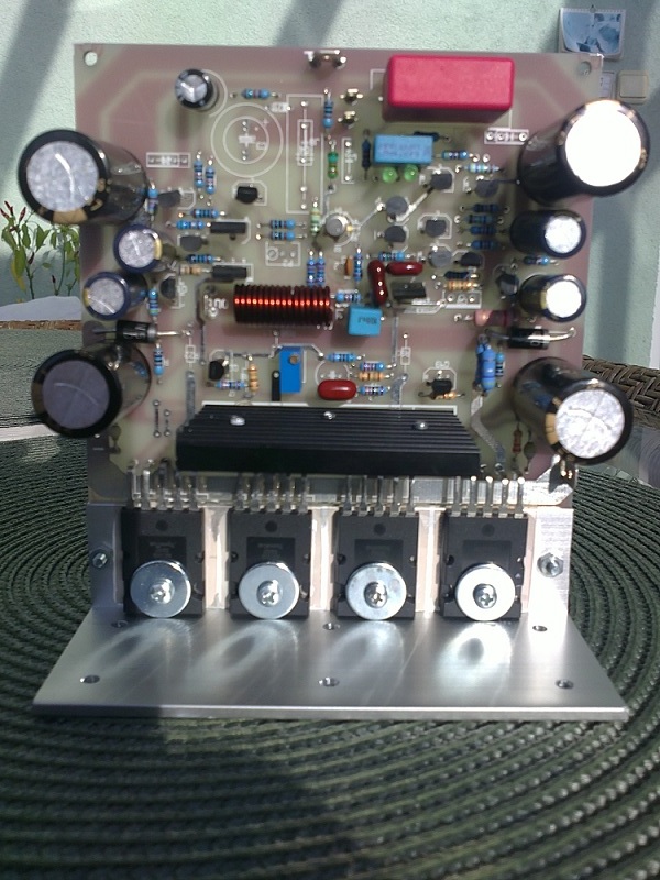

One channel almost ready to be powered up.
dado
