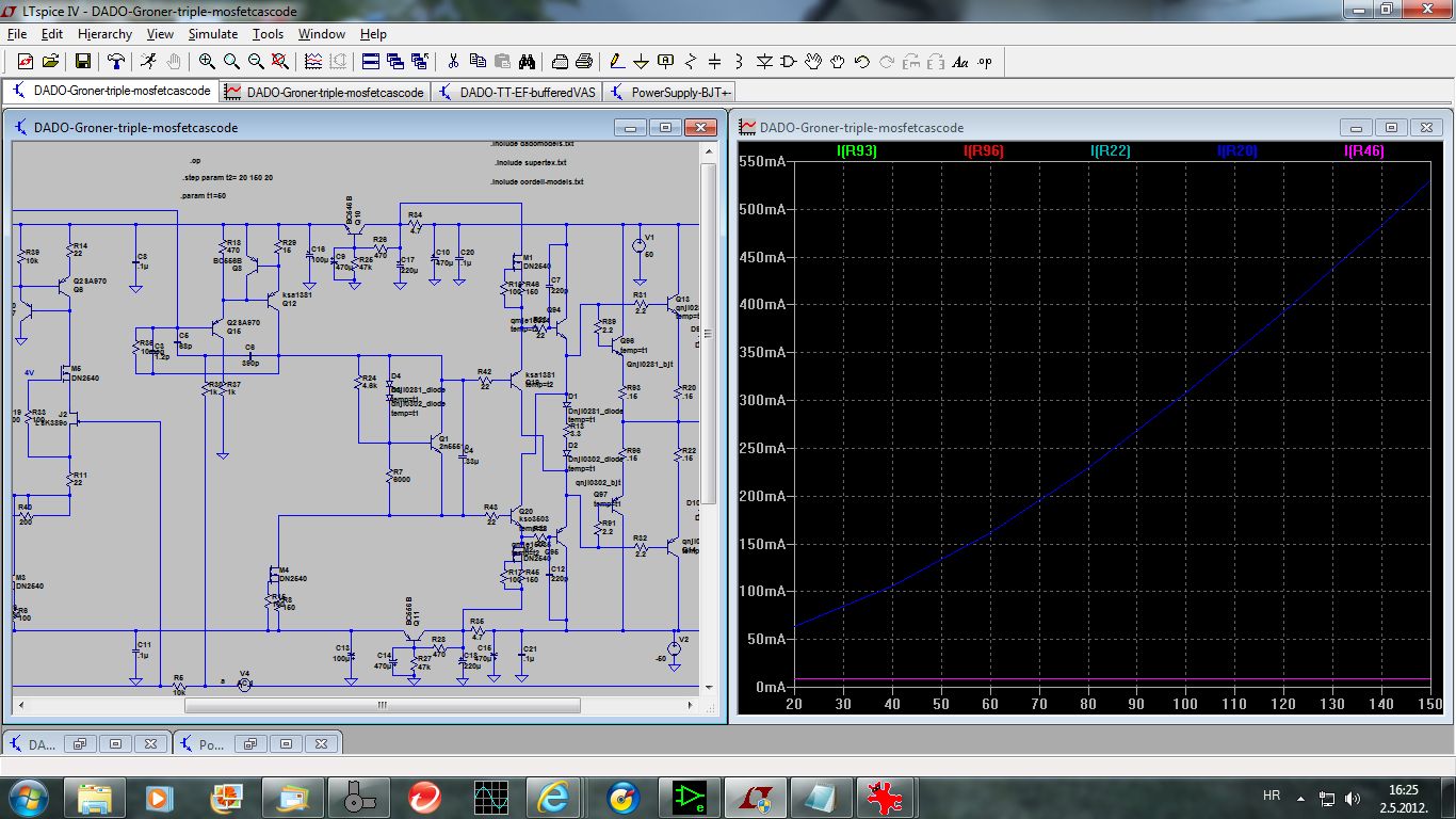

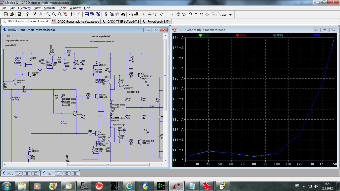

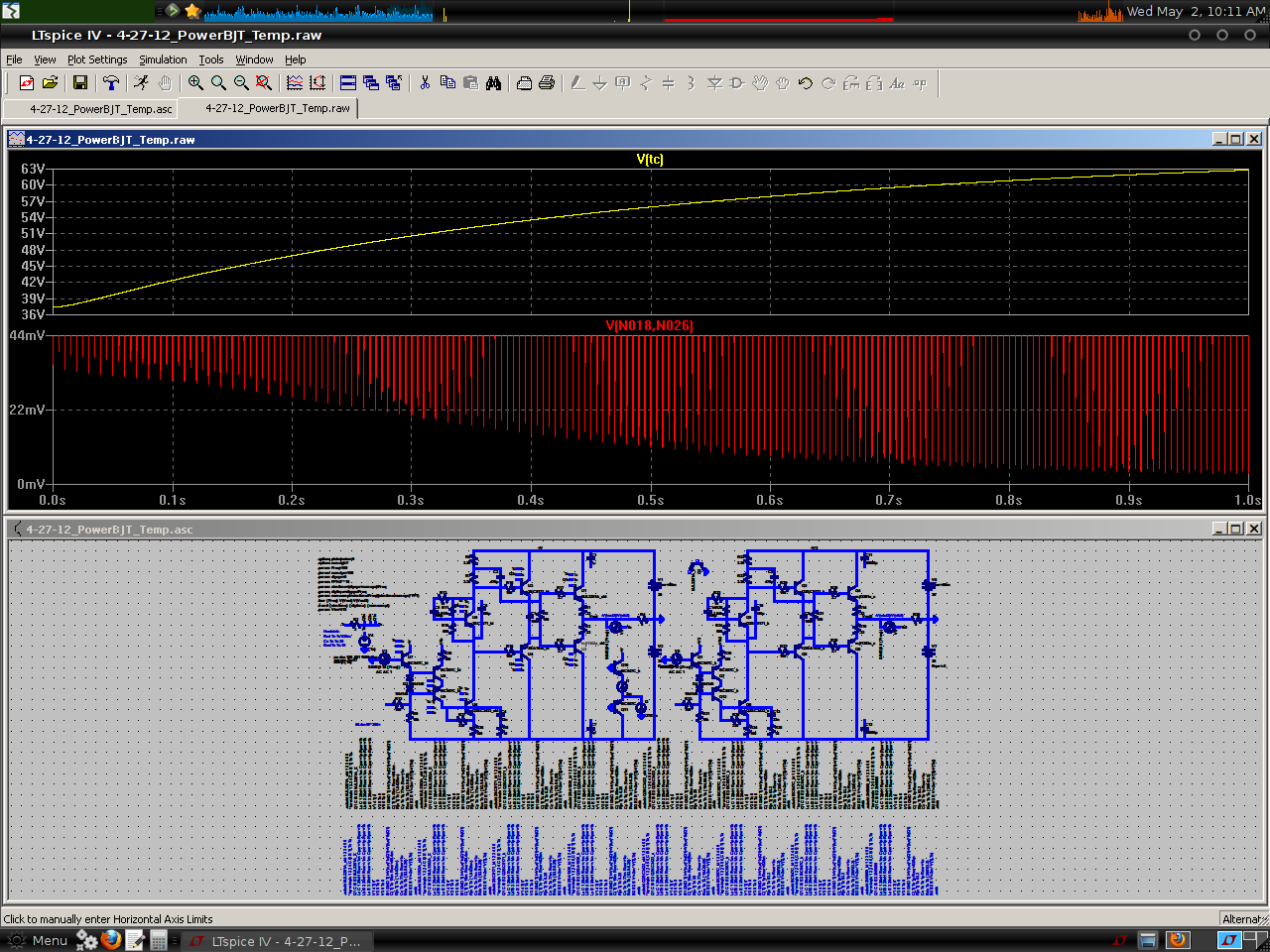

Here is a new TT amp with diamond triple OPS. All CCS are with deplation mode mosfet DN2540 and this simplified a quite this amp and 20k THD is still low as 3ppm at full power.
The question is how to make a bias current temperatute stable enough.
I simulated the case when predrivers and drivers are mounted on a separete small heat sink and suppose to canceled temperature drift in that way. The bias spreader is a small transistor not in thermal conntact with output transistors but uses two TT diodes feeding the base. R24 and R7 are trim pot used to set the bias current. I can set those two trimer and simulate output transistors temperature change and it is quite stable. This is first simulation where predrivers/drivers temperature is set to 50 degree centigrade and output transistors/TT-diodes temperature was swept from 20 to 150 degree centigrade.
Next simulation is with output tansistors set to 50 degree centigrade and predrivers/drivers temperature was swept. Here I have a problem as the bias current drift is to high not canceled as expected.
Any idea way and how to solve that?
dado

Hi keantoken,
With R18 connected as you suggest there is no difference in 20kTHD, it is exactly the same.
Your simulation picture is unreadable.
dado
dado
I did a pretty detailed analysis of this with LTspice a while back, details, models, etc. are here: http://www.diyaudio.com/forums/solid-state/151357-another-look-thermal-trak-biasing.html. This shows using behavioral voltage sources as keantoken mentions above.
Basically if you take the approach that there are two different slopes that need to be compensated - the pre-drivers plus drivers, and the final outputs, then you can compensate very well.
Thanks mightydub,
You are stepping a temperature for whole circuit and I do it for separted transistor groups, so I can simulate predriver/driver independetly of output transistors and its TT diodes.
If you look this thread a bit back you can see that I use similar Vbe multiplier.
Here, as this triple predrivers are connected in diamond connection, Vbe multiplier need to be different and that is what I tried to simulate.
I use Cordel's models too.
dadp
I haven't seen anyone else doing the simulation in real time though, as opposed to temperature operating points. It is not much harder. I've gotten the sim ready, I think it will work if you unzip all the files to the same directory, but I've been wrong before.
The subcircuits are just a more compact way of doing what could be done on the schematic with behavioral sources. There are some flaws with this thermal simulation:
1: Transistor models haven't been updated since when I first drew it.
2: Hfe tempco hasn't been implemented.
3: The heatsink has only thermal resistance, no thermal capacity. This gives an unrealistically fast time constant for the case temperature of the outputs.
4: There is no thermal resistance or capacitance between the outputs. Meh.
5: There is no way to vary the BJT temp parameter in real time so this simulation cannot benefit from accurate temperature modeling in the transistor model. This modeling must be applied manually as a subcircuit adapted for real-time simulation. It is difficult to do this without causing simulation issues.
My conclusion so far is that there is no point in simulating output bias tempco, because it's faster and less complex to build the amp and skip simulation altogether. The exception is when you're testing out different bias generator concepts, just to see if they can work at all.

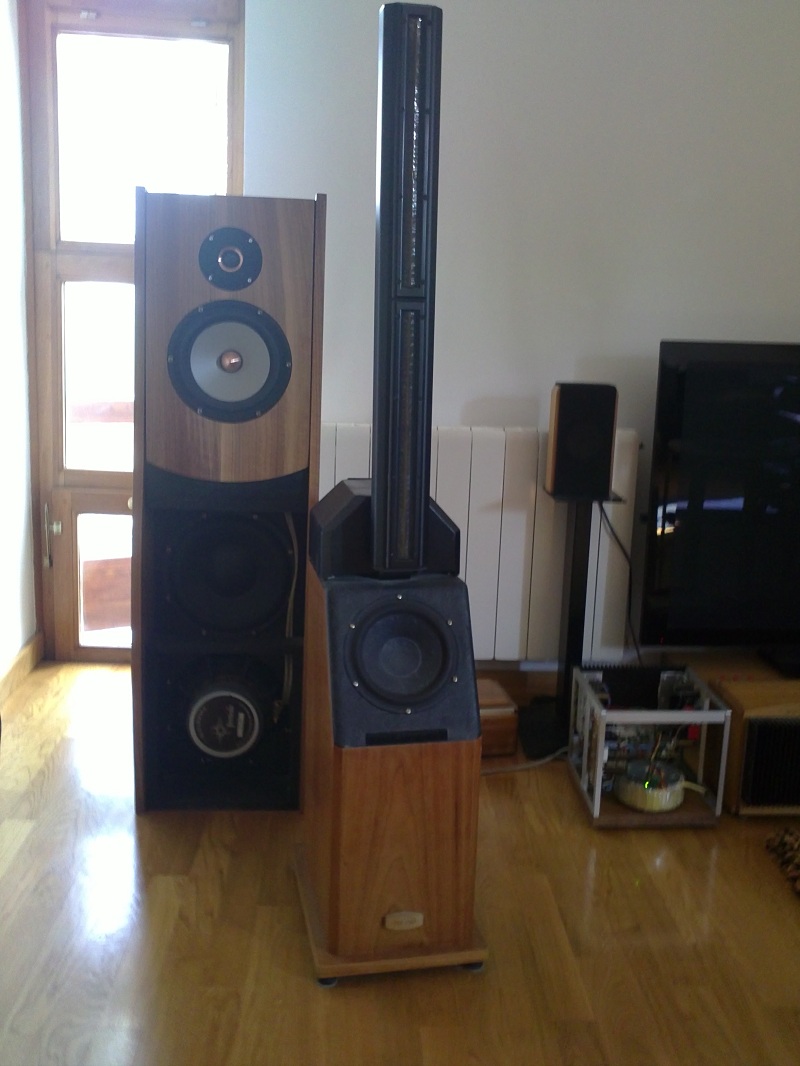

TT-Triple
After much troubleshooting, and some transistor supply problems, I finally got around to completing the amplifier. This is my first DIY amp from the ground up. Many thanks to Dado for all his help and guidance. I've learned quite a bit along the way.
The TT-Triple sounds superlative. The ThermalTrak BJTs are excellent performers, and the amp sings wonderfully. Beautiful dynamic range. Punchy bass. Wonderful highs. This amp will take center stage in my Linkwitz Pluto active speaker clone.
Here's a YouTube video of the amp playing "Regular Pleasures" by Patricia Barber on Audio Engine 2 speakers.
I also very much appreciate Dado's power supply regulator, which has built in speaker protection.

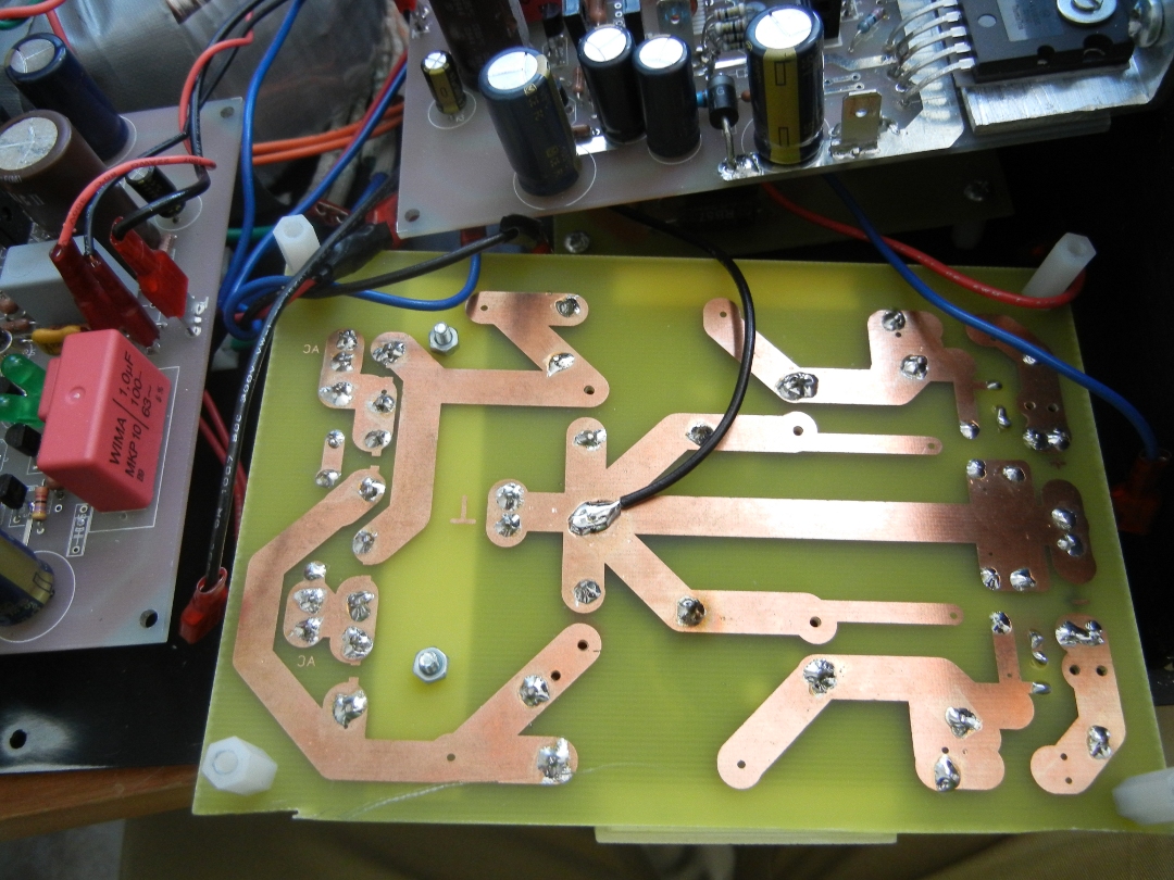

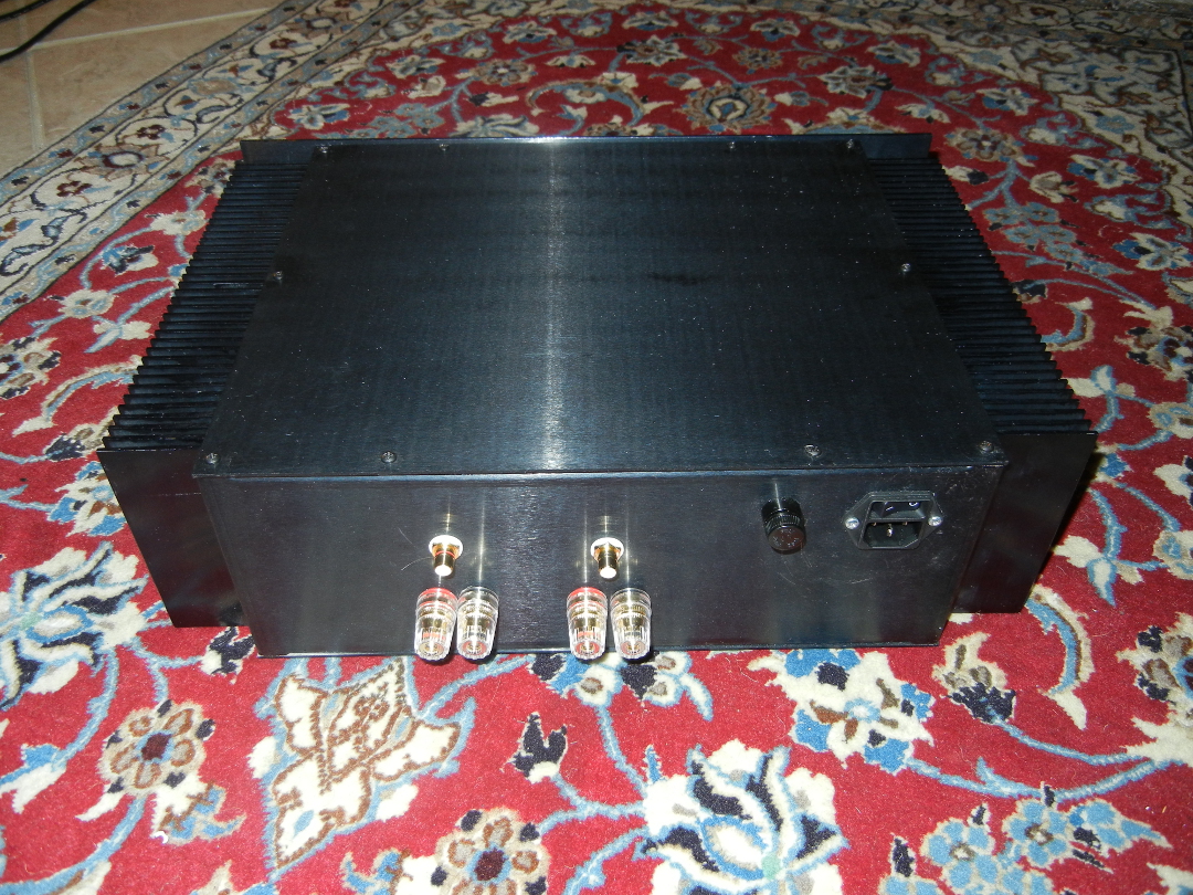

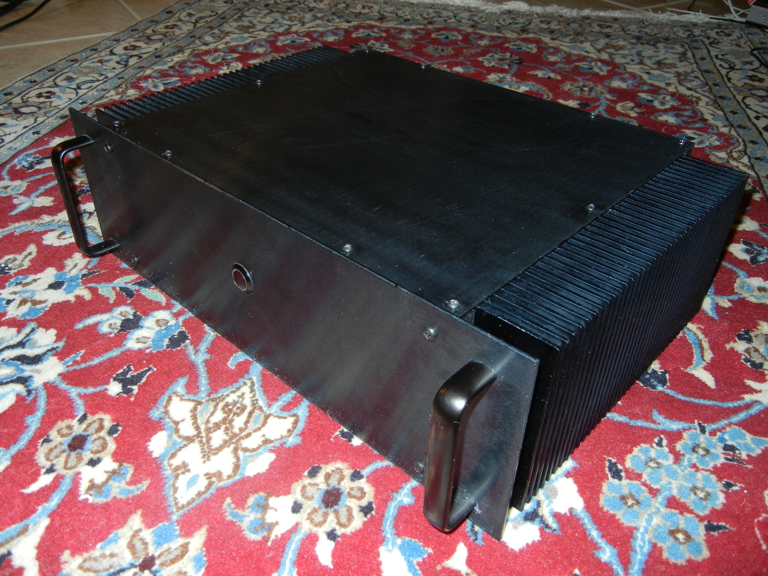

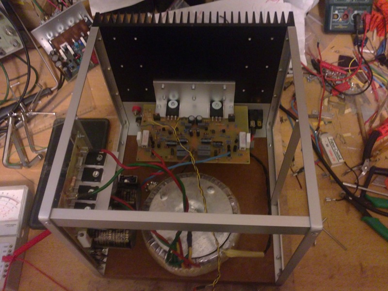

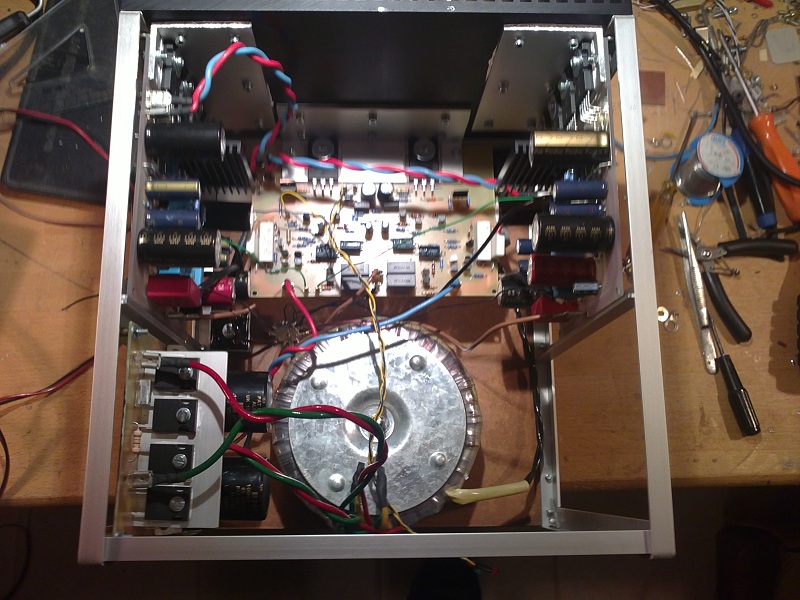

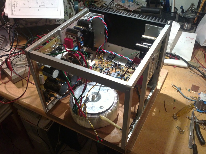

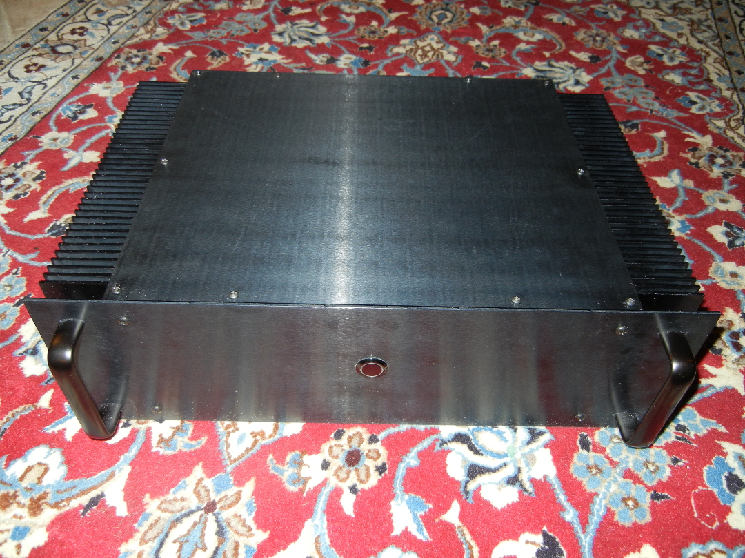

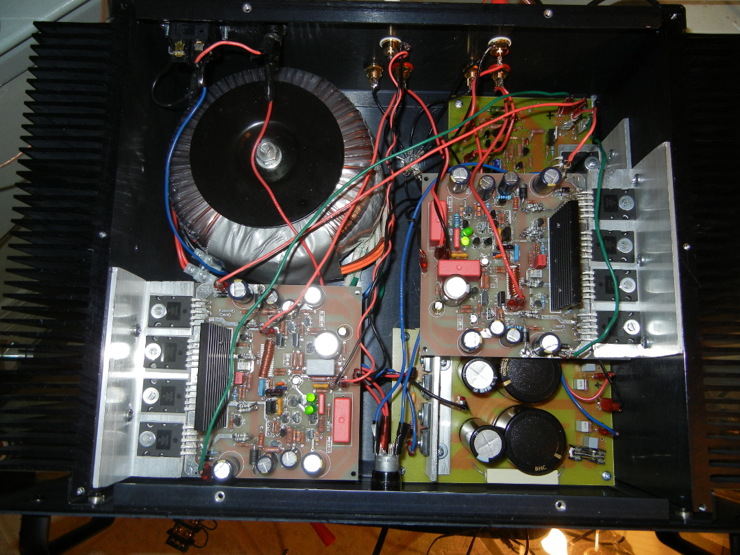

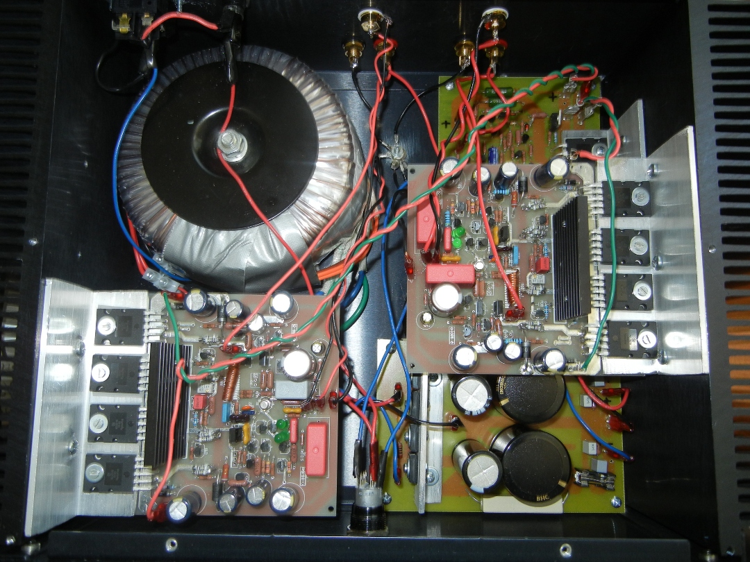

Finally done
Finally TT amp was tested and it is presented here as a complete project - I call it AudioCube. It contains Power Supply module, PS Regulator and output amplifier.
1. Power Supply module contains diodes bridge, capacitors bank and a fuses. It could be used without PS Regulator. Between first caps bank and second ones there are 0.22 10 W smutting resistors.
2. PS Regulator contains kind of a capacitor multipliers, overload/error protection and a loudspeaker protection, all in electronic way without any relay contacts.
The capacitance multiplier will drop input DC for 5 V abouth, needed to function properly. Overload protection will sense a current flowing from the + and – output and if triggered will shut down the PS regulator. There is provision for 6 A or 12 A of trigger current. The trigger is delayed and it depends of the current level an duration. If the trigger level was set for 12 A then it will start at 12.2 A and 250msec of a delay and will go up to 30A and 1.5msec of delay.
I hope this is good enough to protect all electronic connected down stream. Loudspeaker protection is copy of similar one used for JLH 80W MOSFET amp.
If one side of the power supply turn off other side is turned off instantaneously.
3. TT amp was gone prolong tests. First I tested thermal bias stability. One channel kept 18mV on one emitter resistor from moment of turn on up to hot heatsink.
I set the bias after small heatsink reached steady temperature and then I heated output heatsink with the heat gun and the temperature reached 50 degree.
Other channel behaved differently. It was undercompensated even with the same components value. I had to change R44 from 1k to 1.2K to get the same behavior as first channel. It could be different reason for it, TT diodes tempco is not consistent between TT transistors or the bias spreader transistor hfe influence the bias spreader tempco.
In attachments there are TT schematic(last and final version), PS regulator schematic, Power Supply module schematic and the grounding principle schematic.
If somebody interested to build this amp I will provide PCB layouts.

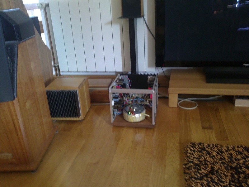

Attached some photos of built AudioCube, wooden cover is missing.
The sound – I like it very, very much, better the my modified JLH 80W MOSFET amp, or simple TMC amp with EF2 output stage. I could not compare it with commrcial amps as I have simple low power NAD integrated amp only.
dado

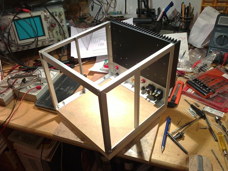

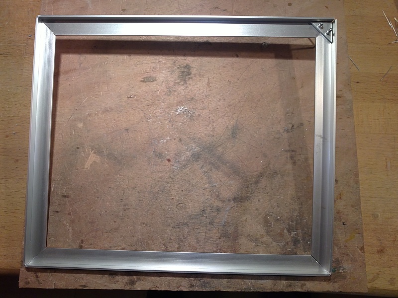

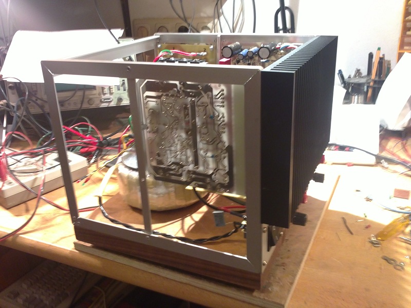

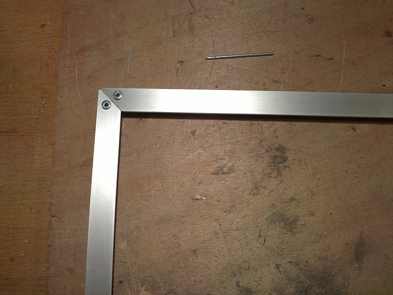

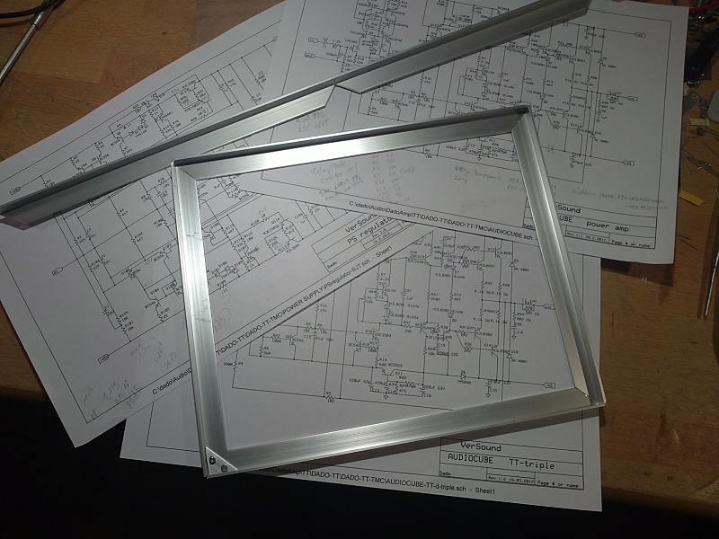

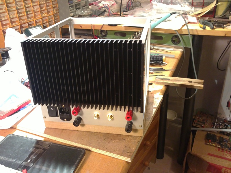

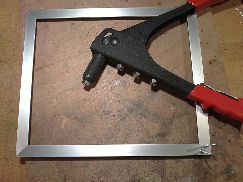

how did you make the case?
Some more photografs, I hope it is clear how from it.
dado
TT-Triple Update
1) I had the exact same problem with setting the bias correctly. One channel was stable at 18mV, but the other channel was undercompensated as you describe above. Unfortunately I burned out a power transistor by letting the emitter resistor voltage drift too high. I replaced the faulty output transistor and replaced R44 with 1.2k. The bias seems to be stable ~18mV on both channels. I also tested with my Wife's hair dryer on the external heatsink and it seems to be stable.
2) There was a very small ground loop (barely audible) that was mostly eliminated by switching the PS Regulator ground from star ground to the PSU capacitor connection point. Of course, the only bullet proof way to completely eliminate ground loops is to use balanced connections. In the case of TT-Triple (unbalanced input) I have ground loop noise 90% eliminated. I can still hear a little hum when I press my ear to the speaker and eliminate all background noise (HVAC, refrigerator, etc...) in my living space with -70dB volume. For practical purposes it's completely inaudible with any realistic input signal.
3) Occasionally the PS Regulator speaker protection will kick in for no reason and shut down the amplifier. I don't know if it's because of transients or what, but the frequency of occurrence is not consistent. Sometimes the amp stays on for 10 minutes, and other times go for an hour without fault. I need to do more testing to confirm this behavior.

Attached are photos of PS Regulator ground connection and latest internal photo.
My recent experience:First I tested thermal bias stability. One channel kept 18mV on one emitter resistor from moment of turn on up to hot heatsink. I set the bias after small heatsink reached steady temperature and then I heated output heatsink with the heat gun and the temperature reached 50 degree. Other channel behaved differently. It was undercompensated even with the same components value. I had to change R44 from 1k to 1.2K to get the same behavior as first channel.
4) Sound quality is phenomenal. The amp is completely transparent, and power dynamics are beautiful. If I close my eyes, my Linkwitz inspired Pluto speakers transport me directly into the concert hall. I love this amp.
- ThermalTrak+TMC amp
