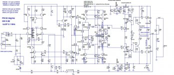

It is different from last schematic which is:

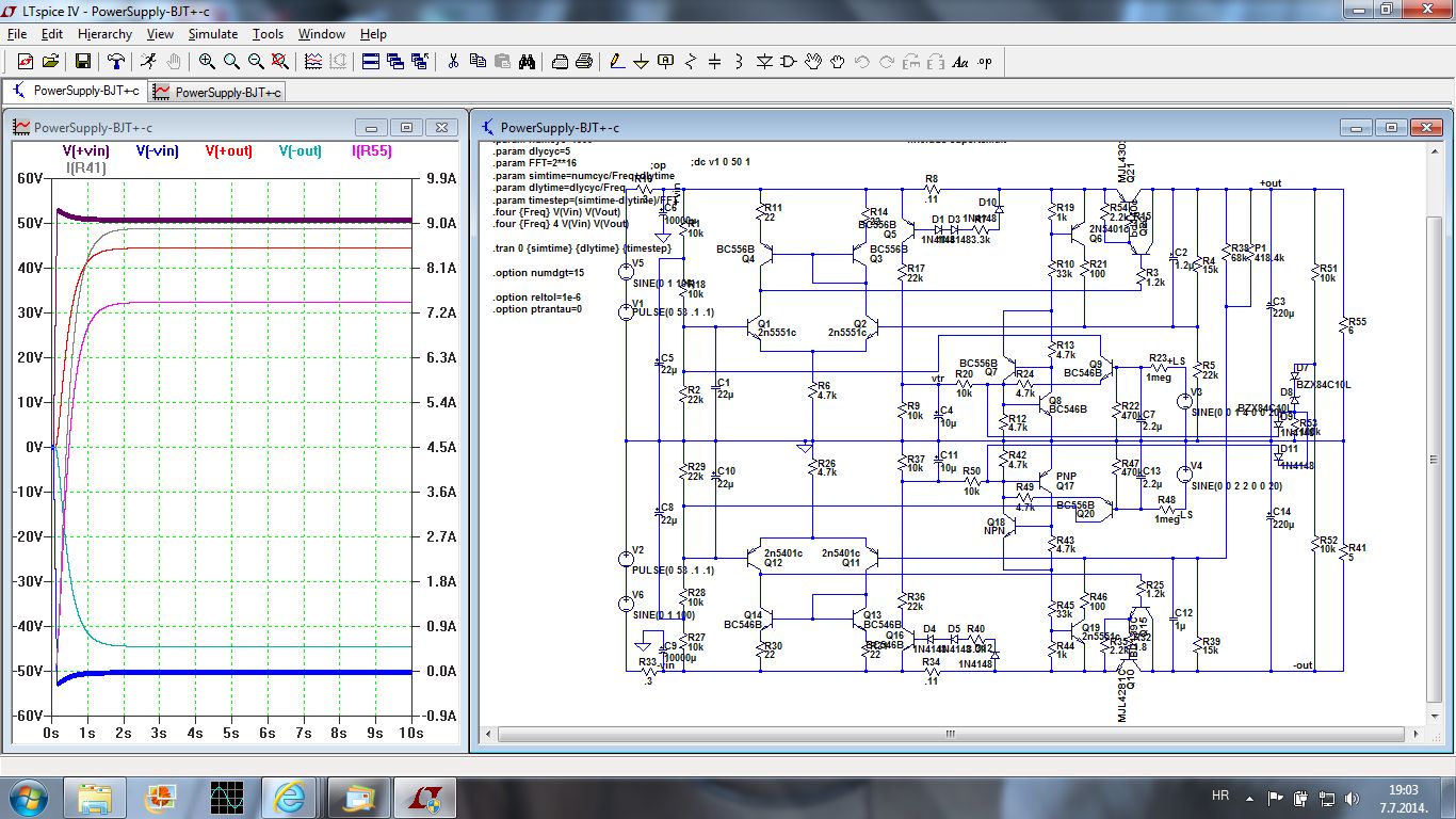

I used it to recreate the asc file but the regulator reduce from 0.0001V to 0.0020V ? I attached my asc file with the post.
I don't think it's different. You used wrong R123 value, it should be 68k parallel with 1 Mega trimer not 22k. Just use .asc file I've sent. It should looks as attached picture.
Thanks! I found my problem which is R123 should look like yours and must connect to R23. After changed, anything worked like it should be.

Whit that trimpot you adjust negative output voltage to be equal to the positive output voltage.

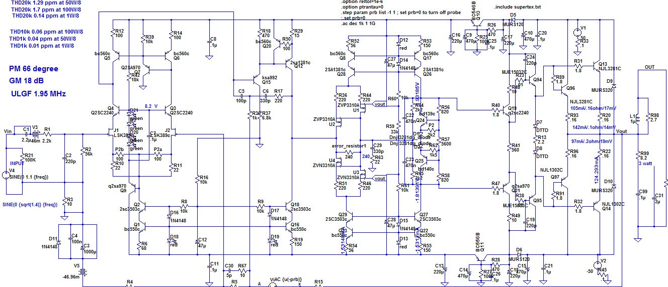

TT amp with EC

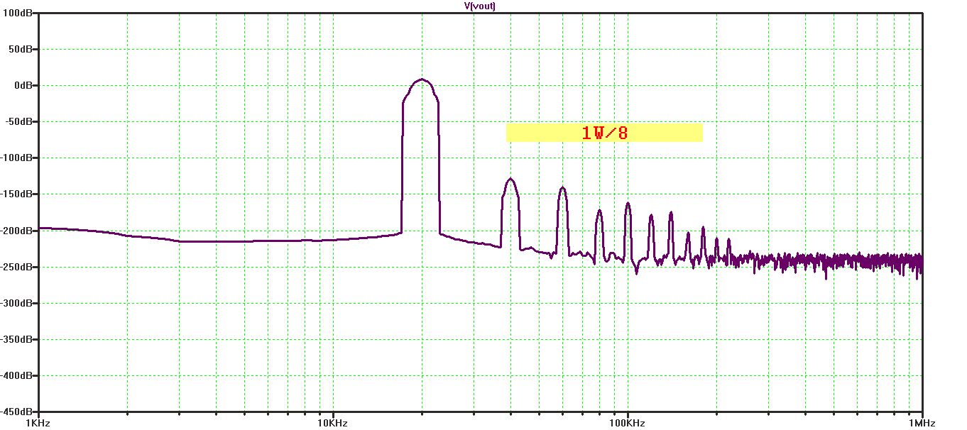

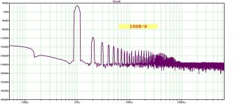

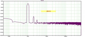

I could not to resist to try simulate this TT amp with the Error Correction circuit by Sergio (smms). I did some improvement and simplification (DN2535 replaced with a resistor).

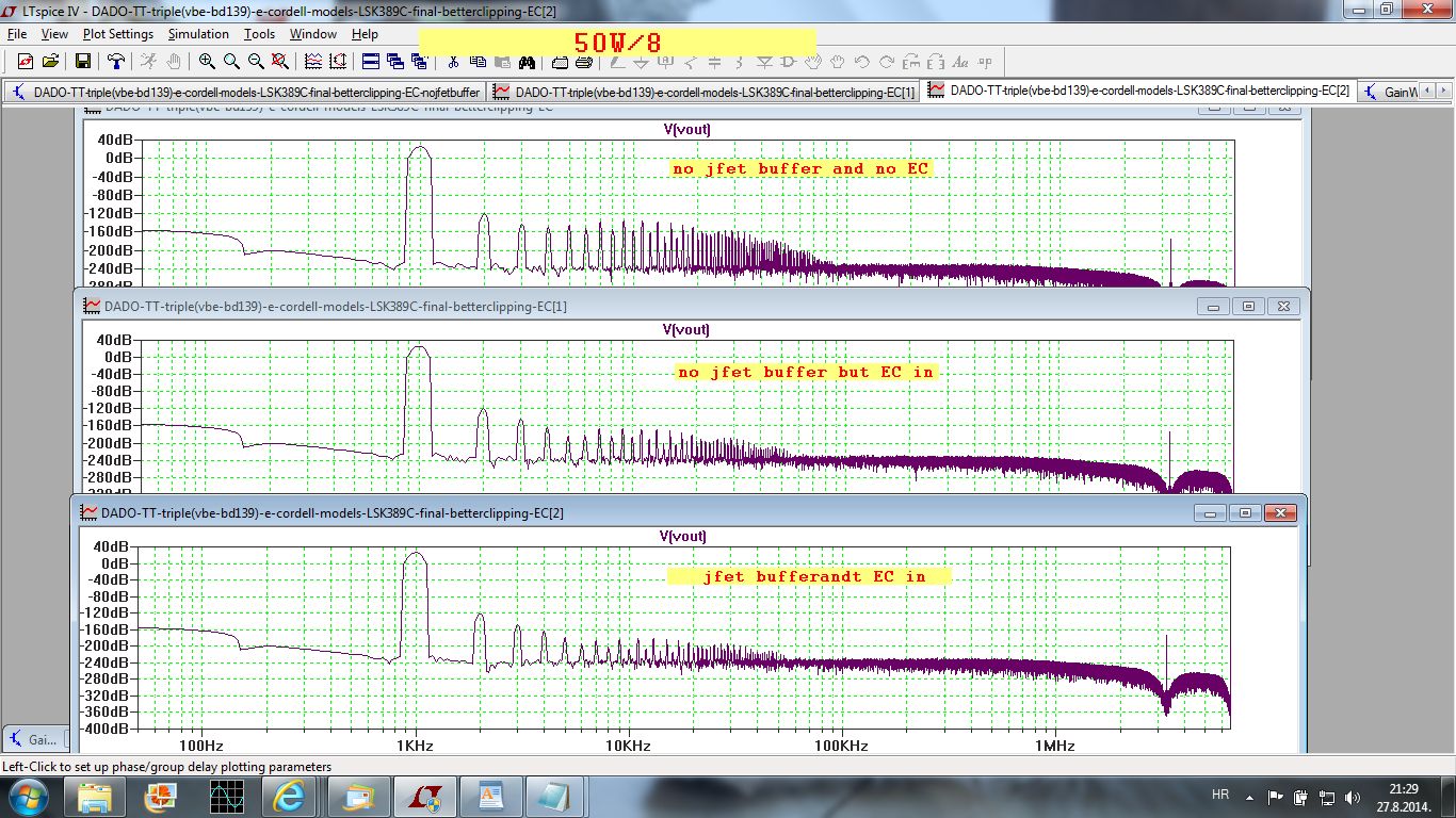

Simulation results are impressive (it will need some more improvement in GM).
THD20 is just 1 ppm at 50W/8 ohm, and THD1 is 0.04 ppm at 50W/8 ohm. At 1W both THDs are vanishing low.
BR Damir

🙂 very good.

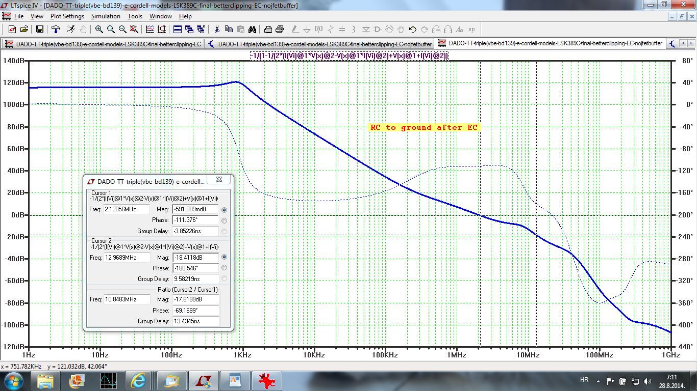

try without the jfet/DN2535 buffer , and put the c29/R63 in parallel with the error resistor to increase the open loop phase margin.

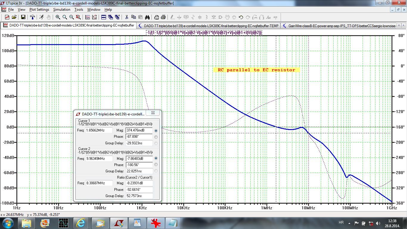

Phase Margin lost completely with RC (C29/R63) parallel to the error resistor, so I put it back as shunt compensation, but without jfet/DN2540 phase margin improved a bit and the gain margin improved a lot.

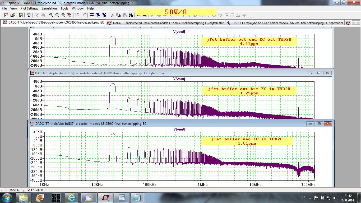

Interesting thing is that the distortion did not suffered a lot without jfet buffer, THD1k increased from 0.04 ppm to 0.05 ppm and THD20k from 1.01 ppm to 1.29ppm.
Most interesting thing is that even without the EC distortion of this amp is very very low and EC did not lower so much distortion as it improved distortion harmonic distribution, by killing nasty OPS distortion.
I see it as the main gain here.

ps. Sergio how do you explain that removing the jfet buffer did not influenced to much functioning the EC, as this EC asks for low source impedance? I would explain that with the VAS output impedance falls with a frequency and those the EC works better at higher frequencies.
is strange that the phase margin don't improve with the EC compensation as I advice,
you have to change the miller capacitor value or increase R10/R11 (did you try that?).
The error correction only affect the output stage, and can only diminish distortion created in the output stage, It means that if you want even lower distortion you have to change your input stage, but I do not see the need as your distortion is already very low, and as you said the nasty crossover distortions are improved thanks to the EC.
You dont need the jfet buffer because The output of the VAS stage is only high impedance in open loop, inside a feedback loop the output impedance of the VAS is very low.
PS: Try making the same THD test with lower load resistor like 2R , the differences of the EC vs no EC should be more visible at difficult loads.

Sorry for delayed response, I have to look after my grandson those two weeks and no much time for my hobbies left.
I was, probably, not clear with my explanation about shunt compensation after the EC and the compensation parallel to the EC resistor. The PM really improved but a peak showed at about 8MHz and GM was practically not existent. I tried to increase the LTP source resistors( from 18R to 100R) and that improved a bit but not enough, any capacitive load make the amp unstable. I tried to manipulate the TMC and came close, but final result never reached the shunt compensation.
Attached, last schematic, LG of that, and LG with the compensation parallel to the EC resistor to demonstrate what I mean.

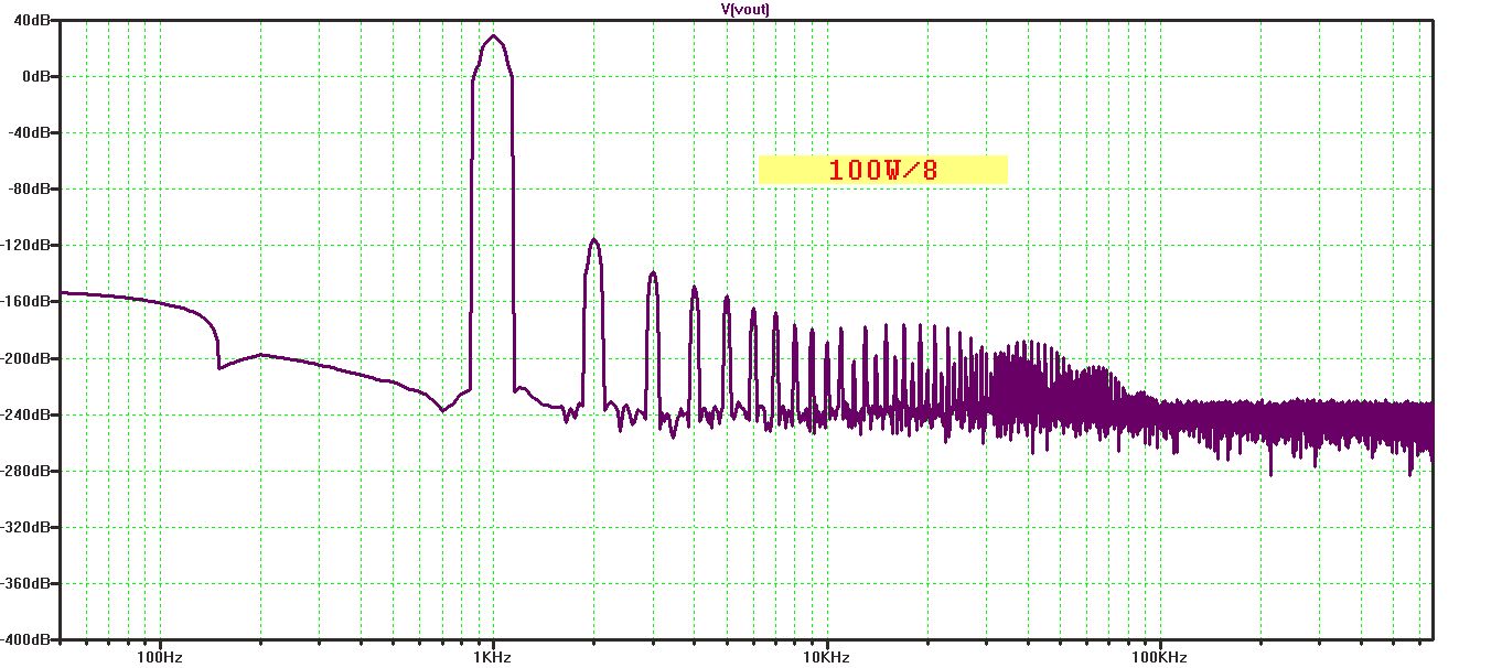

The lower load of 2 ohm really shows the effectiveness of the EC. THD20k for 8 ohm was improved from (EC off) 4.41 ppm to (EC on) 1.29 ppm and for 2 ohm from 8.47 ppm to 1.53 ppm.
