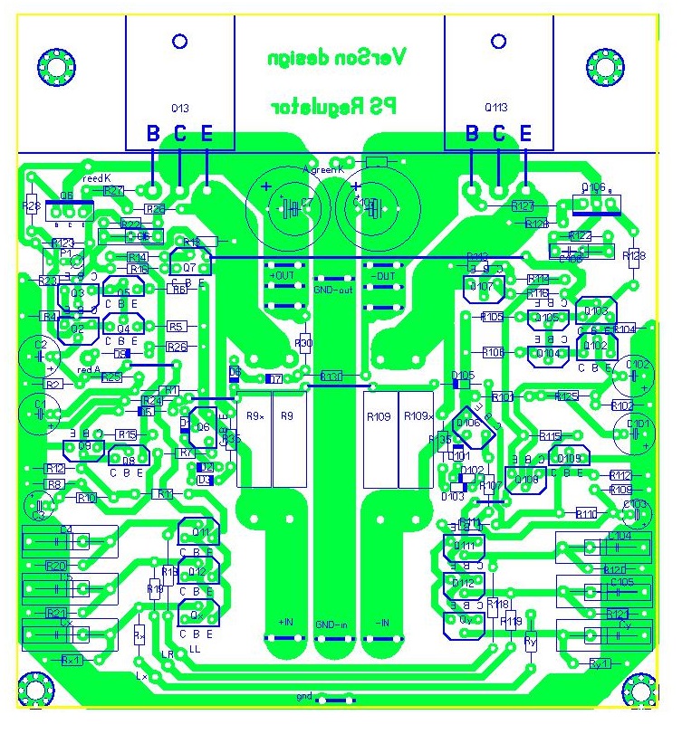

Improved version of the regulator, with correct layout.
Could you upload the component layout file for this PSU? I want to build it in my amp which use +/-54V right now. With the regulator it will be +/- 49V and still work well. Thanks!
Tell me what do you need exactly, the layout, pdf file for a transfer or photo to make the PCB, BOM?
Thanks,
I want to have the layout, pdf file for a transfer. Other thing like schematic and BOM, I already got them from this thread.
Thanks,
OK, here it is.
OK, here it is.

This PS regulator was designed for my three channels amp, so if you are going to use it for a stereo(two channels) then you don't need to assemble all components with designation x and y, those are for third channels DC offset sensing.
I appreciate if you report back your result with this PS regulator.
Damir

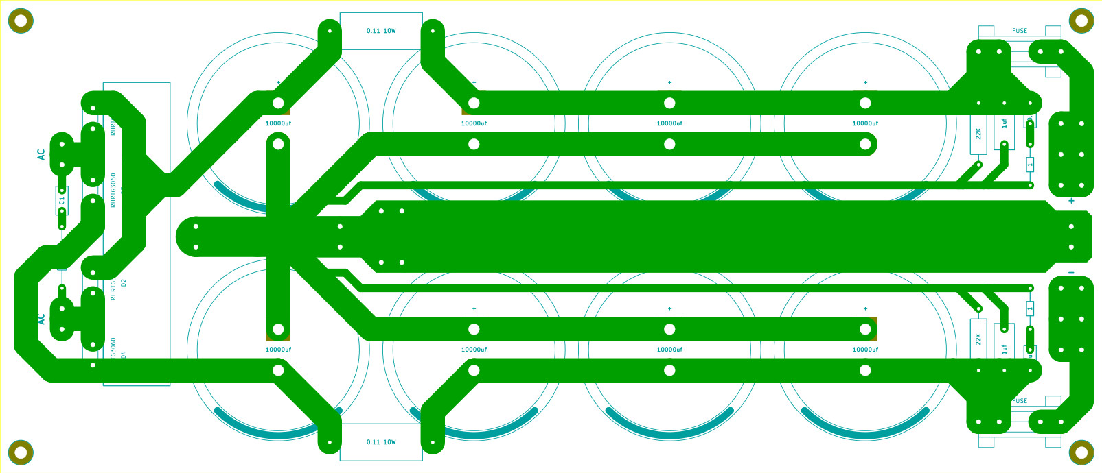

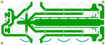

I'd like to use your PSU design, too. But too bad, my big caps won't fit it. SO I goes through a hard way and try to copy your layout to make it fit my cap (is it ok)? I will use 4 x 10000uf / 63V in each pos and neg rail.
But in your PSU, I found a strange resistor after the big 20000uf (not in schematic)? I think it is bleeder resistor? And I calculate it for 10ma -> ~5K. Is it right?
I also run the LTSpice with the PU regulator (55V input), all caps seem only need < 50V rating base on voltage on both lead?
After that. I will make the board and try to fetch components on the same time.
Yes, you've got it all correctly, just use 1 W bleeder resistor.
Just one more thing, when you test the PS regulator use external bleeder resistors of, let's say, 500 ohm 10 W, PS regulator won't show correct values with no load. I suppose you will test the PS regulator first with no amp connected.

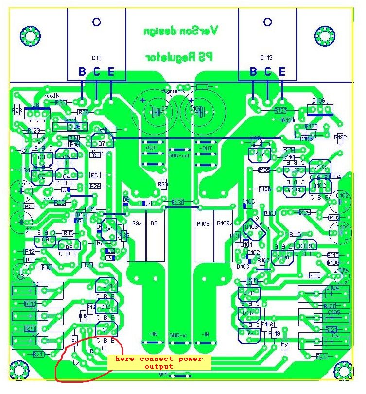

Based on another thread about this PS Regulated, you told it could:
- electronic fuse triggered with delay depend on the current level (shorter for higher currents)
- loudspeaker electronic protection
I can understand the first thing but the second thing "loudspeaker electronic protection", how is it working? Could it replace decade speaker protection function?
It protects against power amp output DC offset. In the attached PCB you can see where to connect power outputs, and in the case DC offset the PS regulator will detect it and switch off, but not on audio signals. It reacts on below 1 Hz.
I don't know what is decade speaker protection function, but you don't need any other type loudspeaker protection.
