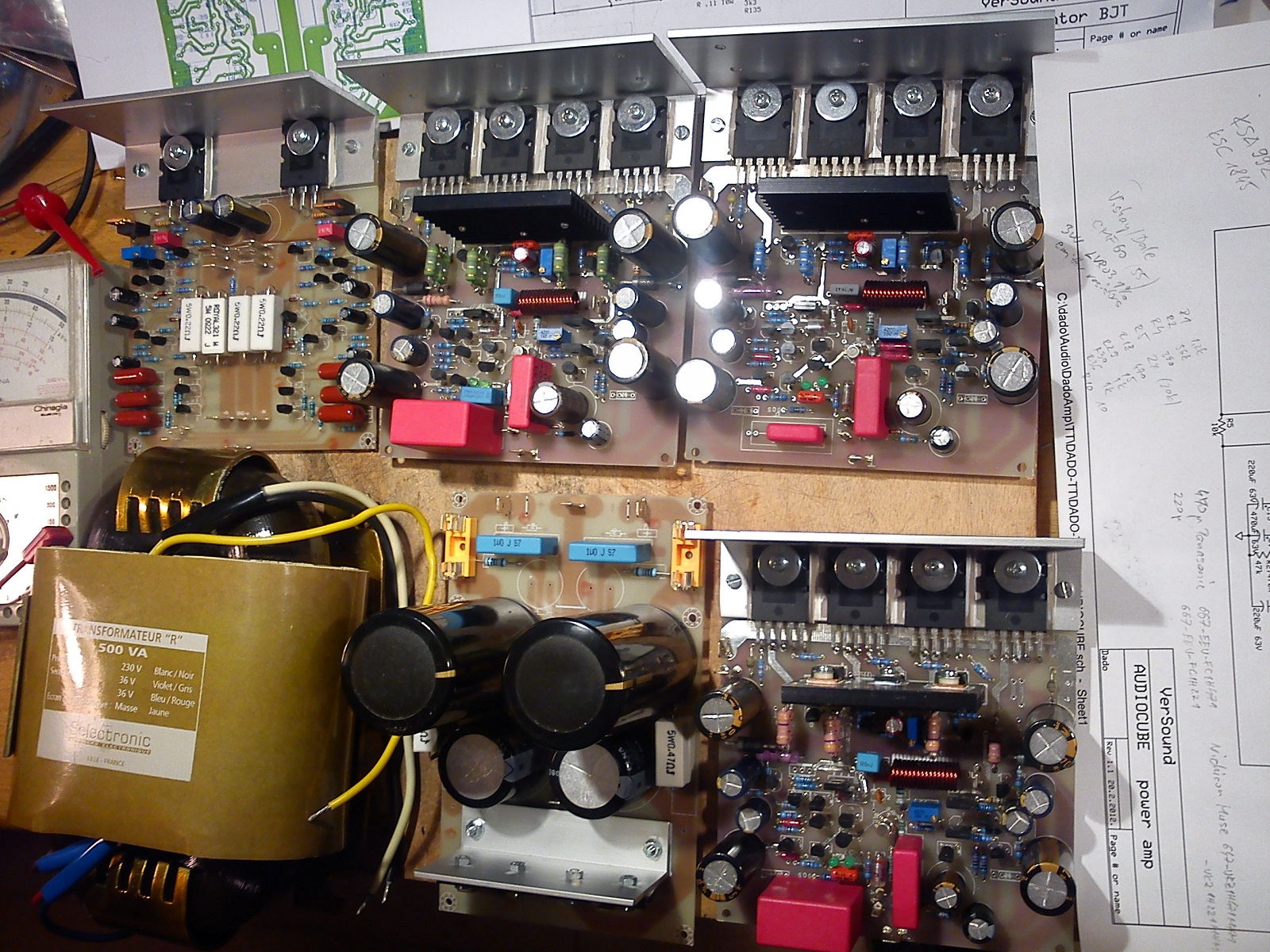

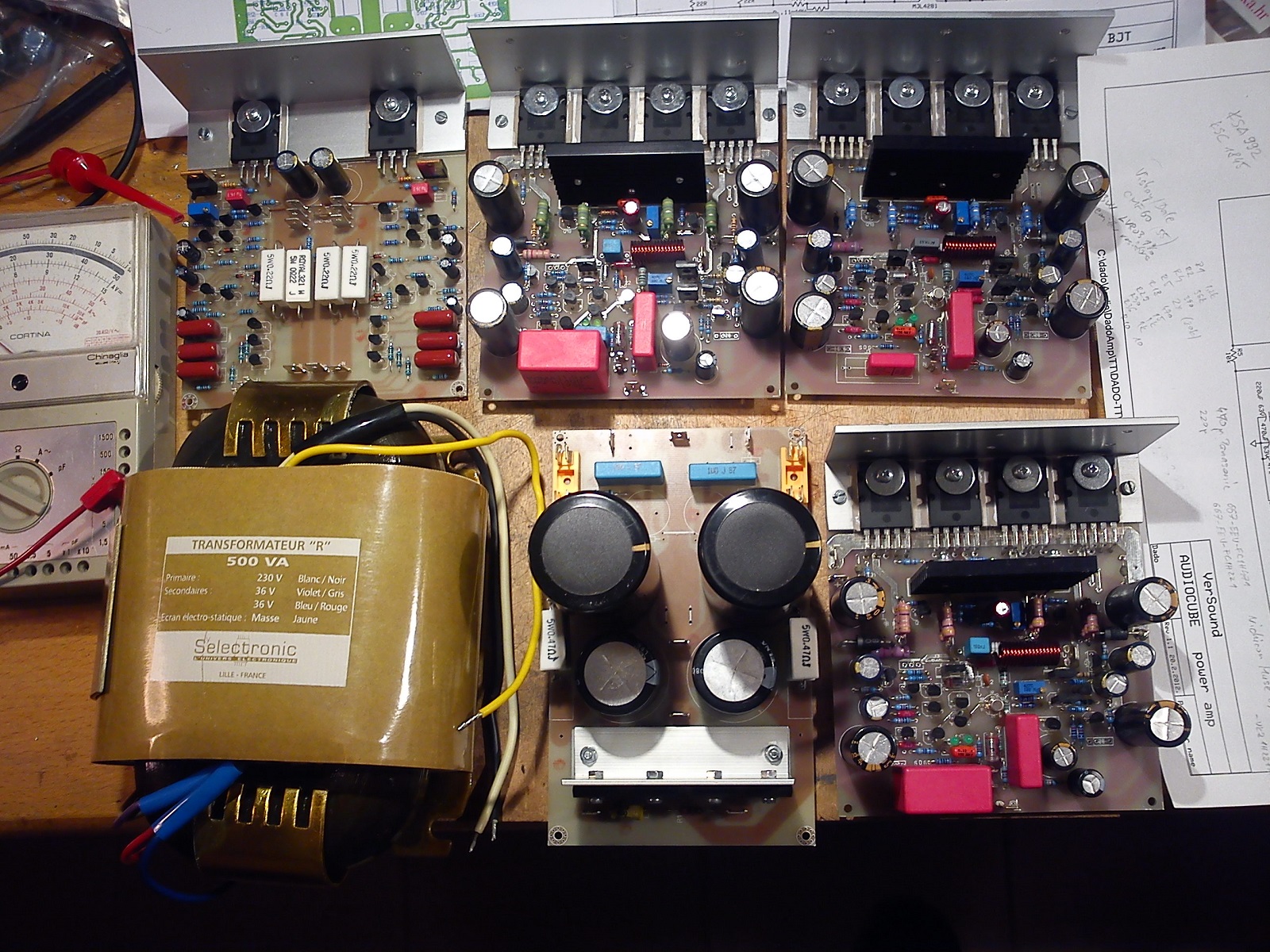

Finally I have all needed parts to start to assemble my two box TT amps to drive Orion loudspeakers. This is just for one Orion, three power amps with power supply.

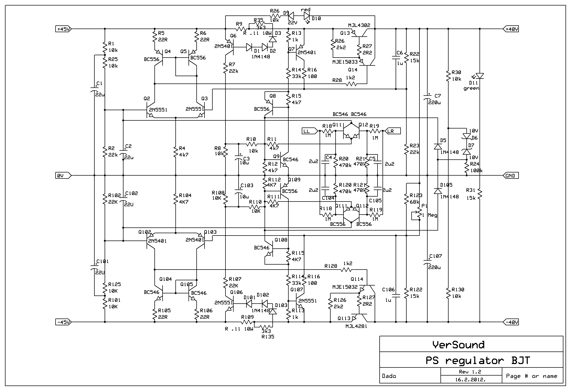

Hi dear Damir ,can you tell me the max current this power-protection supply can produce?
Thimios.
Hi Thimios
As showed in the schematic, about 12 A, the current sensing resistors R9 and R109 are made from two parallel 0.22R 5 W resistors. The trick is that that the max current is a transient dependent, shorter the current pulse higher is the current trigger point. If I remember correctly my simulation(it was two years ago) the trigger point varies from 10 to 15 A, higher for shorter pulse. As the voltage drop on the serial transistor is about 6 V, it's easy to calculate dissipated power on that transistor at different currents. Average power dissipation in the PS regulator is quite low, except if listening rock music very loud prolong period.
Current limit could be easily changed by changing the value of the sensing current resistors.
