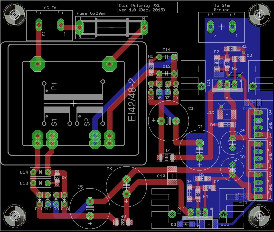

If you can see something that could be done better with the layout then that would be good feedback - but to me it looks fine for handling rectifier pulses, given the middle-of-the-road noise application.
Which of those aren't done on the board? Showing the schematic as one would route the board is often impractical. Andrew would have On Semi redraw their data sheet circuit diagrams including Fig 20. The guidance with respect to routing the board is relevant; the demands with respect to the schematic seem to be just argumentative.

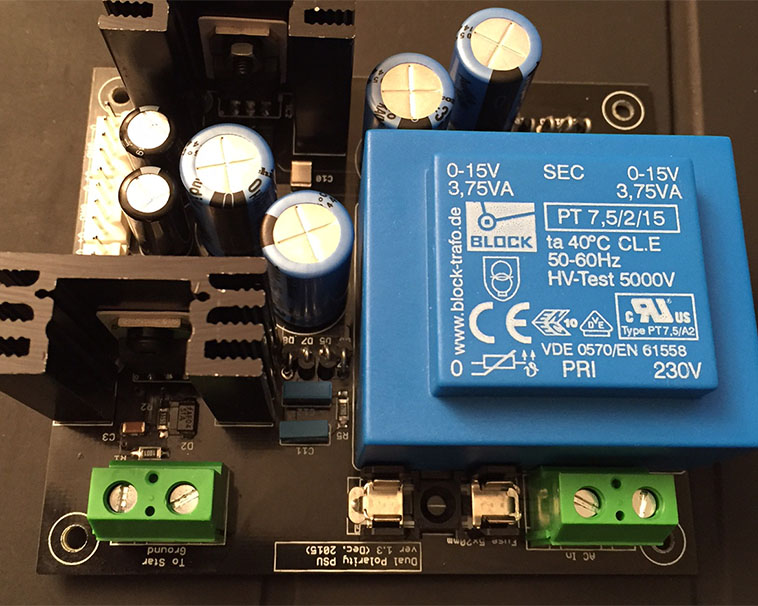

Just arrived...
Yes I ticked black for a bit of a laugh. It matches one of my passports and the kit of my favourite sports team.
I haven't taken a close look at the quality yet. Manufactured by pcbway and had them within 5 days of sending the order.

FYI I don't like how cramped things were between the E48 size transformer and the heatsink to the right of it when I was making up the first board. (See attached.) Stuff fits, but it is very tight and unnecessarily so as the board was 80x95mm and I had a further 5mm of width available while still staying within the freeware board size constraint of Eagle. Silly. The boards would have cost the same to manufacture also. (And I purchased a Eagle Make Personal license and so no longer face such a tight board dimension constraint.)
So I have done a revised version adding the 5mm of width back and spacing out the diodes a bit more. I still think the first version is technically ok although I have not had the chance to plug it in and test it yet though.

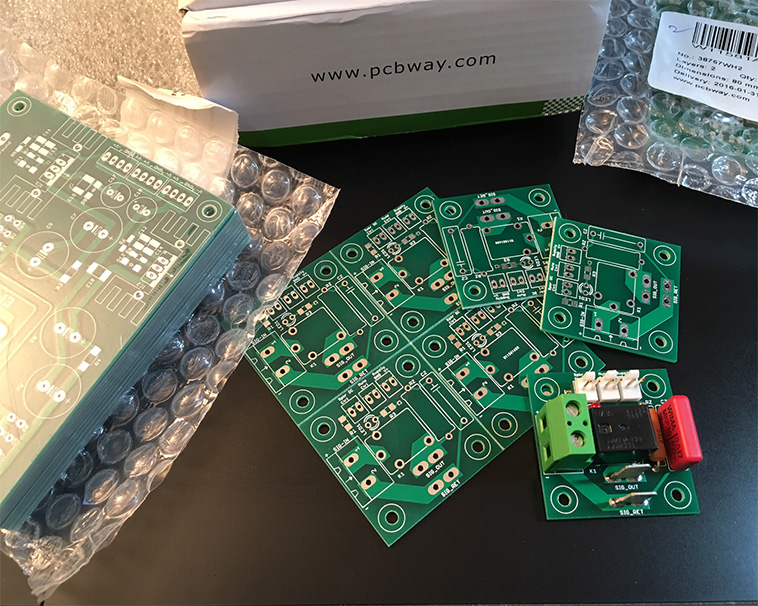

I placed an order for a slightly revised version of this PCB last Thursday. The same day I sent them another PCB which is an output relay board for an amplifier project I am working on.
These were my second and third PCBs from them. The output relay PCB was my first attempt at panellising and requesting a PCB manufacturer to add v-scores to the panel. (I added the following instructions in my order request in the relevant box in the order submission process via their website: V score along both horizontal and vertical lines on top silk. Web = 0.005")
I made a mistake uploading one of the folders of Gerber files and missed the drill file. Erin from customer service/sales sent me an email explaining my mistake and all was solved with a simple reload of the folder via their website. Very good service.
All the boards arrived today - just 4 working days later - via DHL courier. Packaging was excellent and the boards seem to be of very high quality again. All the boards were 2 layer, 1oz copper. Pricing frankly could not be much better. The ten 8x10cm PSU boards cost $13. The ten 8x8cm panels of four 4x4cm output relay boards cost $25, the extra cost because it was a panel. If boards are less than 10x10cm the cost is the same for 5 or 10 boards.
Shipping via DHL was $36 for the combined order and I had to cover Paypal fees of $4 less a $1 credit. (I did have to pay £20 to DHL for VAT and their handling of the VAT payment - so annoying to pay a £10 handling fee to pay £10 in tax to the government. Very efficient.)
Separating the panel was absolutely easy - they easily snapped along the v-score with modest pressure. One could simply leave the snapped PCB as is thereafter but I gave the edges a quick rub with a sanding block.
From my experience I would certainly recommend their service.
