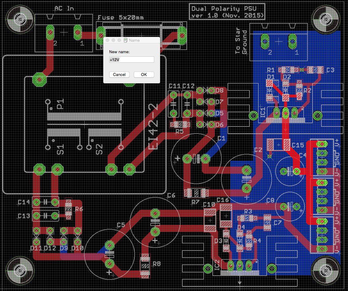

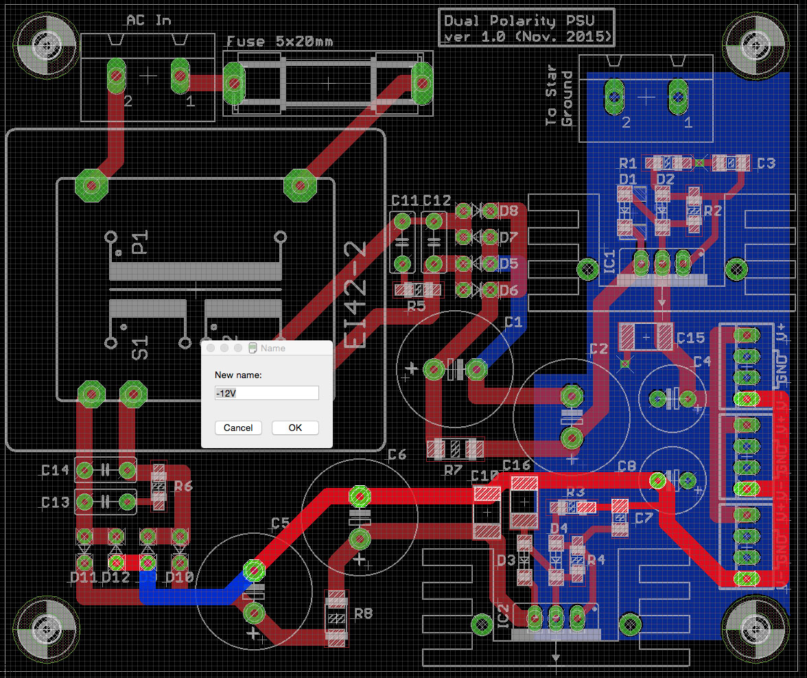

Which line exactly? -12V, +12V, GND or some other one?
Attached images highlight traces for each of these. -12V is about as efficient as it can get given size of transformer, heatsink and output connectors. The series of traces from the +12V bridge to output are forced by virtue of the same. (As noted above, if the snubber circuits simplify to just a single resistor then there's some further optimisation available.) GND/0V has to connect in numerous places - the low side of the positive regulator, the output of the -12V LM317 and the high side of all that follows, and the connector to star ground. Routing this as a series of traces would be spaghetti. Is it not sensible to use a GND plane for this?
You've lost me completely. The schematic is the same as any other I have seen using this typology including discussions on this forum in which you have participated. I realise I have omitted the protection diodes shown as D9 and D10 in Fig 11 here. This is a mistake and I will add them. I will search for potentially suitable components. Do they make the existing D1 and D3 redundant? I am missing any other issues with the schematic other than the following which could be emphasised by changes to the schematic (although the effective schematic would be unchanged).
With respect to the board, I guess we can debate where to take the input to the Adj voltage dividers R2/R1 and R4/R3 respectively. Trobbins suggested moving the low side of the latter to the -ve terminal of C8 and I did this (i.e. low side of R3 senses -12V at, or rather just past, the neg reg output cap C8).
Perhaps, in like fashion, I should have R2 sense +12V at the pos reg output cap C4 or the trace to the output connectors which is closer? When I have previously looked at just single positive regulators no one (including yourself when you have assisted in these) has raised this point but if it is good practice I'm happy to run with that from now on.
In both cases the other side of the voltage divider is 0V GND. R1 connects to GND as does R4. Routing GND would be very difficult. Do you object to the use of a plane for 0V GND in this situation?
(Latest version of board attached.)

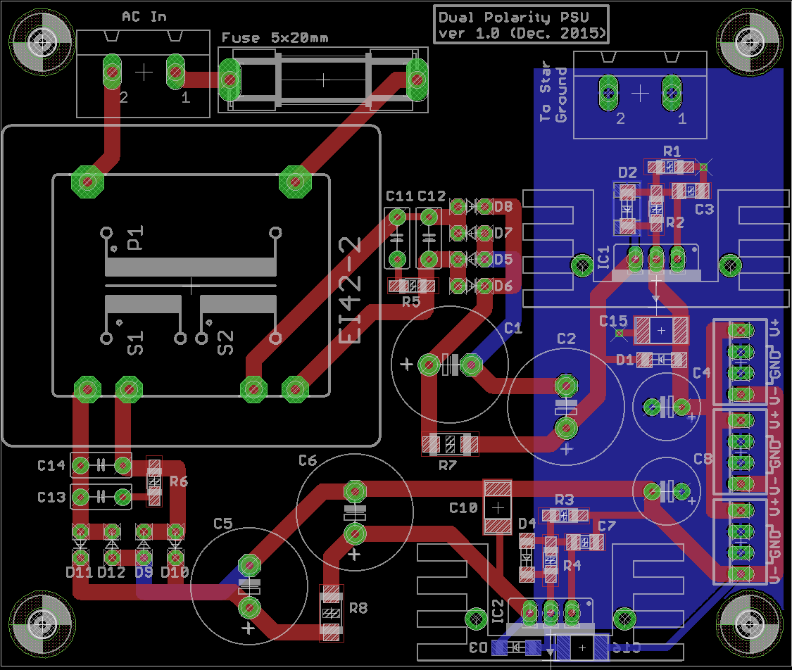

I'm wondering if Panasonic DB2441700L (data sheet) would be a suitable choice. Rated for 5A and 40V and conveniently small. The LM317T-DG (data sheet) limits at a maximum of 2.2A. Mark has previously provided guidance for such protection diodes here.
I suggest that those diodes should be rated for a current at least equal to the larger of (i) (Vprimary/Vsecondary)*Primary_fuse_current ; (ii) the current rating of the downstream fuses in the DC rails ; (iii) the output current limit value of the voltage regulators
I have made this change but have stuck with the 0V GND plane for now...

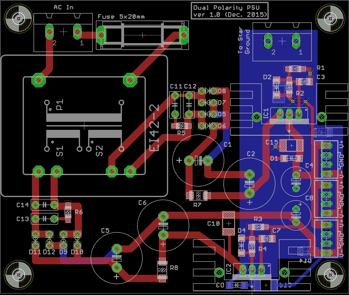

Thanks trobbins. Images of current versions are attached. I will report back when I have received the transformers and have had the chance to connect them to my Quasimodo jig.
In the interim I will work on the balanced line input board (balanced to single-ended conversion) which is one of the things that will be powered by this supply.
Hi SGK,
You have a problem with the red traces passing under the heat sinks. If solder mask gets scratched you can short them. You can of course lift the heat sinks using spacers but it is better to reroute the traces, IMO.
Oleg
Oleg
Hi. Generally I agree but in this case I will rely on pvc spacers. If I can minimise traces under the sinks I will but so far I have found some unavoidable without resorting to carving up the bottom layer which I don't want to do.
It is easily avoidable with the -12V reg. On the +12V, I would have to rotate the heatsink and move it up. The traces from C2 to IC1 would be longer. Is it worth the hassle and this cost if spacers are going to be used?
I guess the length of power traces from the filter cap to the reg is not so critical, at least datasheet does not specify max distance as far as I remember. It only recommends 0.1 uF bypass close to the reg. But may be someone more experienced could recommend the right solution.

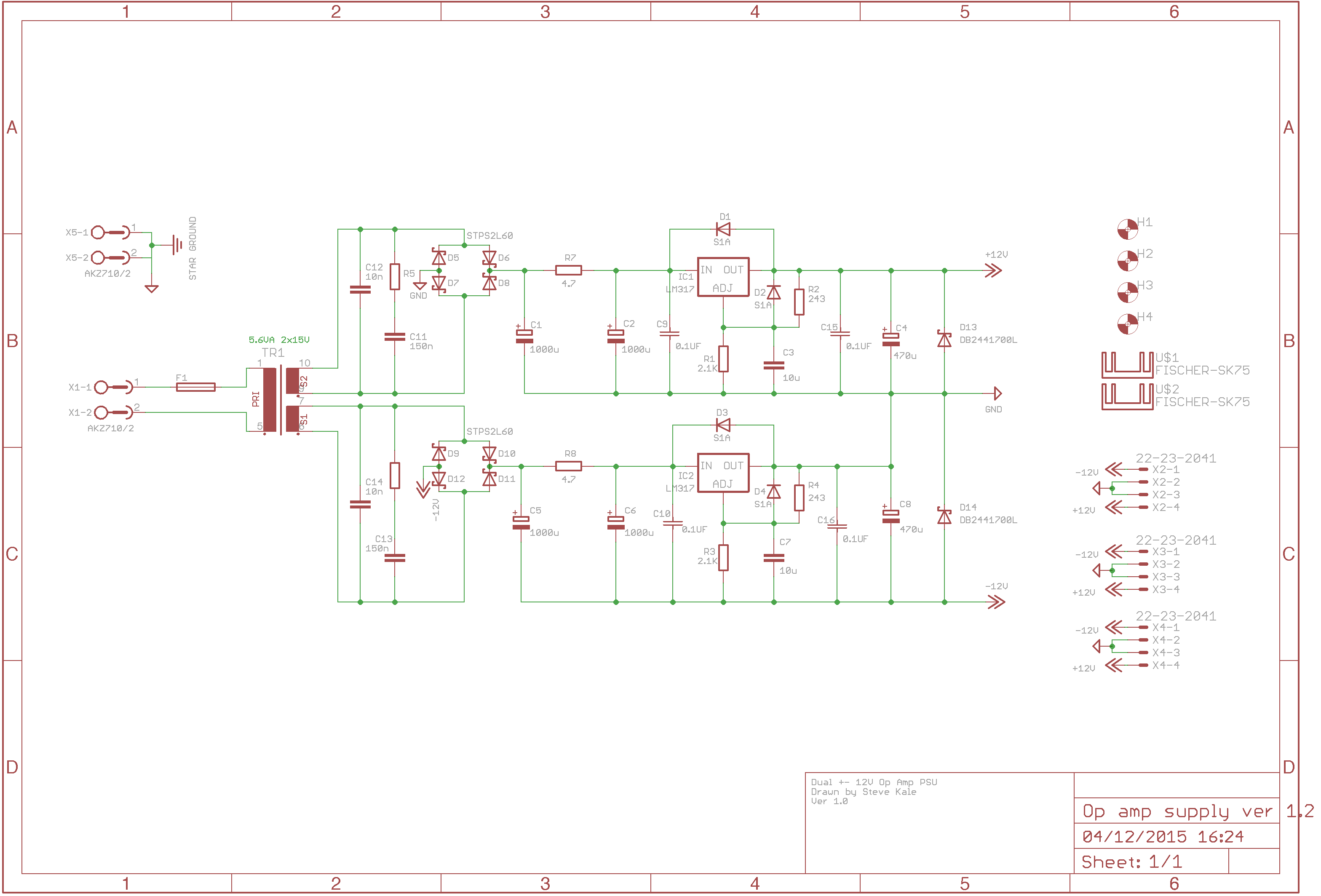

No !
the rectifier has TWO outputs. Those two outputs are a close coupled PAIR of wires/traces.
These MUST connect to the INPUT of the smoothing capacitors. DO NOT separate these two wires/traces to take ONE on a big separate journey around the PCB/Amplifier. That creates LOOP AREA and that creates INTERFERENCE !
The wire from the -ve sides of D5 & D7 must follow the wire from the +ve sides of D6 & D8 to feed to two terminals of C1. This is a TWO wire charging circuit. The charging PULSES must not be imposed on any other circuit.
Get the sch right first. Then design the layout to match the corrected sch.
I can only think that Andrew is trying to push for a schematic that shows how the node busses are
It does. And the pair go on to C2. By necessity, the trace from D5/D7 to -ve terminal of C1 is on the bottom layer (because it must cross the trace from D8/D6 to C1).Intentionally it is kept very separate from the GND plane all the way to C2 so that the pulses circulate locally. Exact same thing with the other regulator and C5/C6.
The sch shows GND at the rectifier and at the Output end of Zero Volts.It does. .............
The sch also shows -12v at the rectifier and at the Output end of -ve supply !
It does NOT .
Correct. The +ve reg rail has its bridge connected to input of IC1 LM317 (via the input filter C1/R7/C2) and GND/0V. The -ve reg rail has its bridge connected to input to the input of the second LM317 (IC2) and what becomes -12V. The schematic is in accordance with the typology shown here
Voltage And Current Regulators
Two positive regulator circuits with the 'output' of one tied to GND/0V of the other to produce -V. If it helps I can rearrange the diodes to make them look more similar but I assure you the connections are exactly the same.
So the schematic shows +12V from IC1, GND at the 'low side' of the +ve reg rail and what would normally be the output of the neg reg rail, and -12V at the 'low side' of the second reg rail.
The output connectors obviously have connections for +12V, -12V and 0V.
I can only think that Andrew is objecting to my 'shortcut' in the schematic - highlighted in the attached. Rather than showing a direct connection to C1 from the bridge I showed a connection to GND/0V. This might convey a degree of routing flexibility to a reader which, of course, one shouldn't deploy. A glance at the board would show the direct connection from bridge to filter caps has been routed properly. The reason why I have been reluctant (lazy?) to redraw the schematic is because in order to make it neat (reconfigured) I have to delete connections on the schematic and redraw them, forcing me to reroute the board - even though the traces would be identical in the end.
