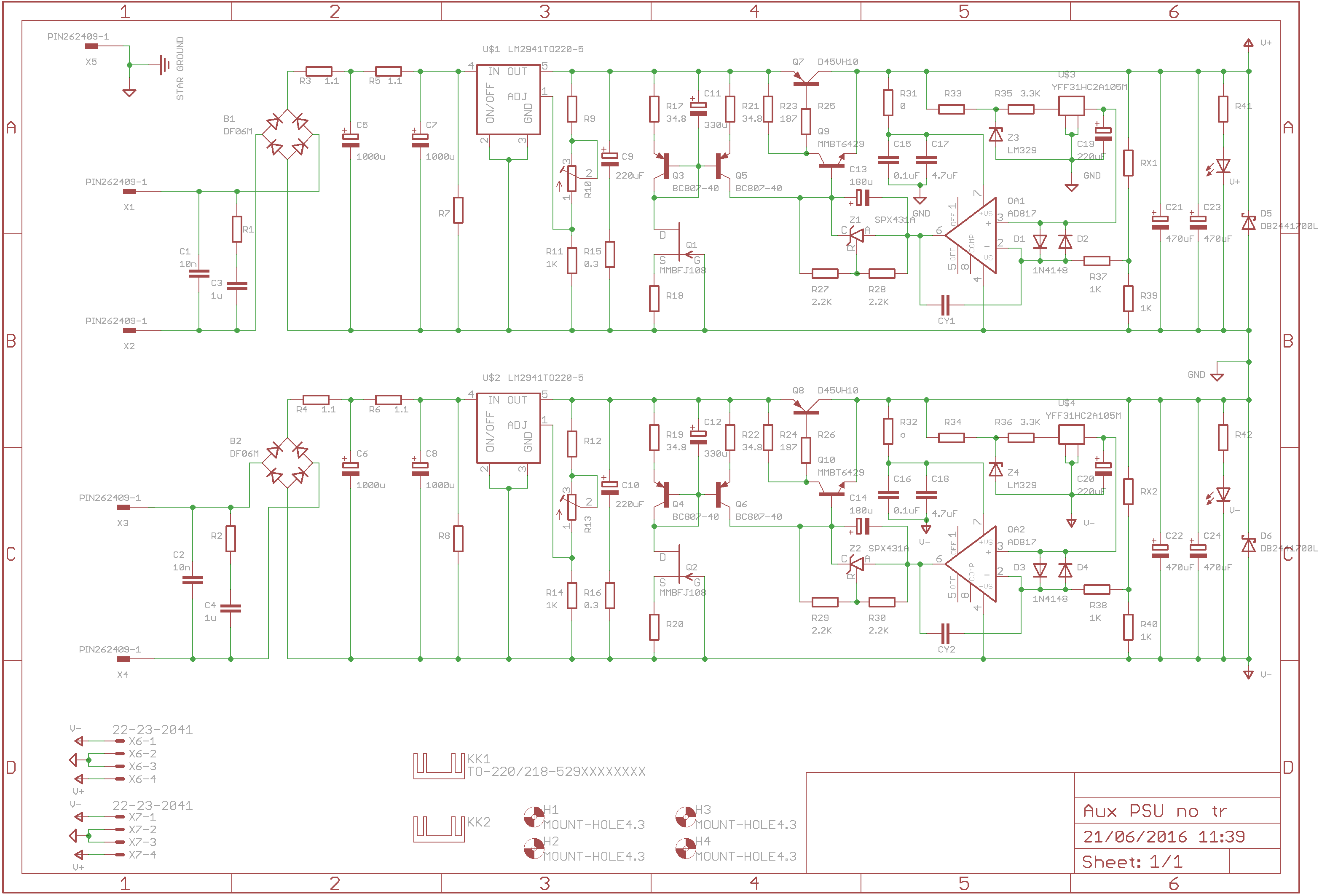

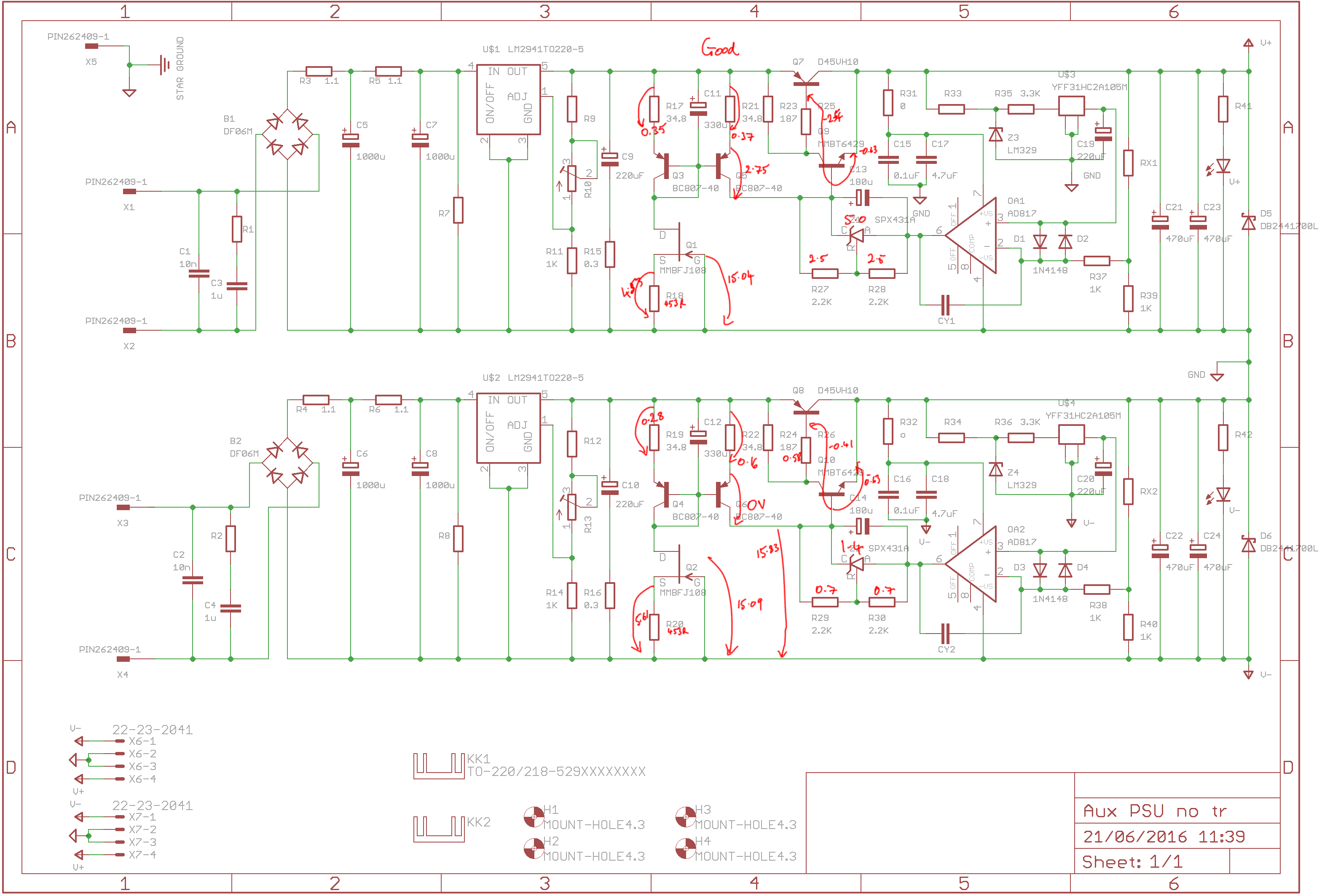

Consider temporarily replacing R38 with 100K instead of 1K. Maybe a shorted or dead output is dragging down the VREF node through R38 and protection diode D3? If so then making this a higher impedance, weaker, path might let you see what the "real" Vref truly is.
I think you are right about the dragging down of Vref through R38. R38=100k and Vref at D4 sits at 6.8V - still a little low as the drop across R36 is still about 0.2V. So Vref circuit ok but output sitting at 15.17V (+ if I run just that half of the circuit and, of course, -ve if I run both). (Vout of both pre-regs is 16V.)

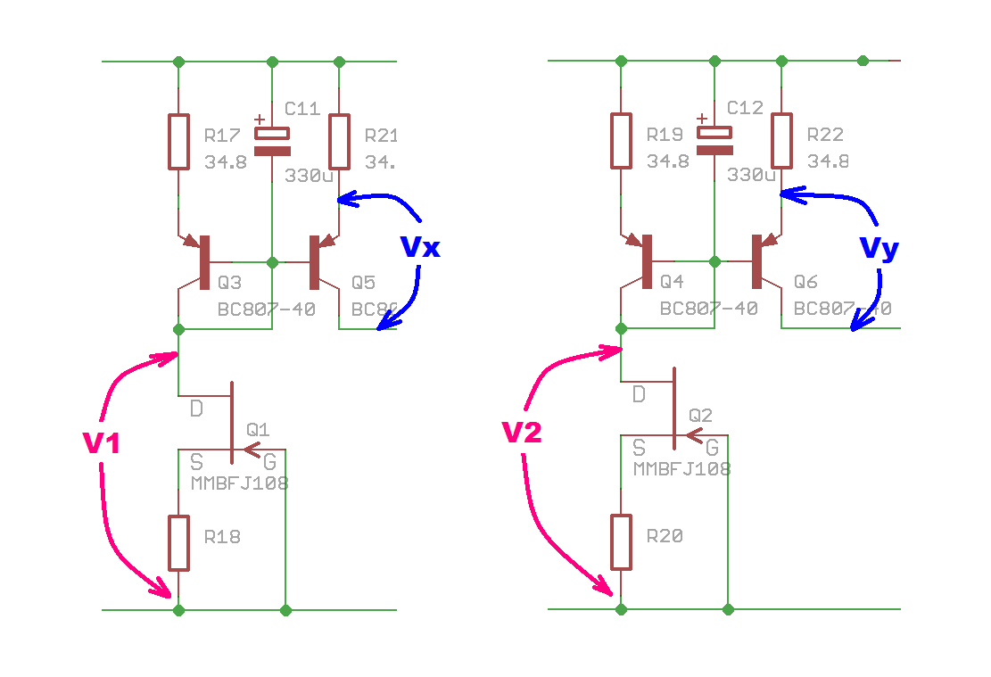

I need to pick this up in the morning, but I did take another quick look. I see that I am not getting the same voltage drop across R19 (0.276V) and R22 (0.166V) even though they measure the same resistance, 34.8R. I am also dropping 5.61V across R20 which also measures true at 453R.
A current mirror circuit that fails to mirror currents, is indeed suspicious. Maybe the components inside the mirror are bad. Or maybe the external environment is forcing the mirror to operate in a bias configuration outside its design limits.
Fortunately you've got a known-good copy of the same circuit, right there on your PCB. So you can compare the VCEs and VBEs and ICEs of the individual transistors, to see whether they are operating outside the expected and legal "forward active mode".
Oh and just to eliminate one source of possible doubt, you can consider removing 330uF capacitors C11 and C12 from the PCB. Their purpose is to reduce sensitivity to AC disturbances, while you are solving a DC biasing error. If you remove these caps from the board you immediately KNOW they are not leaking, you KNOW they are not shorted.

Thanks a lot. I only had a few minutes to spend on this tonight but I think Q6 is part of the problem at least. Vy is basically zero volts vs 2.75V for Vx. I will make the repair tomorrow and report back. Thanks again.
Of course, I just couldn't put it down... Replacing Q6 didn't solve anything. I checked all the relevant voltages between the two regs. See attached. There's a problem with the level shift, but replacing the SPX431 didn't solve it. So I have now replaced Q4, Q6, Z2 plus Q10 for good measure. That only leaves Q2 and Q8 as original active parts. C12 removed makes no difference. If Q8 were toast I would expect 16V at the output rather than 15.16 (and I wouldn't expect to see a problem with the level shift). All resistors measure as they should. Circuit trace continuity would seem correct.
I would have thought the issue is the level shift but I'm surprised replacing Z2 didn't help. Perhaps I have several duds or it is being damaged when soldered. Perhaps replacing it temporarily with a simple resistor would help in isolating the issue. But time for some sleep now...

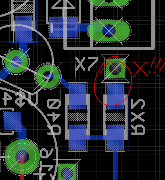

It's amazing what can happen when you leave something alone for a day or so. Tonight I couldn't get to sleep and so I popped back to this after a day or so's break from it. Within about 15 seconds I found the problem. I said to myself "well if Vref is good and I can't find a problem with the current source/mirror and level shift part of the circuit, let's at least double check the other input into the op amp." Then as I looked for RX2 to be ready to probe it I see a via with nothing attached to it. Plain as day as if it were blinking neon. A quick check of the Eagle file and the air wire, an uncompleted trace, is confirmed. Doof! Luckily it is easily bridged with solder and the correct output voltage is achieved.
Tomorrow I will try to find the time to revisit the points made by Mark in post 199.

Ouch. Is there a "Design Rule Check" button with an "Unconnected Nets" tab in Eagle?
I selected KiCad because it's free and because it lets me build arbitrarily large boards with arbitrarily many layers, for free. One of KiCad's idiosyncrasies is that it demands the layout must exactly match the schematic, EXACTLY match. So KiCad will scream its bloody head off when you run DRC / Unconnected Nets, if the schematic says pin P connects to net N but that connection is not present in layout. You can't make KiCad stop screaming. Sometimes this is inconvenient, as when you want to use a jumper wire but are forced to go back and put it in the schematic before you can lay it out on the PCB. Other times it saves your butt_ when it shows you an error your eyes didn't notice. {The above discusses "opens" ; KiCad screams just as loudly when it finds "shorts" too.}
It implicitly assumes the schematic is perfect and golden. Which is silly because fallible humans can make just as many mistakes creating schematics as they make creating layout. So savvy users do whatever they can to protect themselves from human-caused schematic errors. The gold standard is to netlist the KiCad schematic straight to ascii text SPICE format and simulate the actual board level schematic directly, in SPICE. If it simulates good, it is good. (Or as good as the stimulus you apply in simulation). But sometimes that's difficult / impossible.
Then there are techniques, heuristics, and tricks. Things experienced people do, that would have prevented / illuminated their previous mistakes. One trick I have learned to do, is to label every circuit node on the schematic with a human readable name. FETGATE, PBIAS, FBAK, etc. Sometimes when I feel whimsical, RALPH, ALICE, FRED, WILMA. Then if I see "net_0001" on a netlist or on the layout, I know it's a schematic error that needs to be fixed. Saves my butt_.
Hi. I started with Eagle and have been reluctant to learn another software suite. I started with the freeware version and ended up having to pay a small amount for the hobby version when my boards exceeded the allowable size of the freeware version.
I went back and checked ERC and DRC on the file. Neither throw out an error for the 'airwire'. ERC even states the board and schematic are consistent with the airwire outstanding. But I have noticed now that the 'ratsnest' tool does tell me if I have airwires. I still had another even after fixing this one. Unfortunately, unlike with the DRC or ERC it doesn't tell me where the airwires are which is rather annoying (perhaps there is some 'hidden' trick to help here - there certainly isn't an obvious one). I finally found it after about 10 minutes of searching the board in high zoom. Trace from R39 to via to GND. Fortunately the trace made it to the edge of the via and the error was merely that I hadn't (somehow) connected the trace to the centre of the via (no idea how not give the way Eagle routing works). I may remove a little of the mask on the end of the trace and via and glob it with solder for good measure.

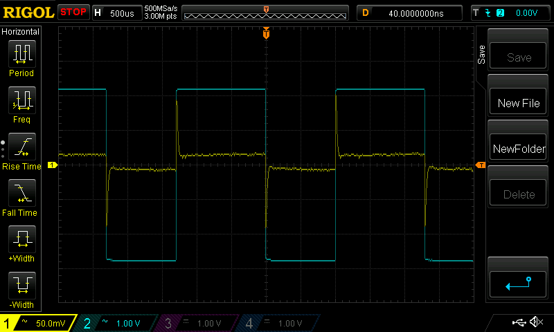

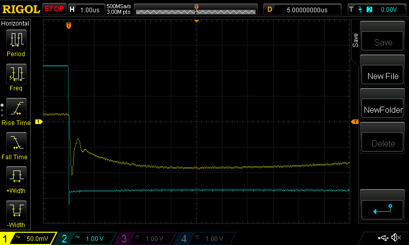

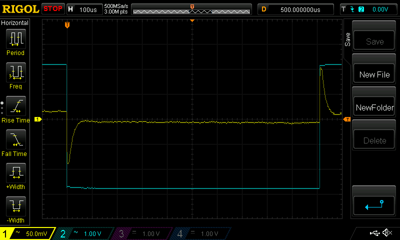

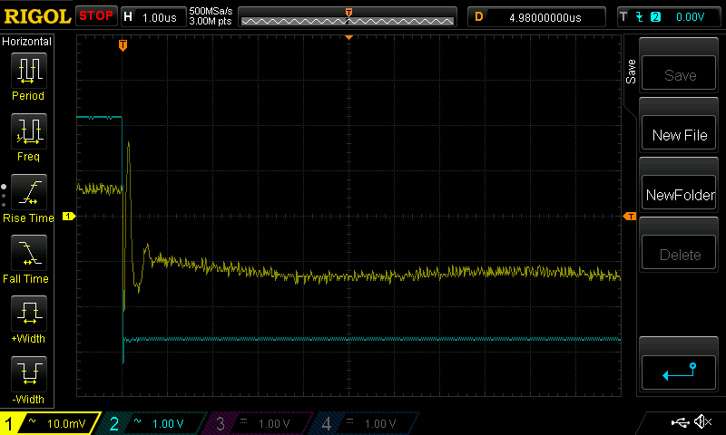

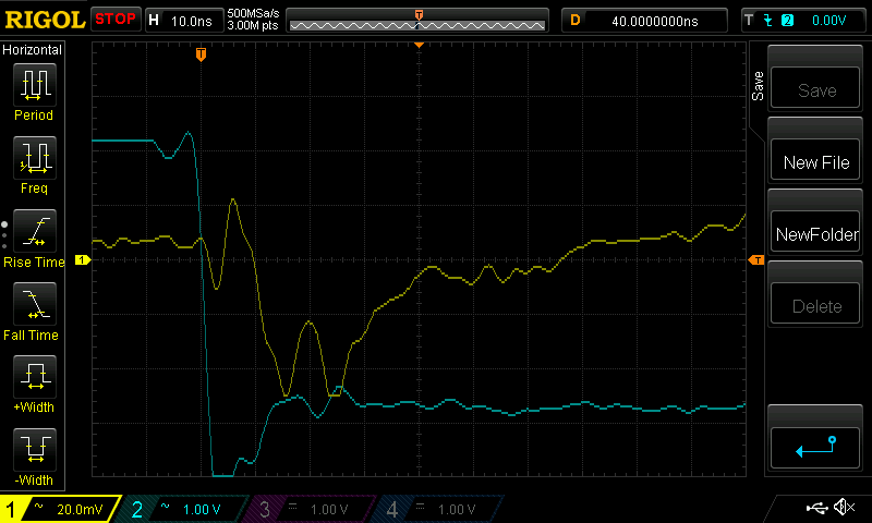

Here's a series of scope shots using 16 sample averaging, the other (-ve) side of the regulator, probing the output connector.
It would seem the unexpectedly high output impedance is prevalent on both sides of the board.

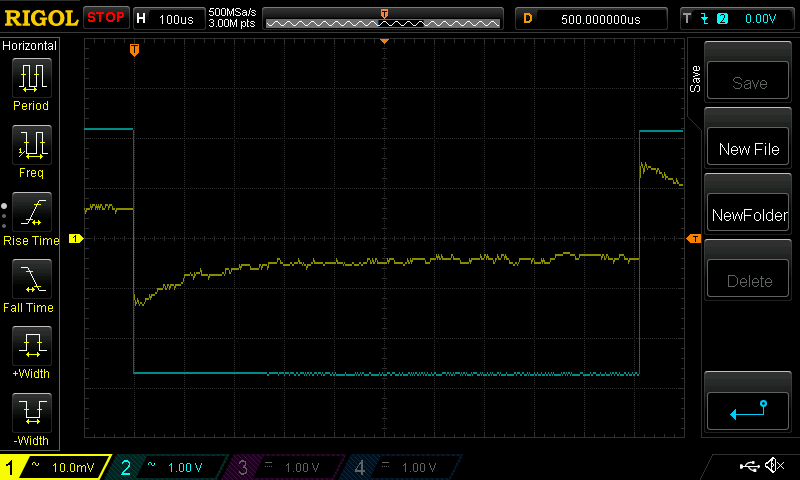

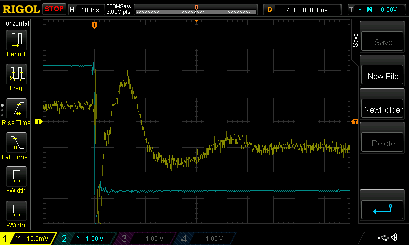

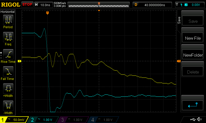

I also probed the pre-regulator's output capacitor terminals. (note different vertical scale)

Yes I had noted the output impedance spec in the LM2941 data sheet also. At this stage I can only presume I have a bad bunch of LM2941 because I don't see a significant resistance in series with the output pin of the LM2941. When I saw the above measurement results I was contemplating testing a version which bypassed the pre-reg.
Other possibilities might include (a) your measuring instruments are less accurate than TI's; (b) you are not measuring the same thing under the same conditions as TI; (c) you have not connected your instruments to the D.U.T. correctly; (d) TI's datasheet is full of lies; (e) you are measuring a freak, out-of-spec, part; and so on.
