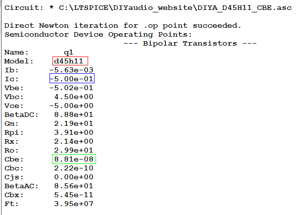

I invite you to calculate it yourself. Just be sure your calculations are performed at Ice = 0.5 amperes, on a PNP whose fT = 50MHz.Cbe calculated to be 61nF ... That seems very high.
Or if your semiconductor physics is a bit rusty, there may be a way to get LTSPICE to print its internally-computed small signal capacitance cbe; perhaps a 15 minute romp through the online Help pages would reveal it.
Or maybe you can devise a clever test circuit that unambiguously measures cbe directly. Then plop it on your protoboard and measure away (or plop the measurement circuit into LTSPICE and simulate away).
Sure enough, there is such a way; see green box below. I simulated using the spice model from ON Semiconductor's website; apparently its fT at this operating condition is 40 MHz rather than 50 MHz.... there may be a way to get LTSPICE to print its internally-computed small signal capacitance cbe; perhaps a 15 minute romp through the online Help pages would reveal it

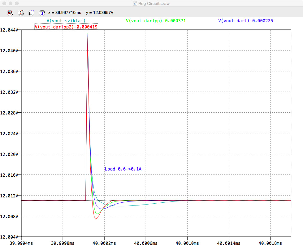

Now dream up your own variations and try them. Rcheat is one just one possibility which my tumor and I invented in ten seconds.

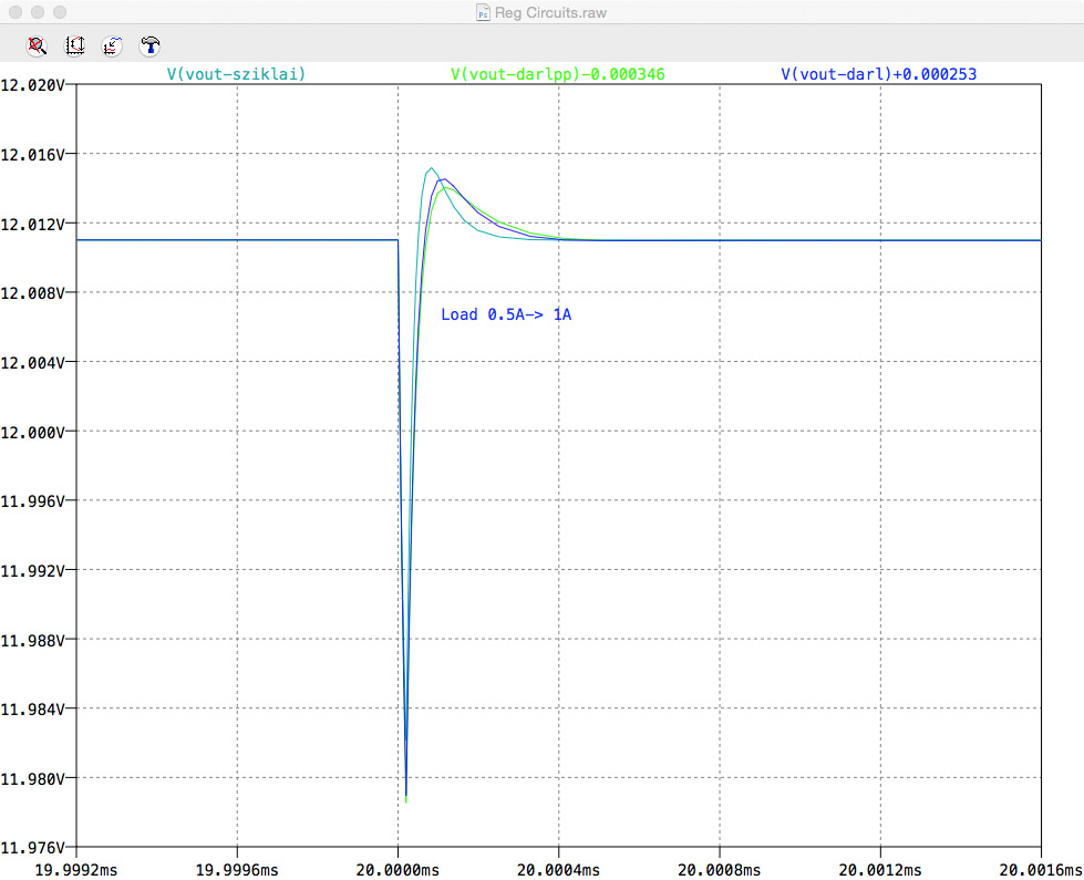

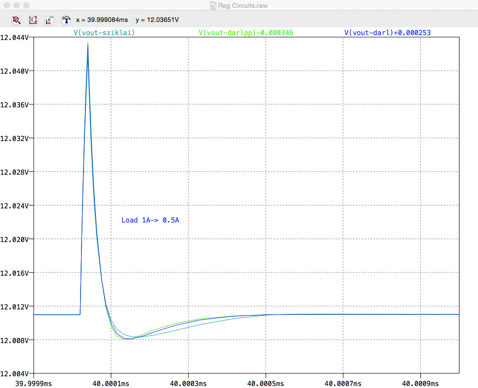

Actually it does make a significant improvement depending on the load scenario (e.g.when the base load is significant such as 0.5->1.0->0.5).

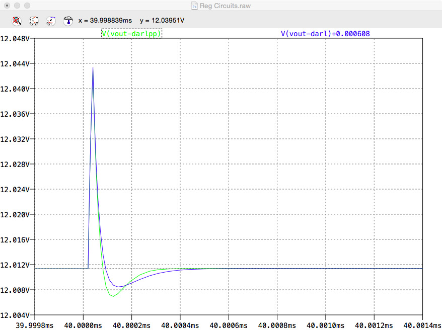

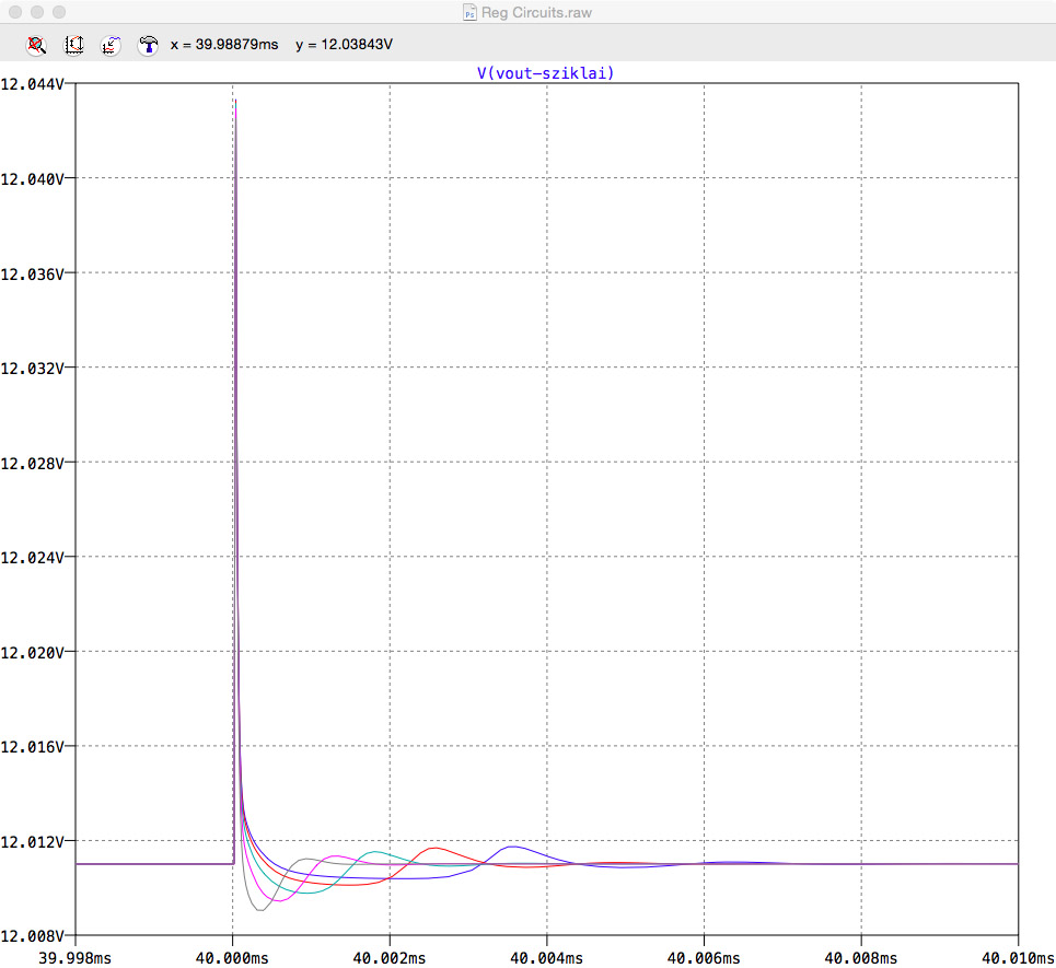

What I am most puzzled about at the moment is that I cannot replicate the Darlington results I got in the third pic here which led me down the Sziklai path rather than Darlington - even when I revert everything to reflect the circuit in the image in that post. Very odd. The Darlington would (now) appear to be the solid outperformer and the push-pull driver can help a good deal. 😕

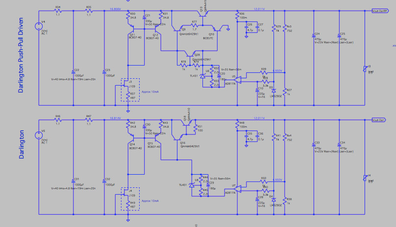

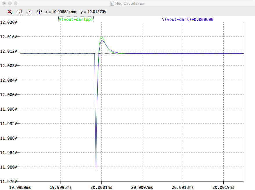

I've been tinkering with some options, but none have proven better from a transient perspective than a simple Darlington with 100R resistor from pass transistor base to Vout.
I believe that Teddy Pardo's resistor to ground rather than Vout is simply to get much greater current flow through it (greater dV) and hence drain the Cbe faster. If I route the simple Darlington 100R resistor to GND rather than Vout the circuit behaves very, very much like the push-pull driver configuration where a PNP driver shunts Cbe to GND. It would seem the Pardo configuration achieves basically the same result with less complexity.
A push-pull driver with resistor from pass transistor base to Vout doesn't really get the chance outperform the simple Darlington configuration (with resistor from pass transistor base to Vout) by much if anything. Perhaps the PNP driver to ground doesn't get turned on quickly enough to make a big difference.
Choosing, with respect to transient response, between a push-pull driver or base resistor to GND configuration versus a simple Darlington with base resistor to Vout would seem to be a 'choose your poison' decision. The former are faster to normalise Vout, but with greater overshoot. I'm not sure - based on an eyeball integration - that either has considerably lower overall Vout error.
(I've just been using two 1N4148 to generate the is voltage in the push-pull driver configuration.)
Your analysis of Teddy Pardo's mystery resistor, matches mine. Which probably means we're both wrong!
I think it might easily be possible that these subtle-seeming variations, have a not-subtle effect upon the open loop gain and phase. In other words, the different variations might be operating at different amounts of phase margin, and THAT might be the explanation for different amounts of overshoot. So the fairest possible comparison might require you to first jiggle with tenths of picofarads up and down, to get the same phase margin for each variant, before simulating in the time domain.

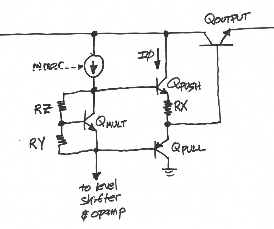

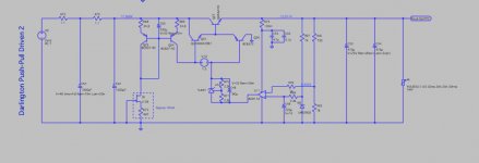

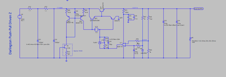

And before you ashcan the push pull forevermore, at least try it with a proper class A bias network. Choose a bias current I0 that you can live with (I suggest 15mA or thereabouts), then choose emitter resistor Rx so that (I0 x Rx) = 26mV. Which means Rx is in the neighborhood of 1.7 ohms. Leave Ry=1.0K and adjust Rz until the collector current of Qpush equals your chosen value I0. Voila, perfect class A operation.
_
_
Your second paragraph may well be correct and I will spend some more time looking at this.
I did quickly compare my simple push-pull configuration with the Class A bias version you depicted above. They're both very similar from a transient perspective, perhaps because the simple version has a good deal of current flowing through Qpush: +60mA (with +50mA being dumped to GND via Qpull).
With an MMBT6429 for Qpush, what might be a good component choice for Qpull? Another BC807-40?

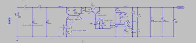

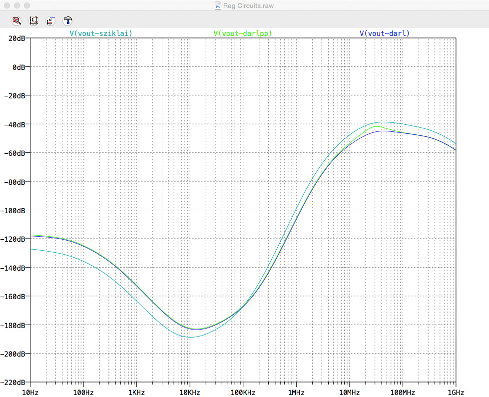

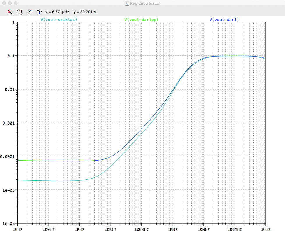

The other thing I want to investigate further is why the Sziklai shows a much lower output impedance even at low frequencies (65.6u versus 18.5u at 1kHz).

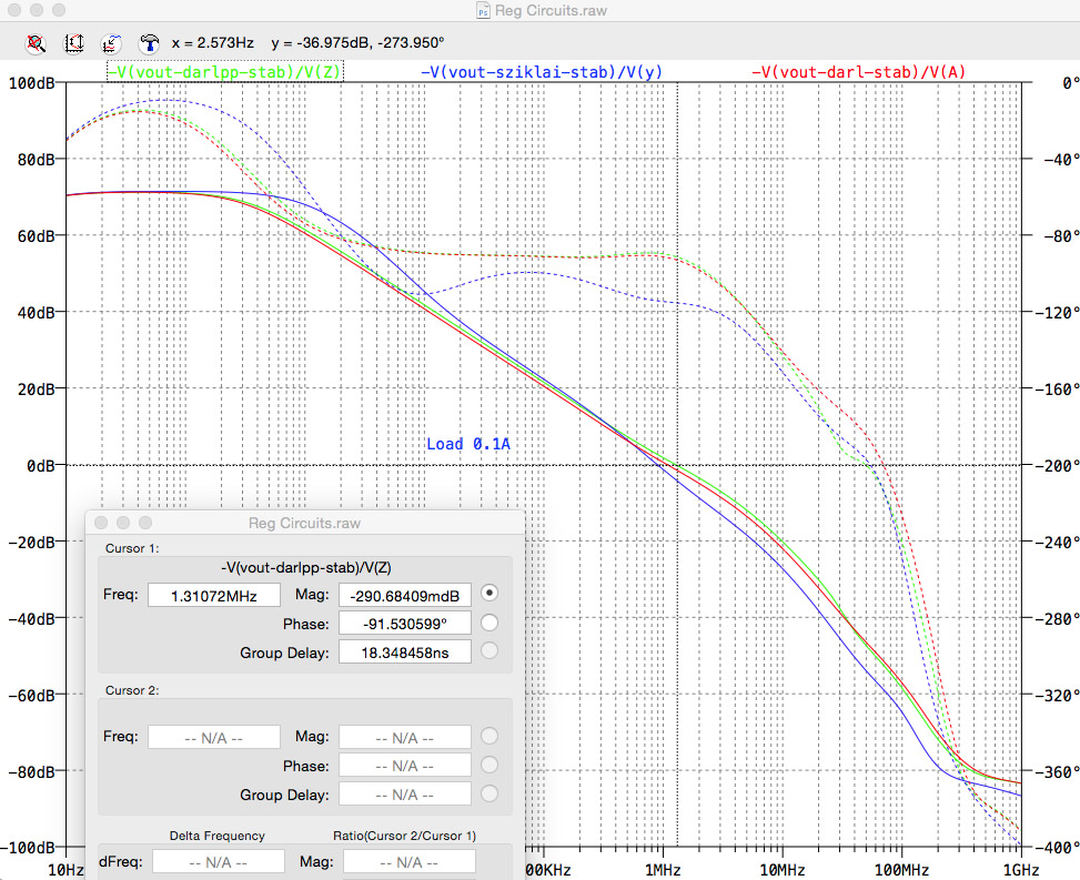

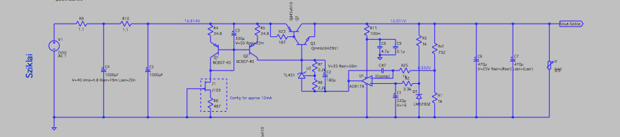

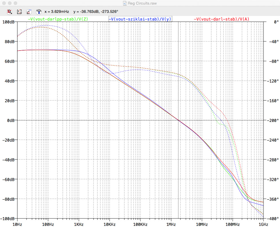

I added a 4.7p compensation cap to the Sziklai to give it a modelled UGF roughly the same as the Darlington configurations. There's now little between the transients responses. I am still puzzled by output impedance given there isn't anything obvious to me in the pass transistor data sheet to suggest the difference. I'm not sure now if it is worth changing the board vs just picking up some small caps...

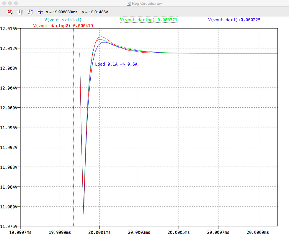

One thought I had is that the MOSFET scope shots were with a much lower vertical resolution of 50mV per division. It may well have obscured a lot. It can only be resolved by testing it again.
I continued to tinker in sim. It is interesting to look at transients from a lower base level of current. As annotated, the above were transients with loads from 0.5A->1A->0.5A and the bode plot is for load=0.5A. Here is the same work but with load 0.1A->0.6A->0.1A and bode plots with load=0.1A.
Phase margin for the Darlington configurations expands versus Sziklai. (I kept the 4.7p compensation cap for the Sziklai.) The Sziklai also underperforms significantly when the load comes off. (I should have deleted the red trace darlpp2. It doesn't have a resistor between Qpush and GND and so has high current.) My measurements of the circuit I have built were with minimal 'quiescent current' (stepping c0.5A) which is presumably just the bleeder-LED and op amp quiescent current on the board and whatever load the chop chop box presents when switched to 'off'.
Stepping the Sziklai "base" load: 25mA, 50mA, 100mA, 200mA
(note also the LTspice 'quirk' whereby runs other than the first seem to start 20ns late)
The Darlington configurations have much less variance with base load.
