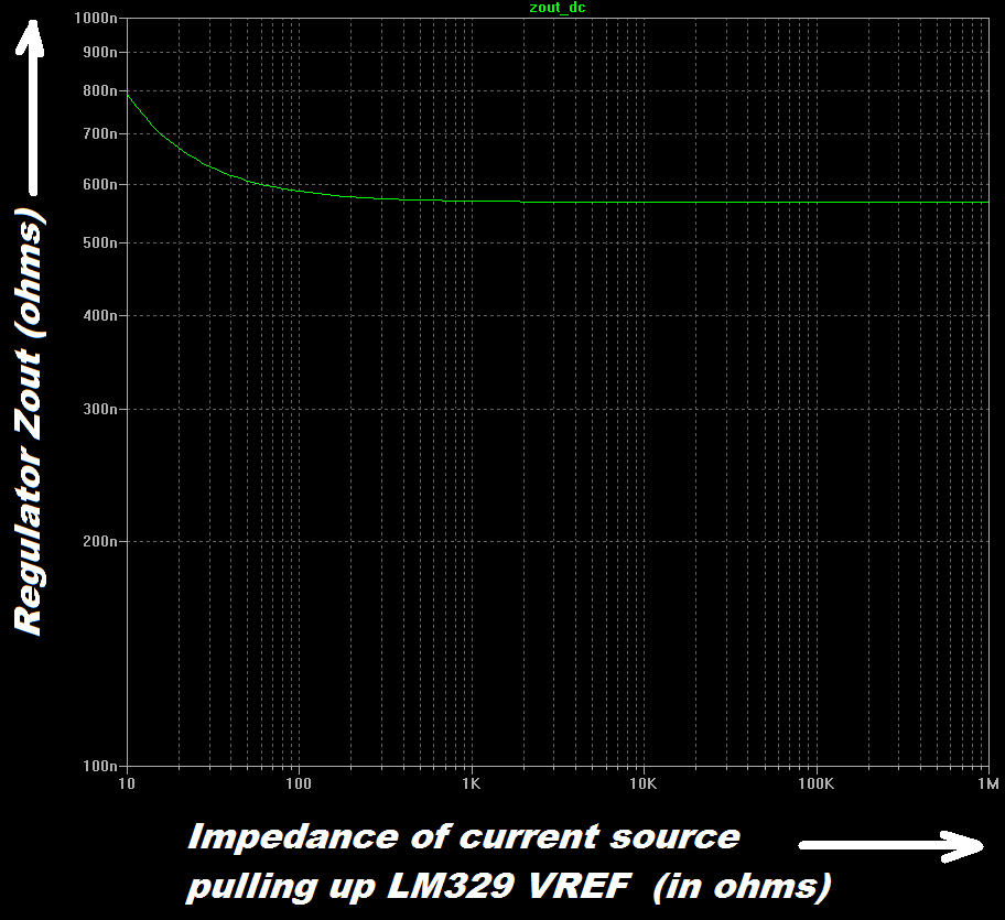

The purpose of computer simulation is to correct faulty human intuition.

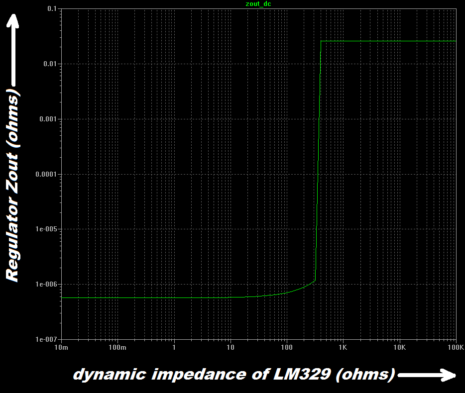

My intuition was faulty; I thought your regulator's output impedance would be sensitive to the impedance of the puller-upper that feeds bias current into the LM329 reference diode. But -- it isn't! Simulation results in Figure 1. I'm guessing that your circuit pulls up the LM329 with an impedance of 1K ohm. Figure 1 shows that pullup impedance makes no difference as long as it's bigger than ~ 100 ohms. Contrary to human intuition!
Figure 2 shows what might happen if you were magically able to reach inside the LM329 and change its dynamic output impedance. Answer: in the region where the LM329 operates (0.8 ohms typical, 2.0 ohms datasheet max), not much. A weakness in the simulation harness creates nonsense for dynamic impedances > 200 ohms; the step-up is not real.

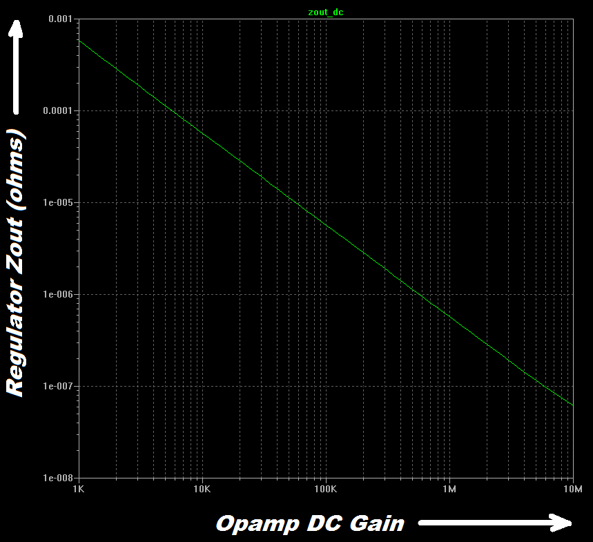

Figure 3 varies the DC gain "Avol" of the error amplifier. As expected, closed loop output impedance falls when loop gain rises.

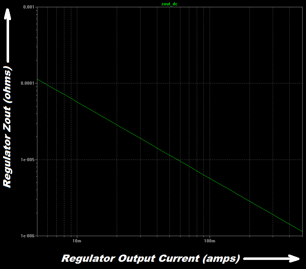

Figure 4 varies the regulator's output current. Since the open loop output impedance is 1/gm and since gm rises when output current rises, human intuition expects closed loop output impedance to fall when output current rises. And fall it does.

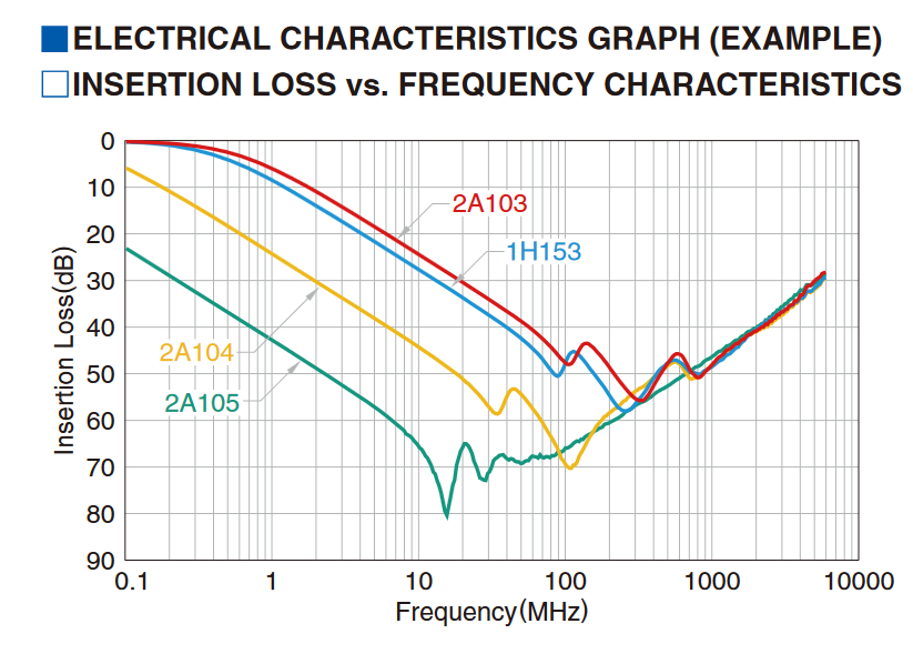

FYI: I just bought twenty pieces of these feedthrough capacitors made by TDK: mouser.com link to P/N YFF31HC2A105M
Their DC current rating is 6 amperes, making them attractive for use in medium current and low current power supplies; headphone amps, preamps, etc. They act as a very high quality 1 microfarad capacitor with a self resonant frequency way up at 10+ MHz (!!), figure attached. 1.0uF is bottom curve, labeled "2A105". Put it in a damped RLC lowpass filter and possibly get some very sweet 40dB/decade attenuation of high frequency noise. Might be delightful.
Maybe, insert it after the first R in an RCRC filter between a LM329 zener diode and the VREF input of a voltage regulator's error amplifier. Although John Watson's listening tests in Linear Audio showed approx. zero correlation between regulator noise and subjective listening enjoyment.

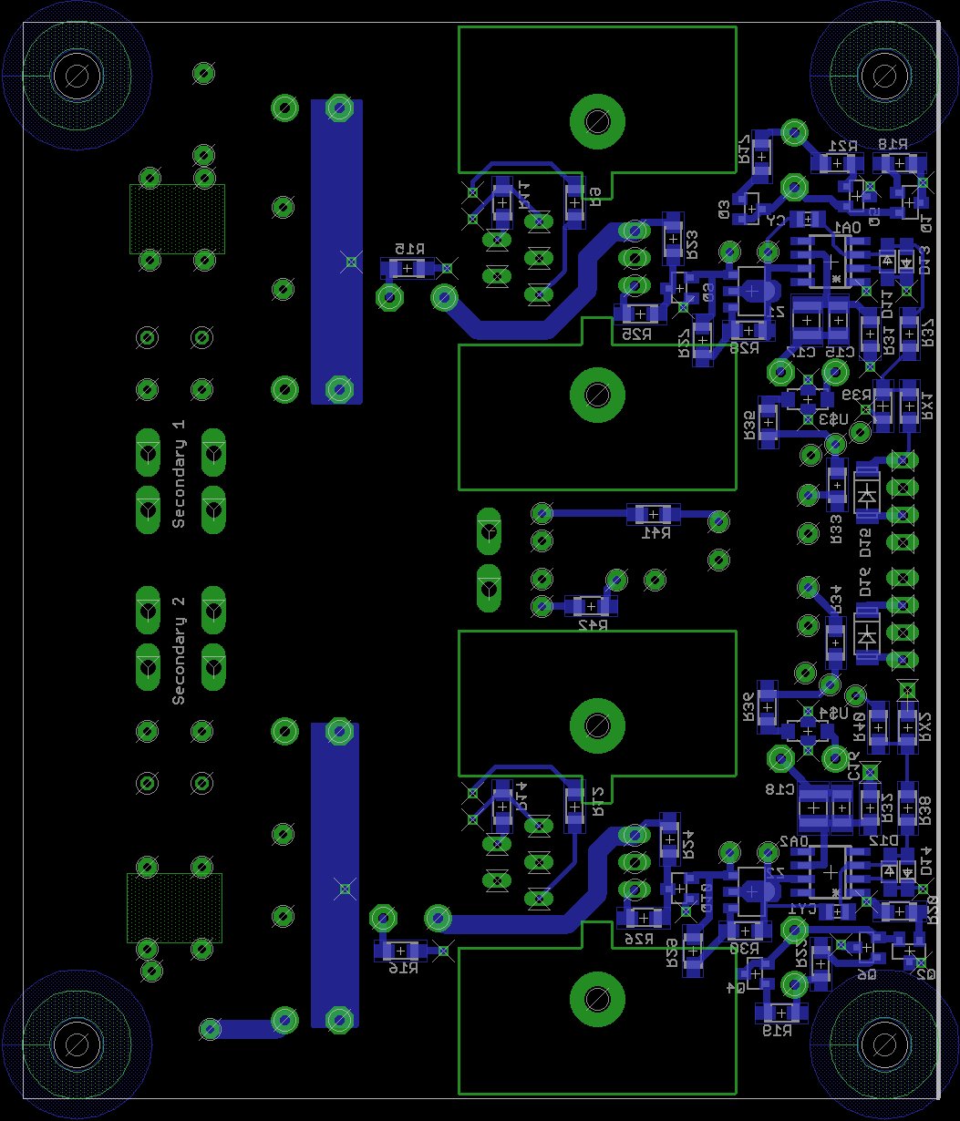

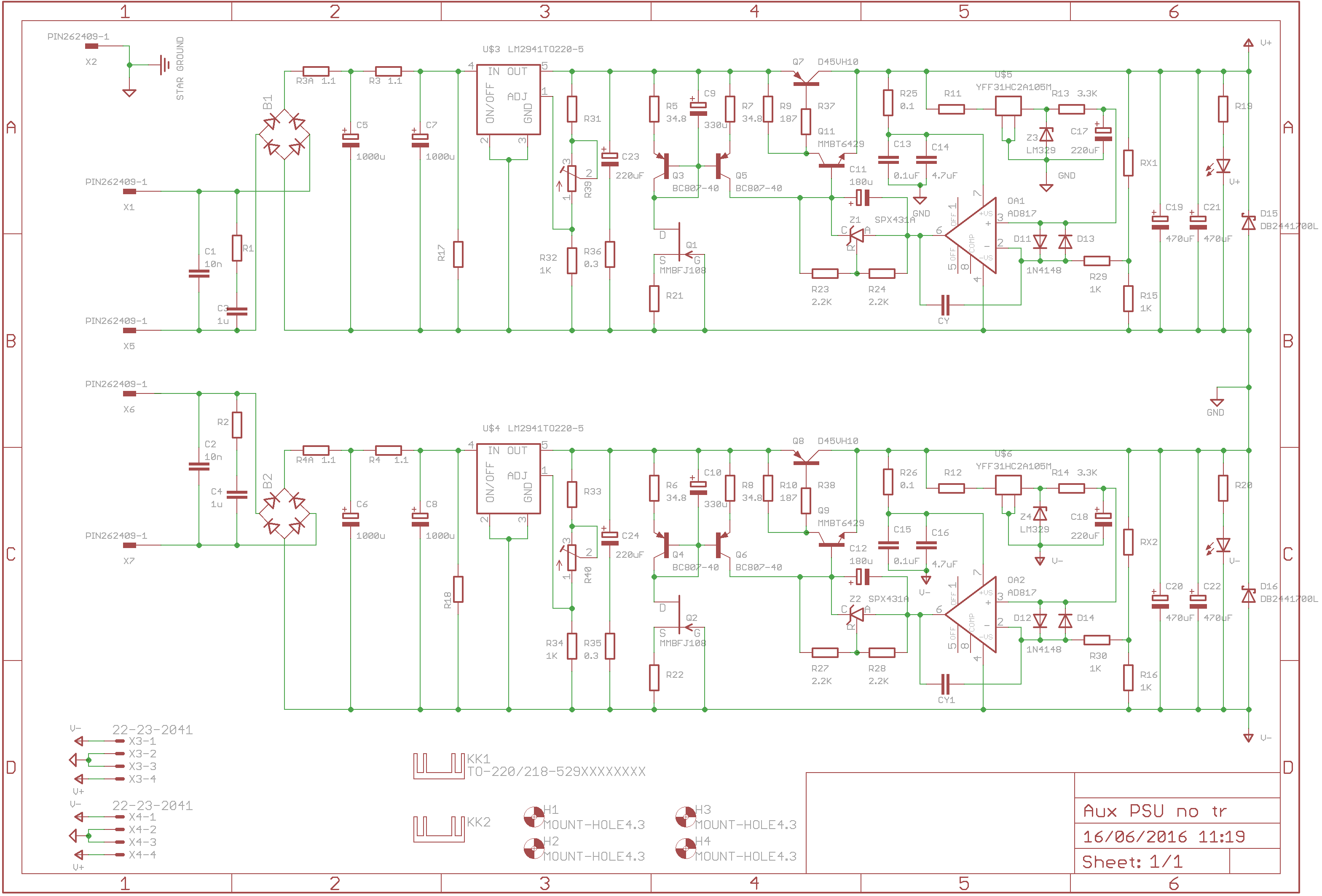

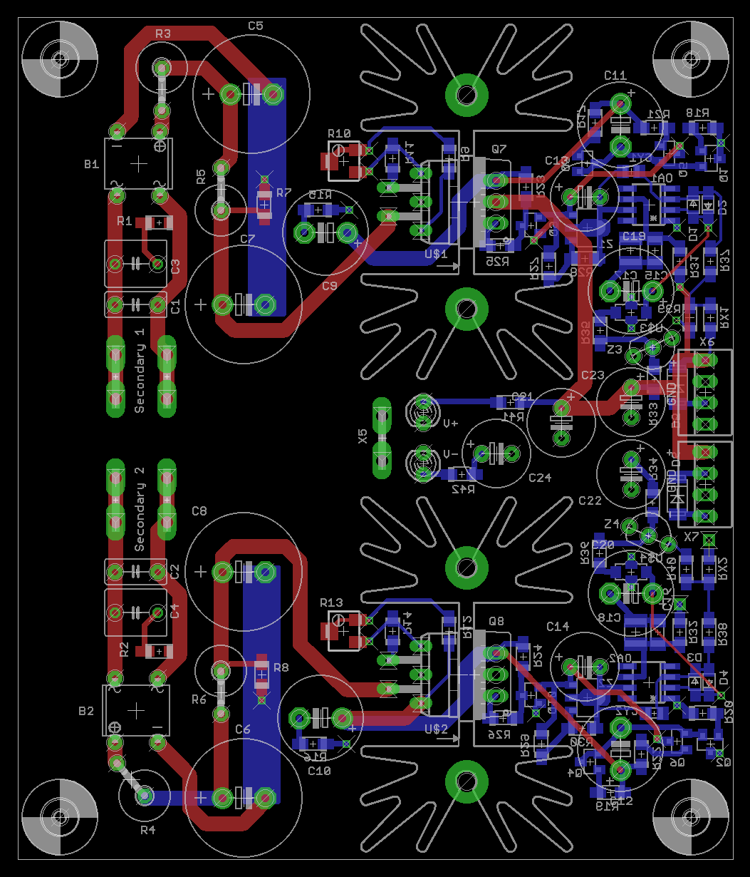

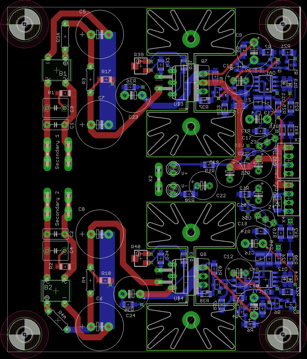

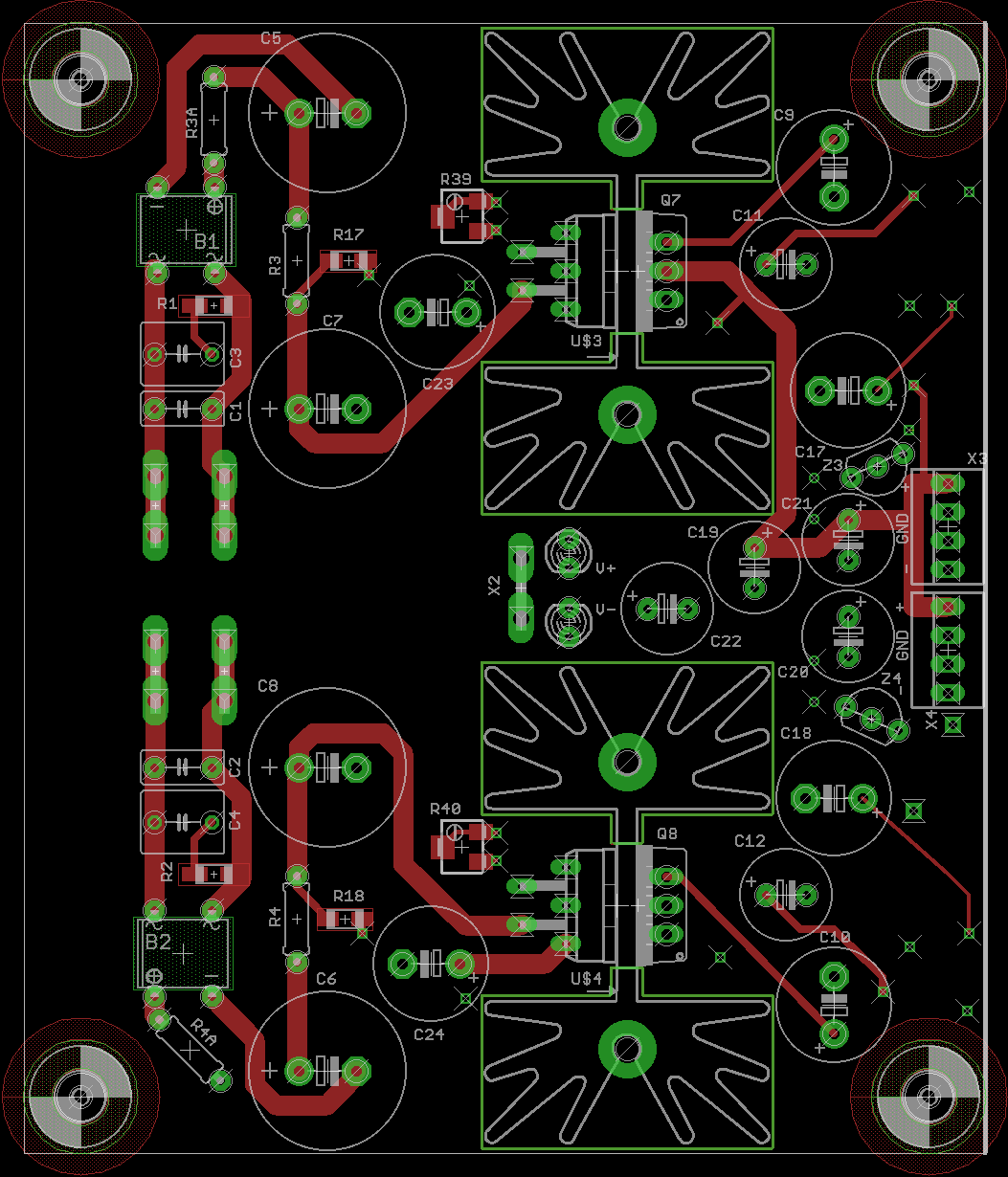

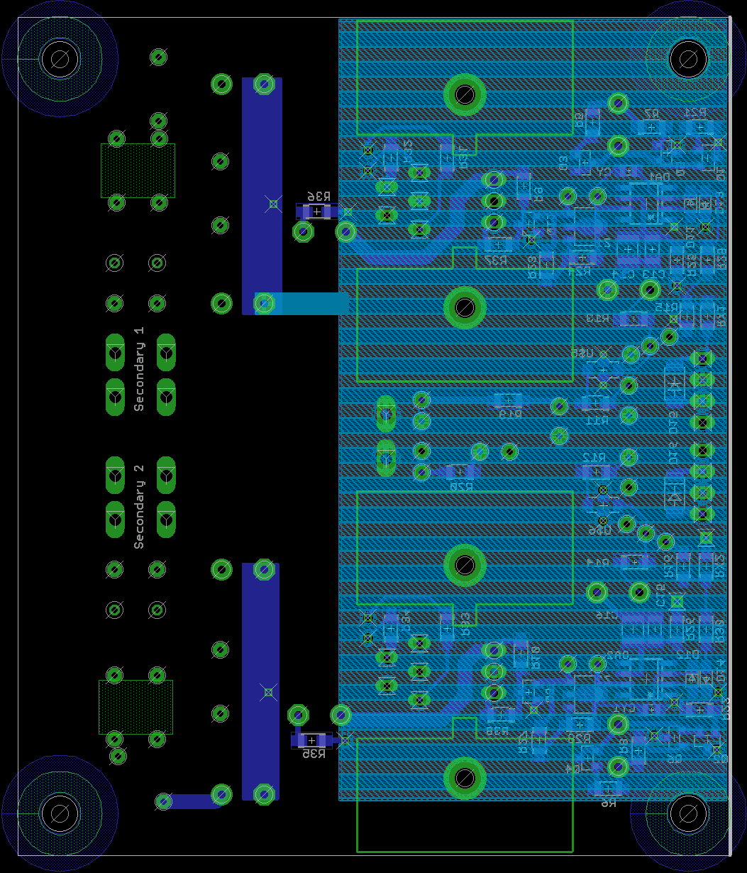

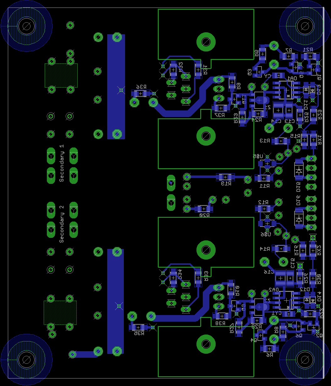

Back at this. I have also made a smaller version without the PCB transformer. Perhaps the overall shape and dimensions could be optimised further but I wasn't keen on having to do the entire right side of the board again. I added provision for the EMI filter. Hopefully this is implemented as suggested. I need to work out some component values for bleeder resistors etc.
Pics:
1. Circuit
2. Top and bottom layers
3. Top layer
4. 2nd layer GND plane
5. 3rd layer V- plane
6. Bottom layer

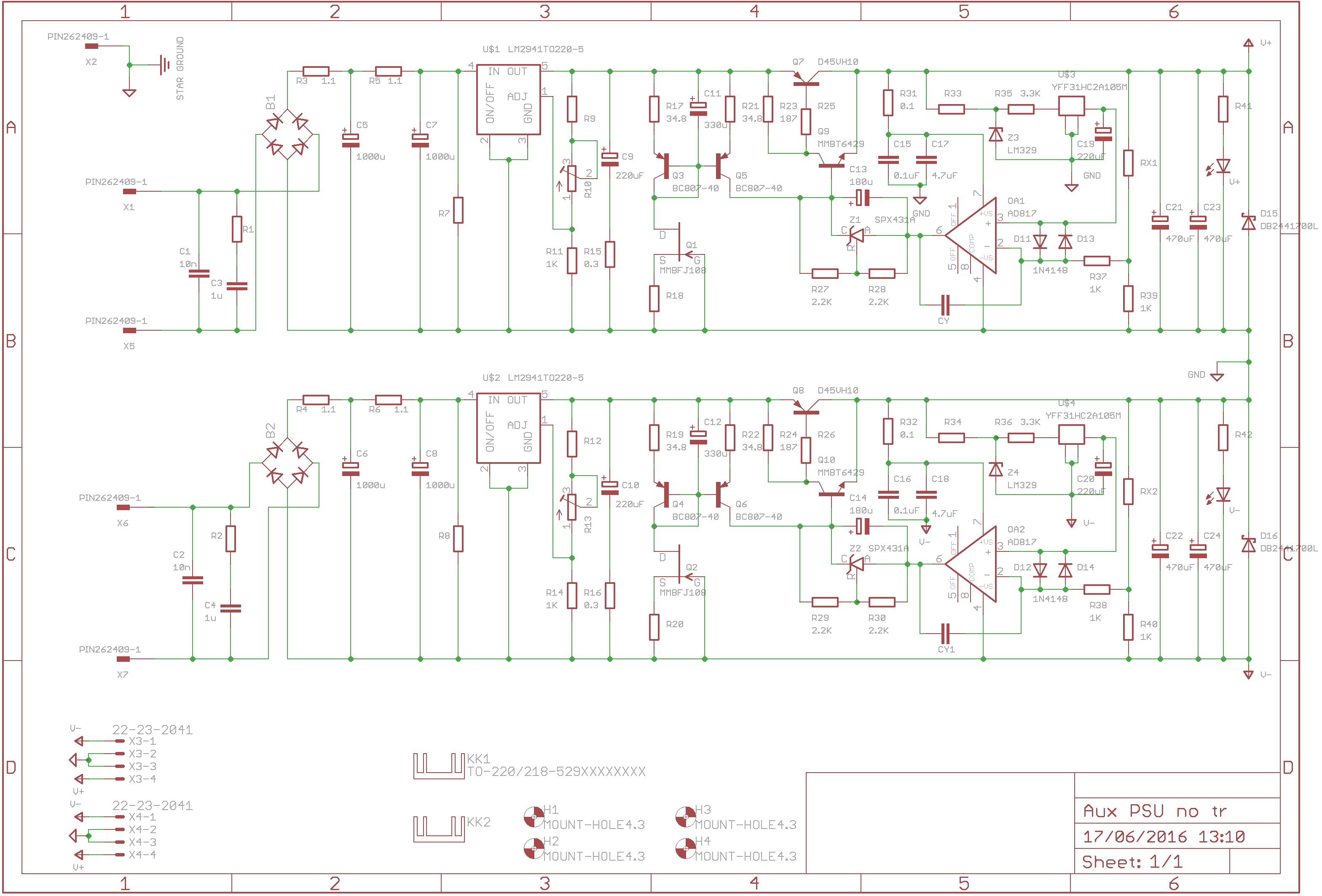

The TDK YFF3 feedthru capacitor might do an even better job if moved to a position between R13 and C17. The goal is to have a noise free Vref at the opamp input; this new positioning kills both incoming noise and LM329-generated noise. Although John Walton's subjective listening panel found no correlation between power supply measured noise and listening pleasure. (link) Still, as a point of engineering pride if nothing else, why not reduce noise as low as possible? How can it hurt to have lower noise?

In the schematic of post #175 I got curious about the (Q1 + R18) subcircuit.
So I dug out an MMBFJ108 transistor, soldered some wires to its pins, and connected it up to my resistor substitution box + power supply + milliammeter.
With the supply set to 10.0 volts, I varied the resistance of R18 and recorded the drain current flowing in Q1:
Of course there is unit-to-unit variation from one FET to another, and even more variation between wafer fab lots with different date codes. But some data is better than no data at all, and at least this is some data.
