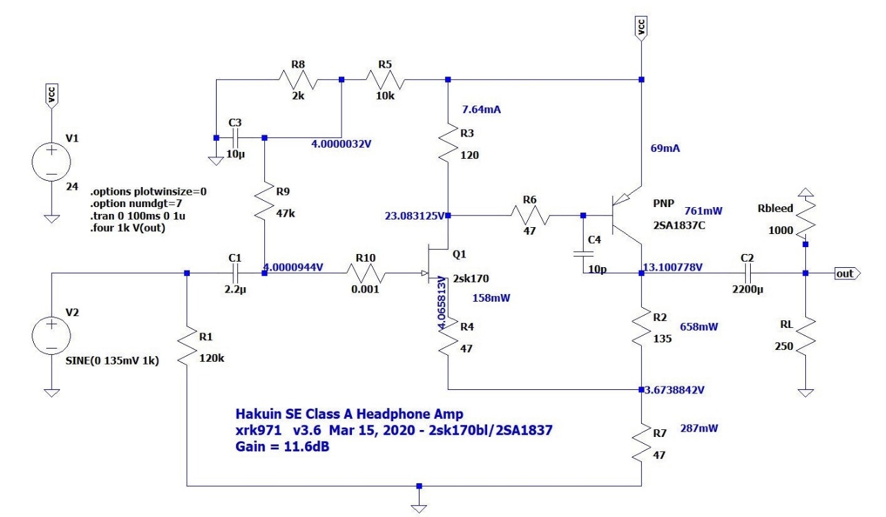

I am going to have to lower the voltage from the Yarra psu to 24v for the Hakuin. You had posted the following for member meanie"
Hi Meanie,
I also run 22v trafos in the Yarra capMx psu. The way I reduced the voltage is increase the CRCRC resistors on the daughter board itself to lower the voltage.
My PCA’s use 47R and 33R in those locations for approximately a 7-8v drop. I don’t remember what my Hakuin values are. Use Ohms Law to calculate what the resistor values need to be for your voltage drop.
If using Ohm's Law V=IxR, solving for R saying I need a 4 volt drop would be R=4V / I . What is a good value for I ?
Thanks for the help,

The Hakuin draws about 78mA total per channel. 70mA in the main output BJT and 8mA for the JFET input.
Using Ohms law, if you need a 4v drop in your PSU, R=V/I so R = 4v/0.078A or about 51ohms. Anything close like 47R to 56R can work. It will dissipate some heat though.
Power = i^2*R or 0.078^2*51= 310mW. So use at least 0.5w resistors and preferably 1W. You can do this in two stages for a CRCRC and 25R each for example.
Hope that helps. Schematic from Etsy shop.
