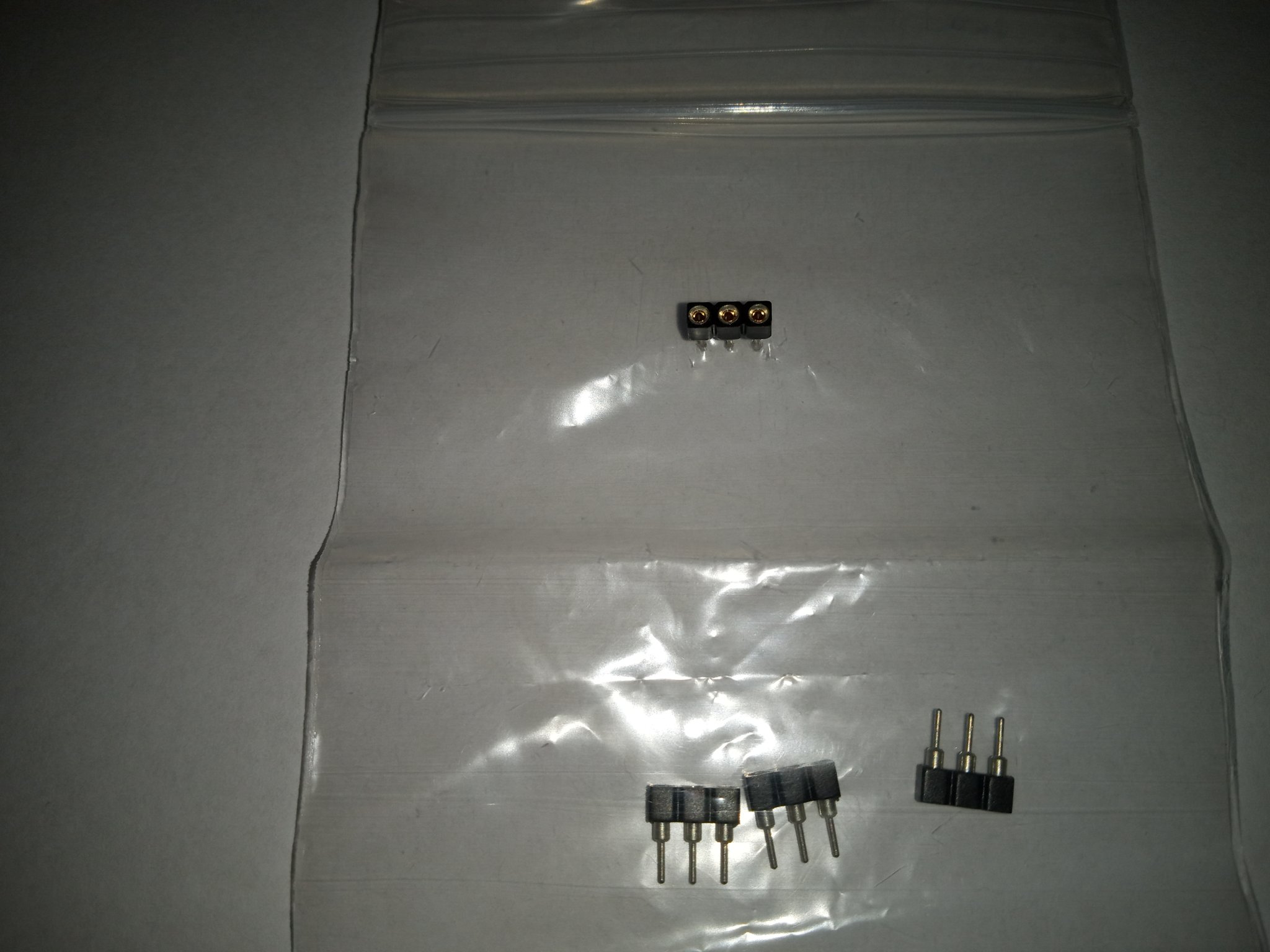

Got my header problem figured. I have a quick question about X123 and X133. Please see attached image.

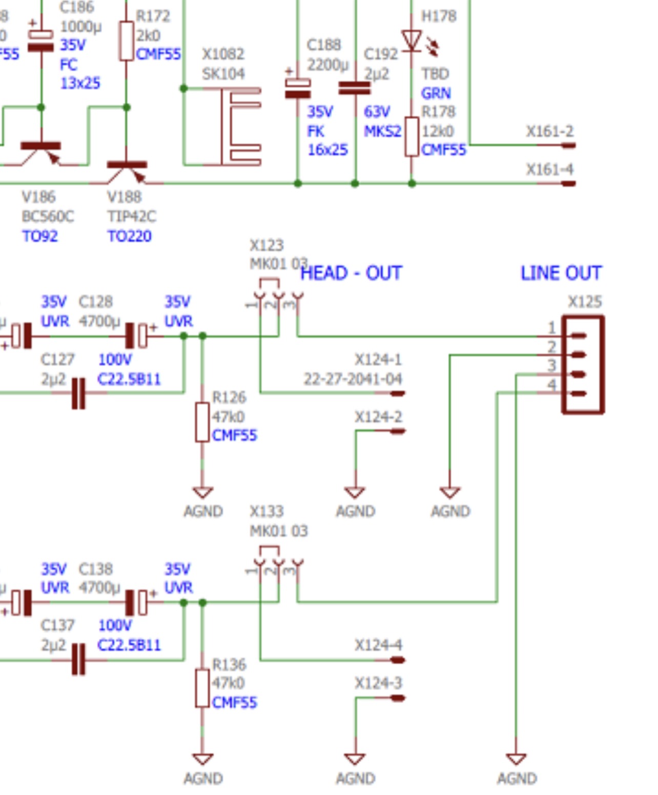

JPS showed on one of his 3D sketches and looking at the schematic that pins 1&2 are joined together. JPS 3D shows a jumper type wire connection from the top. The connector I have in the image shows no such connection.
My question is can I solder the 2 pins together from the bottom of the pcb and accomplish the same result as having a jumper wire connection from the top of the connector. I think I can, but want to confirm.

Yes, you can do this - it’s the connection to an optional headphone output. I think I simply put a 3 pin JST connector there and connected that to the headphone output jack.

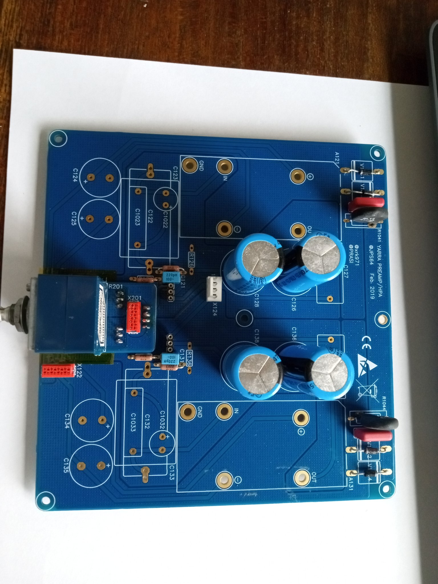

Thanks X, I am going to use this as pre amp only, so I am going to solder X123 and X133 in place with no bridging of the pins. I will install X124 for possible future use. Please see attached pic as to how it will look.
Also, you can see that I have already soldered in the 4700uf caps for C126,128,136,138. After reading the posts that you had with thompsontechs concerning the time constant, would you leave the caps and the 47K resistor for R126,136 and live with the larger bleed time or should I consider reducing R126,136 to 1K ohm.

I have the C126 to C138 4700uf caps soldered in place back to back. I calculate the net resistance of 100K + 600 ohm to be 0.600K. My T= 0.7 x 0.6K x 2350 uf which equals about 1.0 sec, if my math is correct.
By using f=1/T, this gives a frequency 1.0Hz, so flat to around 10 Hz.
If this is all correct, can I change R126 and R136 to 600 ohm resistors and proceed with the build.

Thanks X, any advantage to changing the caps to a lower value and calculating a different resistance value, or will it make no difference in the long run.
If you won’t be using as a headphone amp,
I would go with smaller caps and assume your load is about 10k ohms. You might be able to use a smaller cap like Elna Silmic II.
Thanks for the reply. I soldered the 4700uf caps in a long time ago according to the BOM. I will be very careful when removing the 4 caps so as not to damage anything. I will see what caps I have in my inventory and plan the calculations based on the cap value I have and the assumed net resistance load of 10K. Thanks very much for the help.
