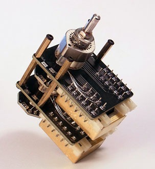

The most up to date info on the Slagle AVC is on the Intact Audio website which is Dave Slagle’s company. This autoformer based attenuator is now considerably upgraded with multiple positions and various cost offerings depending on whether you go for copper or silver wire.
Look at the Elma 47 position version: https://intactaudio.com/atten.html
I built a fully autoformer based balanced volume control a long time back, see here for the Poseidon’s Voice Lazarus
Measurements are actually quite excellent, I had mine professionally measured here.
The Slagle AVC preamp was the most neutral I ever owned until I built myself a computer server and started doing attenuation digitally through HQPlayer and the integrated 64bit volume control. That being said, the differences were quite small but the digital method was cheaper in some respects (hard to compare since the server cost about $2K in parts to build).

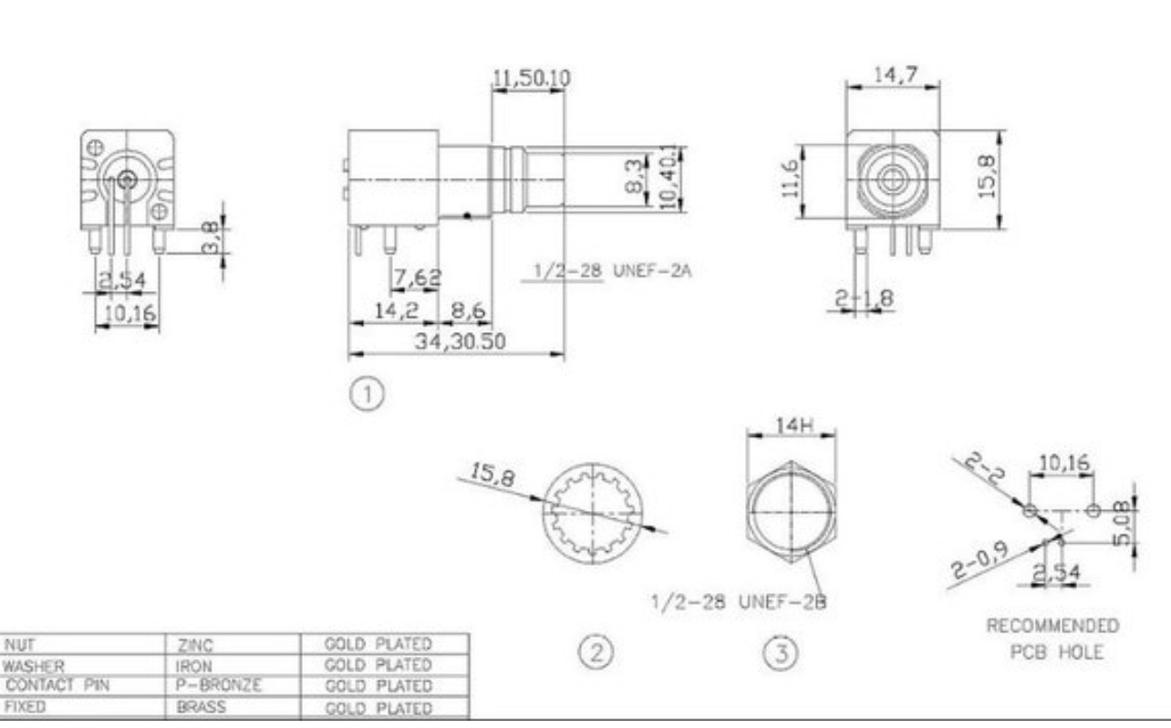

I see some of you were using the Vampire PCB mounted RCA jacks (PCB2F/S) on this project? Would someone have the mechanical specs/pcb footprint for these? Vampire has never published this info to my knowledge. They are now owned by PartsConnexxion in Canada.

Thanks so much! That is close to what I measured, but mine was a touch off. I'll compare this to the Vampire part, but it looks like it is the same thing.

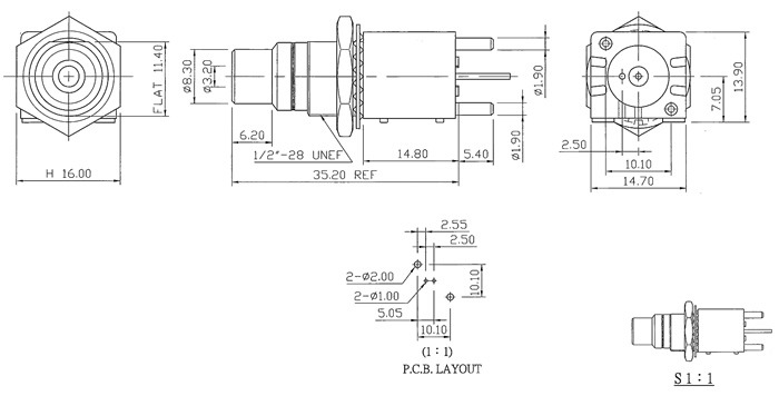

I found the horizontal ones (like the drawing you posted), but not the vertical ones as shown in the picture. I was looking in your store on Etsy, maybe that isn't the correct one.
The Vampire vertical jacks appear to have their corner pins on opposite corners to the Elecaudio connectors, which probably explains why your boards have corner holes on all corners, not just 2 of them. For my initial footprint made from measuring (poorly), I used 5.08mm spacing for the corner pins in Eagle with the pins at -5.08, 5.08 and 5.08, -5.08. The Vampire jacks fit with force, but interfere on the inside of the pins. Hopefully going to 5.05 spacing as shown will alleviate that. The 1mm holes for the center pins were tight as well, so I think I will use 2.1mm for the corner pins, and 1.1mm for the center pins.
For vertical mount you pull the pins out with needle nose pliers and install them in appropriate sockets. Straighten the 90 deg bend in the two signal leads. The unit works for both orientations. The ones I stock happened to be setup for 90deg orientation from the factory as those are the most popular for most of my designs anyhow.

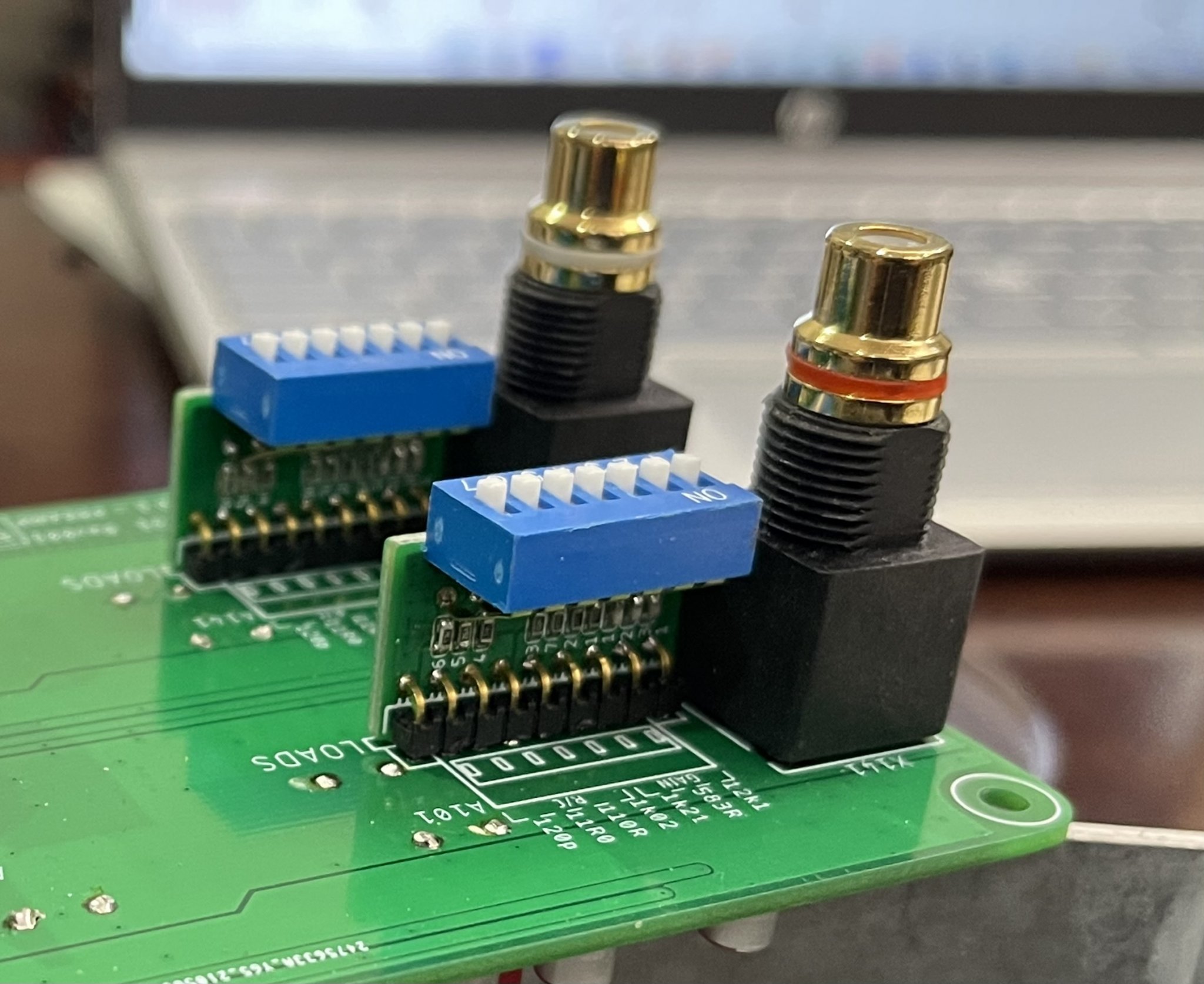

Hi X and other builders, I was spending some late hours working on the Yarra MB and schematic. I am a bit confused by X101 thru X108 and X112 thru X115 labelled 12HP059 red and black. I know they have something to do with the rca connectors, but what are they exactly: cables, wires, inside part of rca ... 🤔
