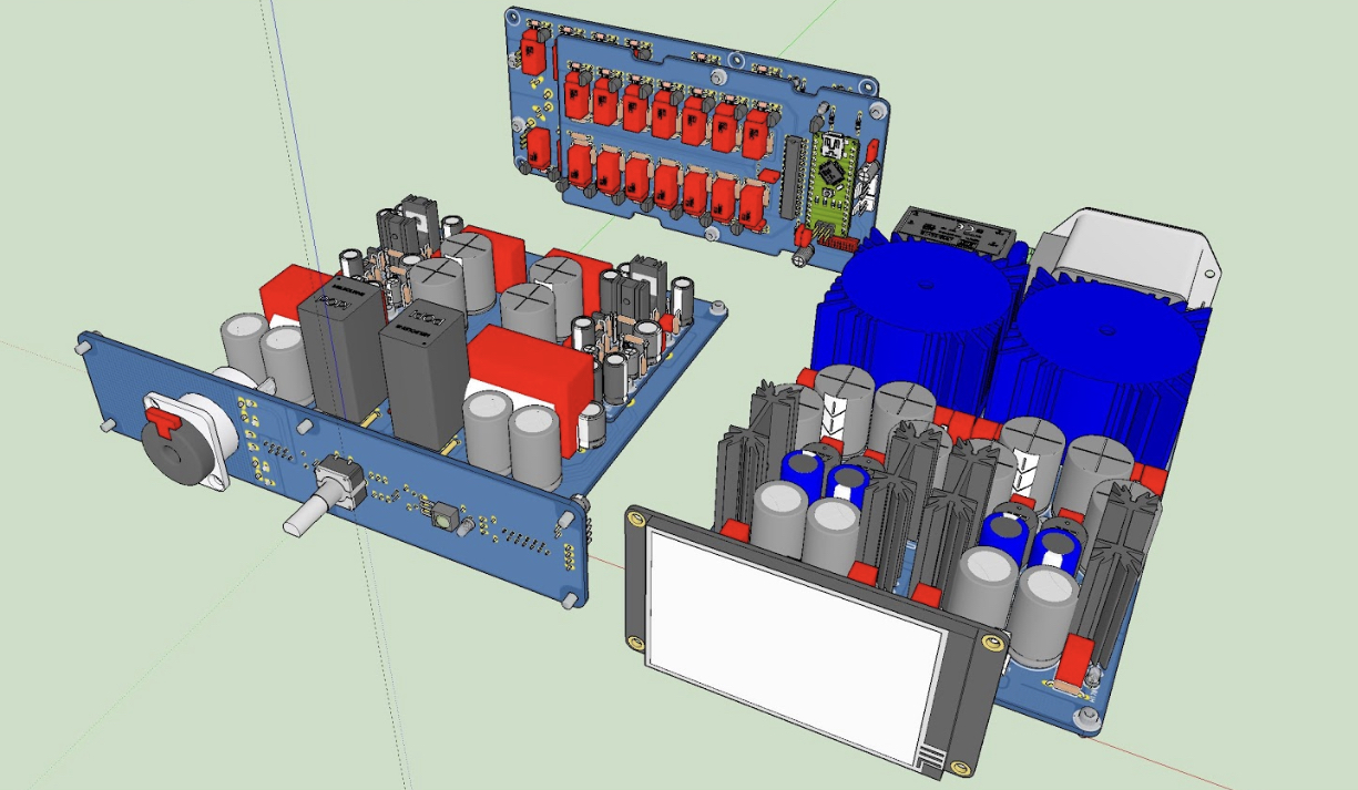

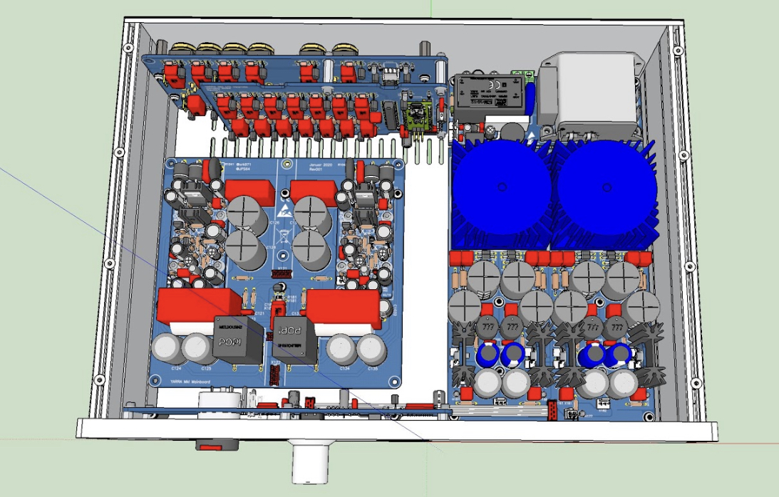

Just wanted to give folks a peek into what’s ahead for 2020 with the Yarra Mk1. JPS64 has been busy and here are some of the new features considered and developed so far in the background.
1. New linear PSU with CRCLC and TPS7A4XXX LDO regulators for regulated ultra low noise supply. Will have remote turn on/off.

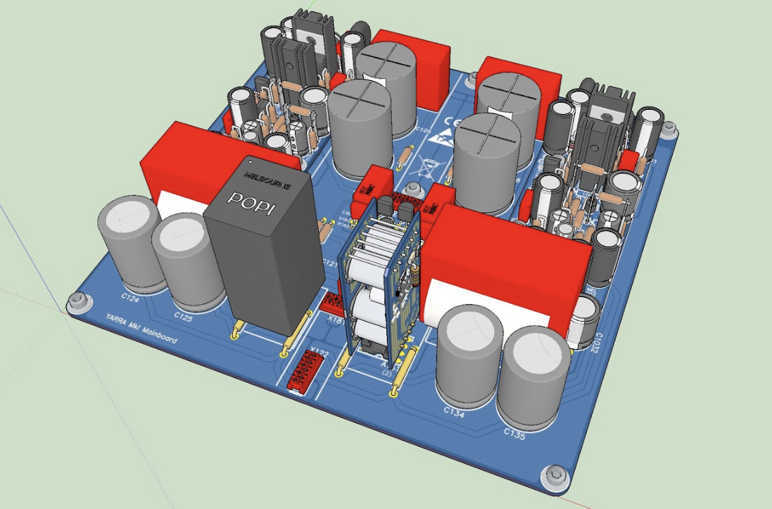

2. New mainboard with room for optional DIP8 format headphone modules including the new POPI (DIP8 Melbourne) and the Hakuin SE Class A JFET/BJT CFP output.
3. Balanced input and output converters based on THAT chips.
4. A microcontroller digital resistor network volume controller and input selector via rotary knob with push to select menu controller.
5. A microcontroller based OLED display.
6. Bluetooth 5.0 input ?
Some of these features will be optional and upgradable. The key changes will be the new dual monoblock PSU which will also be offered as a separate board for use in any high quality preamp or headphone project. The new mainboard which still retains the original 5-bolt standoff mounts.

For new XLR I/O, will likely need - at a minimum - a new rear panel and I/O PCB. Same for front panel.Will you be doing another case, or modding the one you already made?
With all the changes/options, it would get busy in there in a hurry.

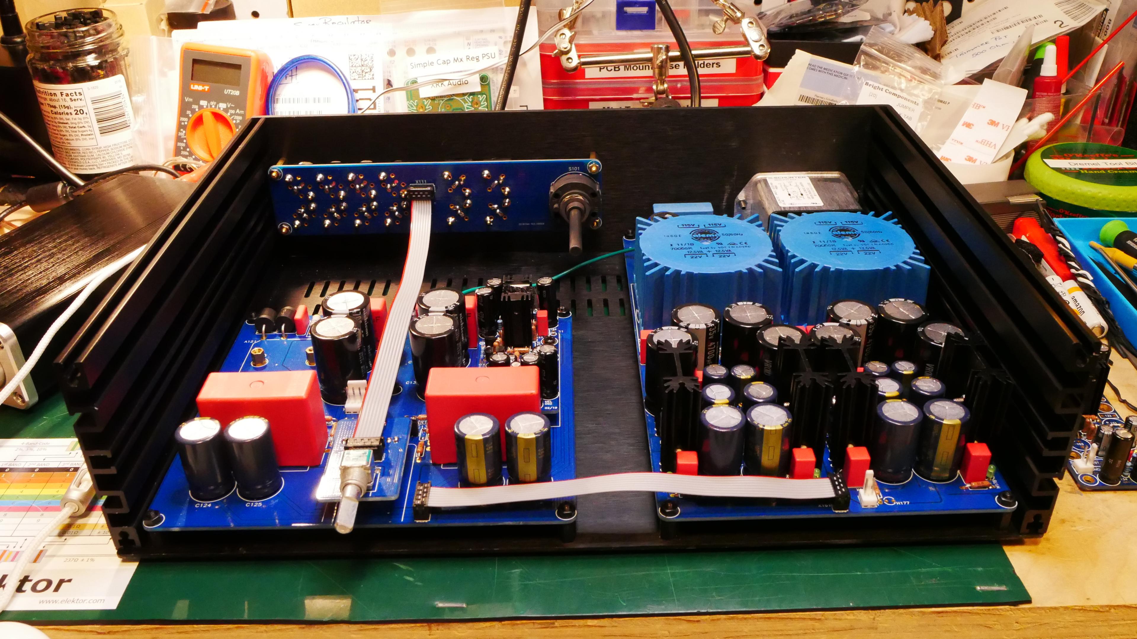

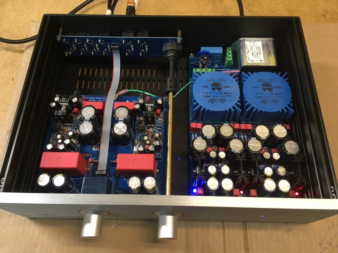

I was wondering if there is any interest in a second GB for the Yarra main board set. I am completely out of them, and could actually use one more for myself as I have two cases and only one board!
Anyhow, please let me know if you are interested and I will start a GB #2 interest list.
Redjr's Build is a nice example of what this boardset (PSU and I/O selector) looks like:
Originally posted here.
Nice work Redjr! Nice to see one fully built and cased up!
Also, here is TboneAK's very nice cased up build:
These are both fine examples and I wish mine was as far along with regards to the case work.
But too busy making new verification builds for all the different projects!
The Yarra is a world class sounding preamp and really does deserve to be properly put into a case!
