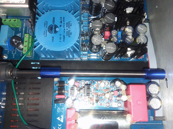

@ Al Depending on what case/face you have... On the Yarra the bushing comes through the whole enough that it makes contact with the rear of the knob before it can touch the face. Depending on face thickness, and knob choice, this may or may not be true. I used the Yarra case and sized specifically for that face thickness. Since the bushing is proud, it prevents end-play and prevents unwanted inward/rearward pressure on the switch and also prevents those scratches you mention. If you use two shaft connectors, one for the joining and one up against the shoulder of the bushing, you also prevent unwanted switch pressure outward. Basically, we alleviate all forward/reverse pressure while switching, take up any slop, smooth the contact from the shaft, for a great feel with no side, or end play whatsoever.

The fit looks great Thompsontech. Looks like you have a half dozen of these shafts and collars/bushings. Got a spare? 🙂
Yup, sure do... you will need to order the couplers though. I don't have any of those.

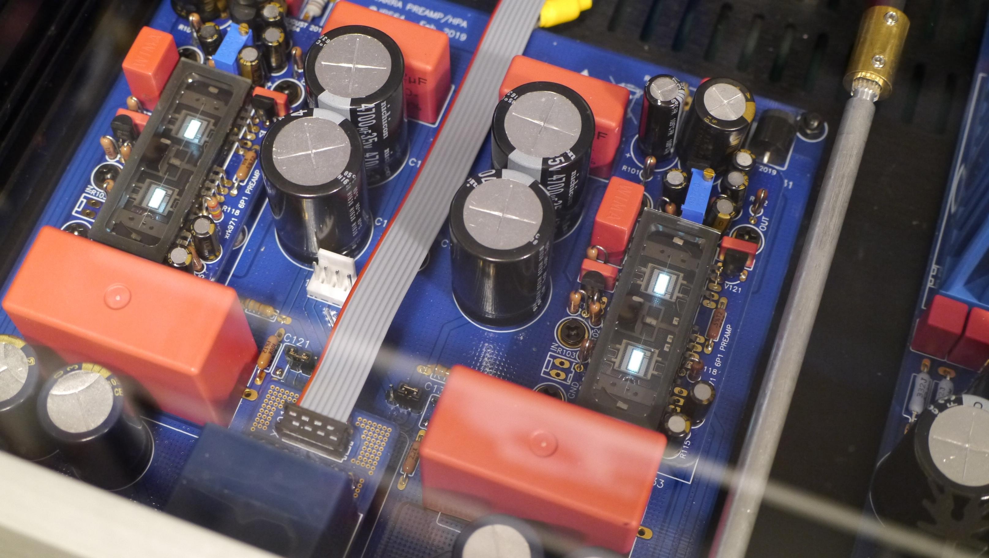

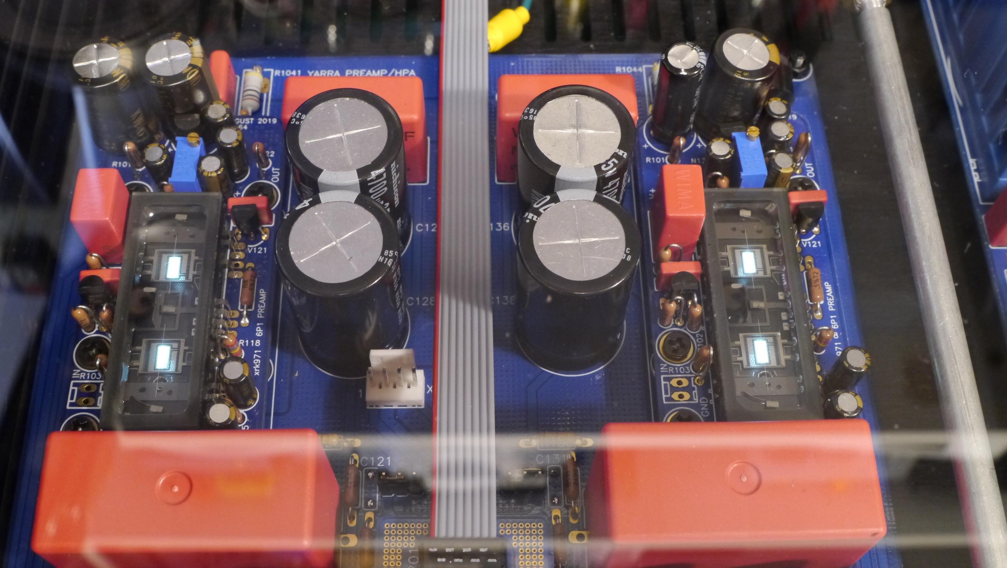

Hi all,
Since the holidays have been so relaxing, I thought I would get the Korg 6P1 DBs installed and tested in the Yarra. Listening to Steely Dan as I write this and all appears well. As usual, sound is crisp, clear and quiet! Adjusted the plate voltage to 12.0 and secure them in place. Fired it up and no magic smoke. 😉 They glow so pretty. It's still on my bench, but will put it into my system tomorrow to hear how sounds in the real environment with a better amp and speakers.
The glare on the pics is due to the custom plexi-glass top.

@ red Nice work, very clean!

Sweet work redjr! I run my Yarra topless because I like peeking at the goodies inside, I should do what you did with the plexiglass 🙂
And as a side benefit it keeps the dust out.
