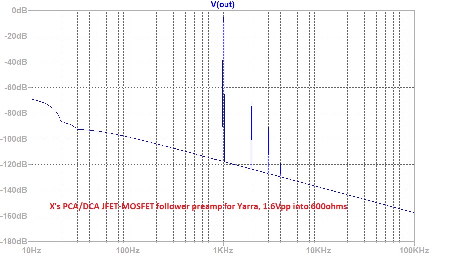

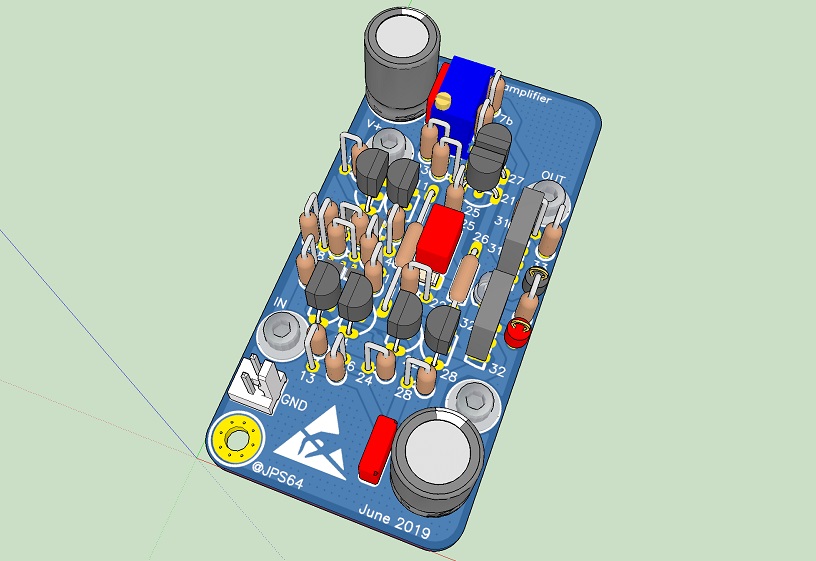

A teaser showing that JPS64 never rests, here is the next Yarra preamp module. This one is based on my JFET input/MOSFET source follower headphone amp which should give a very sweet sound. It will let your Yarra work as pretty nice headphone amp for driving headphones with impedances as low as 32ohms, ideally 50ohms or higher works best though. Bias current is about 125mA.

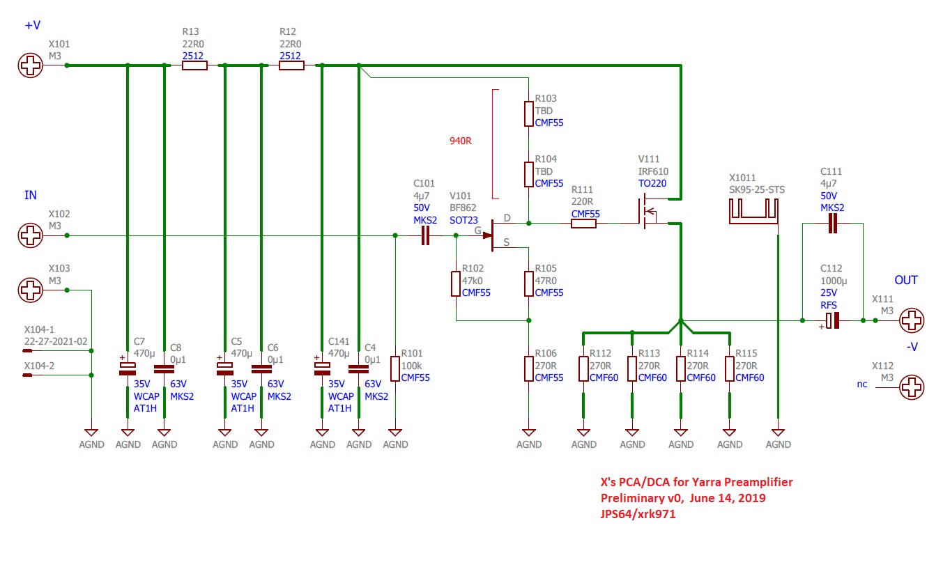

Preliminary Schematic:
Predicted FFT for 1.6Vpp into 600ohms:

X, can this new design use a 2SK170 instead of the BF862?
I am lucky enough to still have a stash of genuine Toshiba's hidden away here.
Yes, but I did not ask JPS64 to put any though holes for the 2sk170. You could just solder the legs onto the SOT23 SMT pads. I had this option actually on the Desktop Class A (DCA) amp, but no one ever used it. The BF862's are end of life, but I think you can still get them from eBay easily. I will have to check in a simulation to see if an SK209 is compatible.

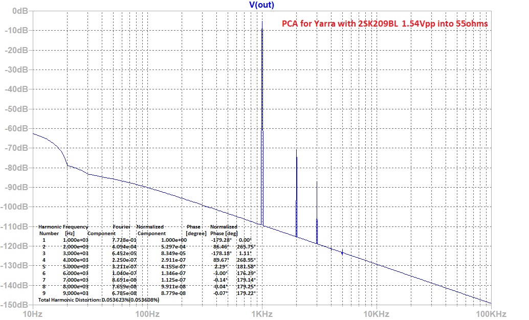

So I ran a simulation on LTSpice with the 2SK209BL (readily available SOT23), and the performance is very good. Driving 1.54Vpp into a 55ohm load has 0.054%THD with a nice profile:
But requires changes to setpoint resistors:
R103+R104=2700R
R105=220R
R106=680R
Pretty simple change actually.

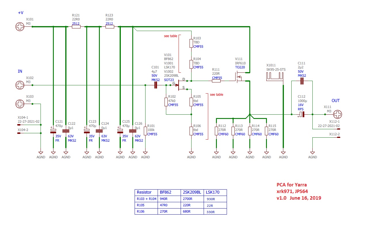

Hi X, do you think we can twist JP's arm to get through holes added for 2SK170 or LSK170 TO92 package Jfets, thanks. I am sure this will make the board more appealing to the members around here, and you would more than likely get more orders as well, I am sure.

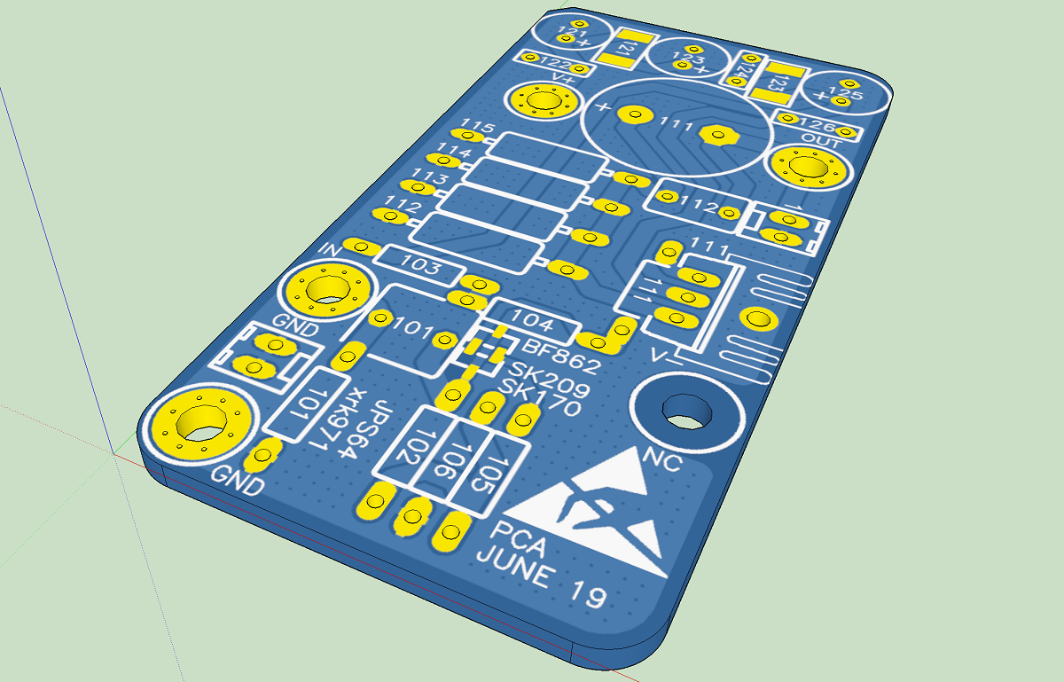

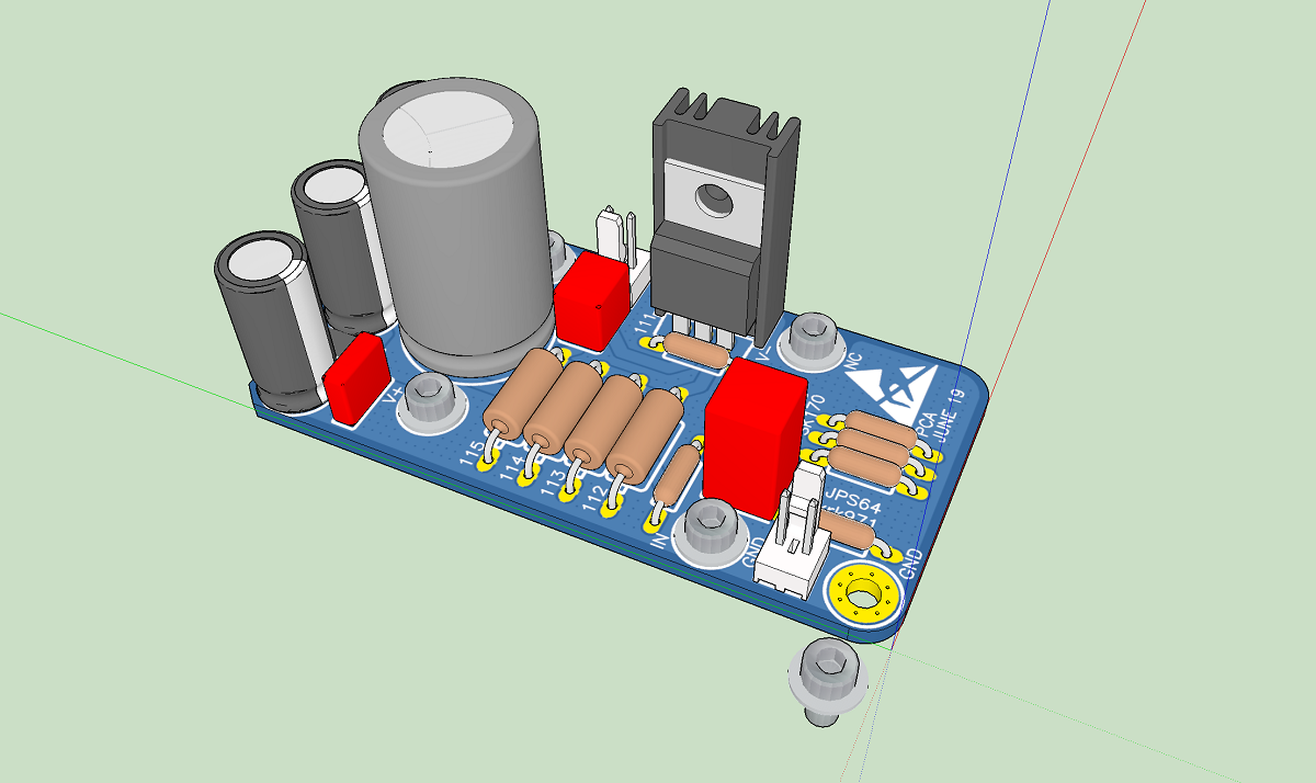

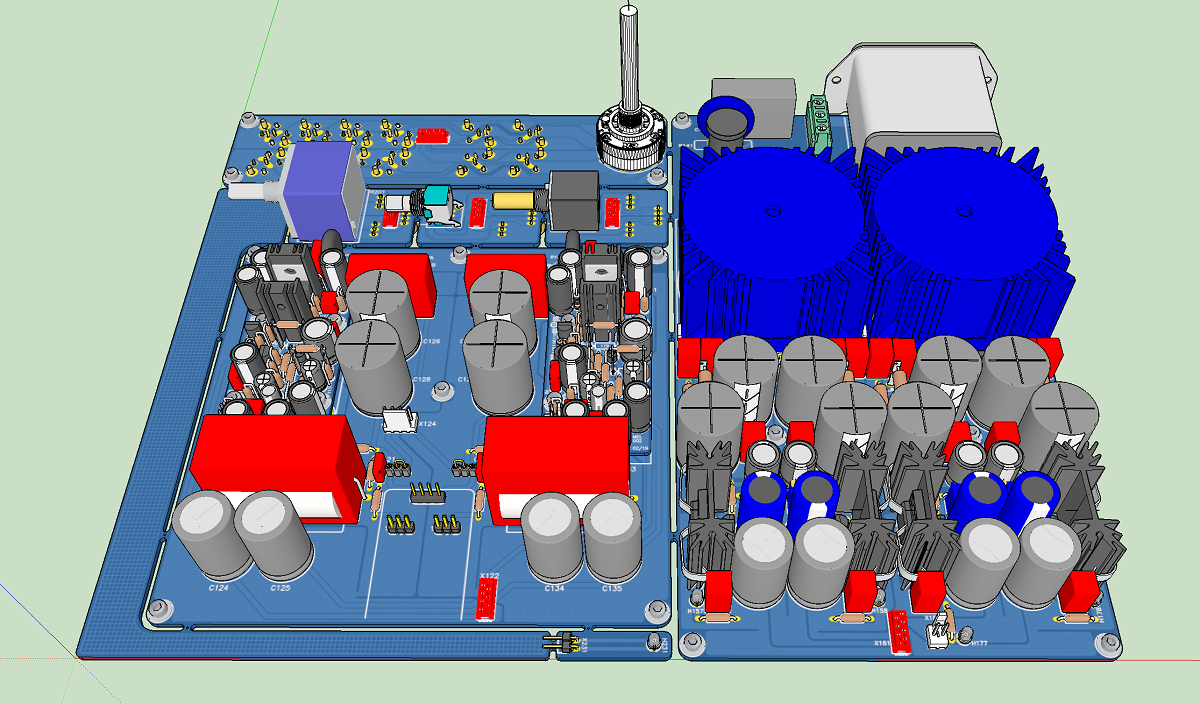

Presenting the Yarra v2 for GB2, now with tented vias (covered with solder mask). Also, the extra pads for the triangular holes on the rotary switch have been added, negating need for an additional and separate I/O board. These should be much easier to build and less prone to solder bridges. They do lose that cool golden porous matrix look though:
Thanks for making these boards even better JPS64!

Thanks for the comment zman01 re adding lands for TH type JFets similar to 2SK170 - hope that gets done.
X - would look forward to any resistor changes if you could sim with 2SK170 or LSK170, thanks. I would use these over the SMD types any day.

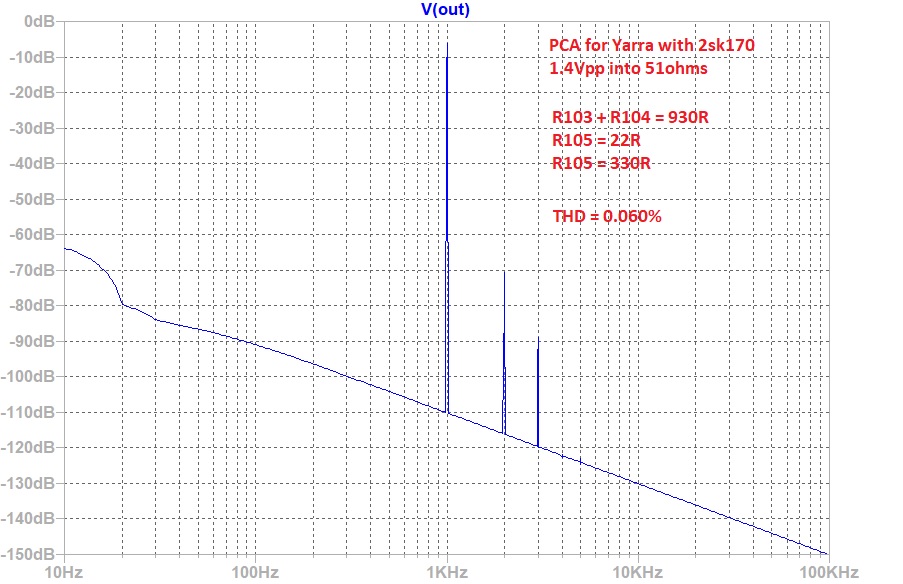

I just ran simulation of 2SK170 for you Gary. It looks like if you set:
R103 + R104 = 930R
R105 = 22R
R106 = 330R
It can work really well and gives 0.060%THD with the following profile for 1.4Vpp into 51ohms:
What's interesting is that it likes a low impedance (circa 50ohms to have low THD as shown). So if driving a high impedance load, add a 50ohm load in addition. This can be done by changing the Yarra output cap load resistor from 47k to 51R.

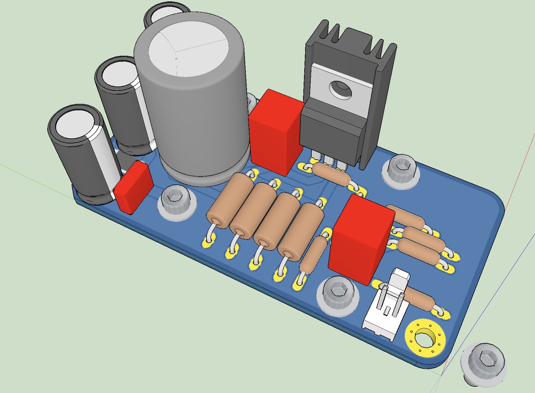

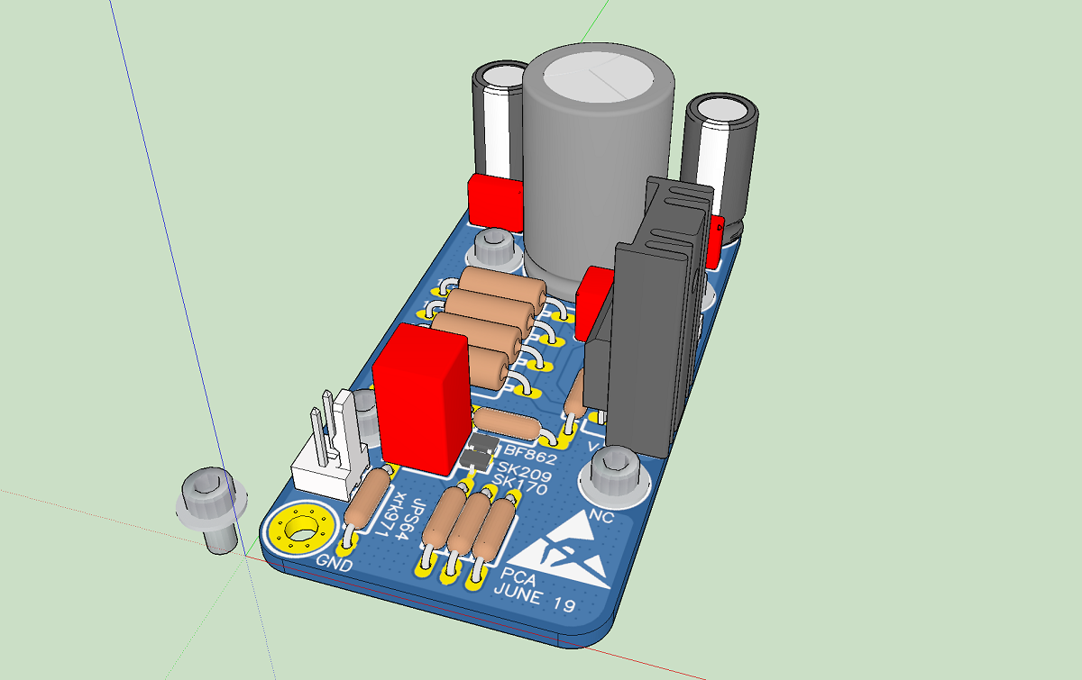

Here is the schematic and some new renders of the PCB with tented vias.
R103 + R104 = 930R
R105 = 22R
R106 = 330R
