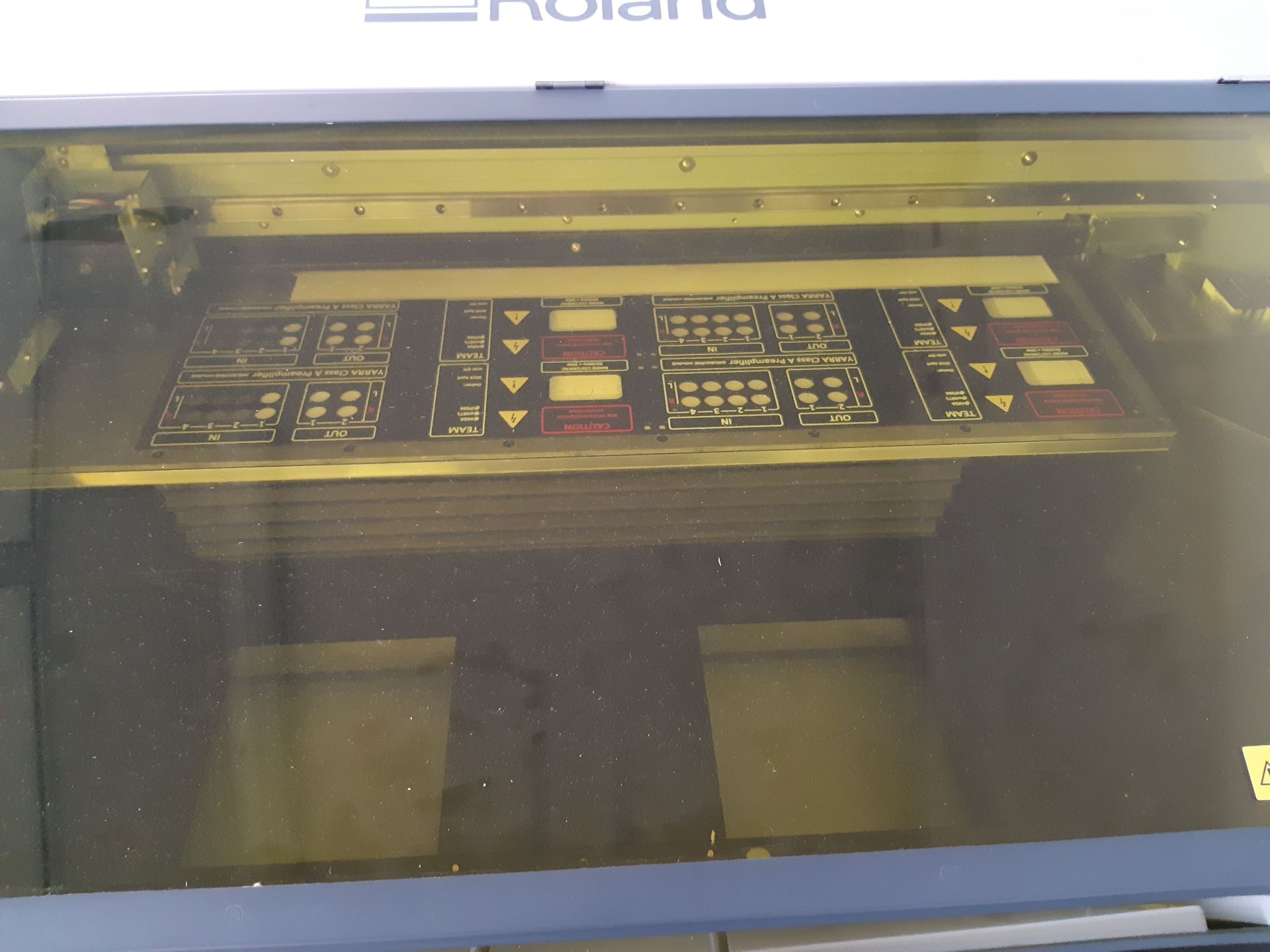

Hello guys,
HIFI2000 YARRA enclosure rear plate progress...
JP
JPS64 What printer are you using to do this? It looks very nice!
