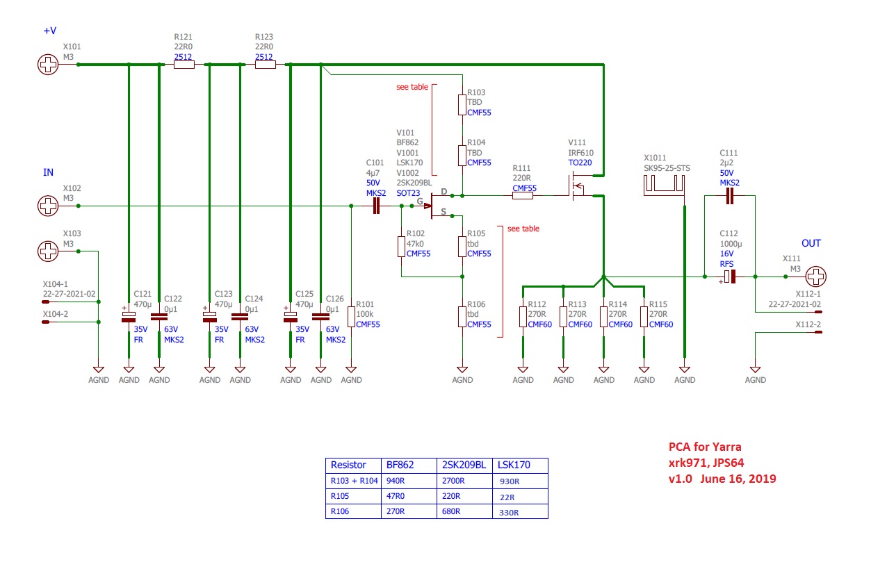

Hi again X, with regards to your comment re low impedance, are you talking about changing the value of R102 in this circuit from 47K as shown down to 51 ohm - or are you referring to a resistor on the Yarra main PCB, if so what is that resistor number, thanks?
No, R126 and R136 on the main board. If you have the output coupling cap on the main board, you don’t need it on the daughterboards. Or vice versa. For those with DC coupled output boards, the on board coupling cap C112/111 are we useful.

Now another tech question for you, seeing you like to answer them. I wonder what this new circuit would sim like if one were to use the Toshiba 2SJ313 instead of the IRF610 (same pin outs). If OK that would give an all Toshiba active device circuit for all who are nostalgic about these great but now obsolete devices. By the way, the genuine Toshiba 2SJ313 is still available from a few sources around the globe.
You can use the Toshiba J313 - it won’t sound any better really, just cost you more. I have tried them before and they have similar sound as MOSFETs go. There are no changes needed really. The Fairchild FQP TO220’s actually sound very good too and worth trying. Not expensive either.

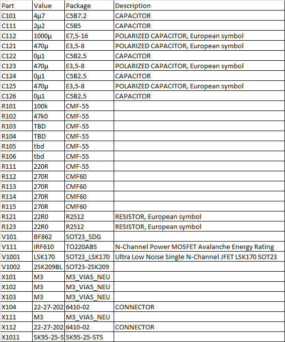

Hi X, can you advise what is the max diameter of the 470uF caps C121, C123 and C125 on the PCA Yarra DB, thanks.
Also the screen printing for output caps C111 and C112 has been transposed from the schematic - or the other way round.
The big 1000uF C112 cap is 16mm dia with 7.5mm pitch on leads
The 470uF caps (C121123/125) are 8mm dia with 3.5mm pitch on leads
It does indeed look like the silk screen has the numbers for C111/112 transposed. Good eyes!
Will let JP know this - not sure if it is significant enough to warrant another Gerber though.
