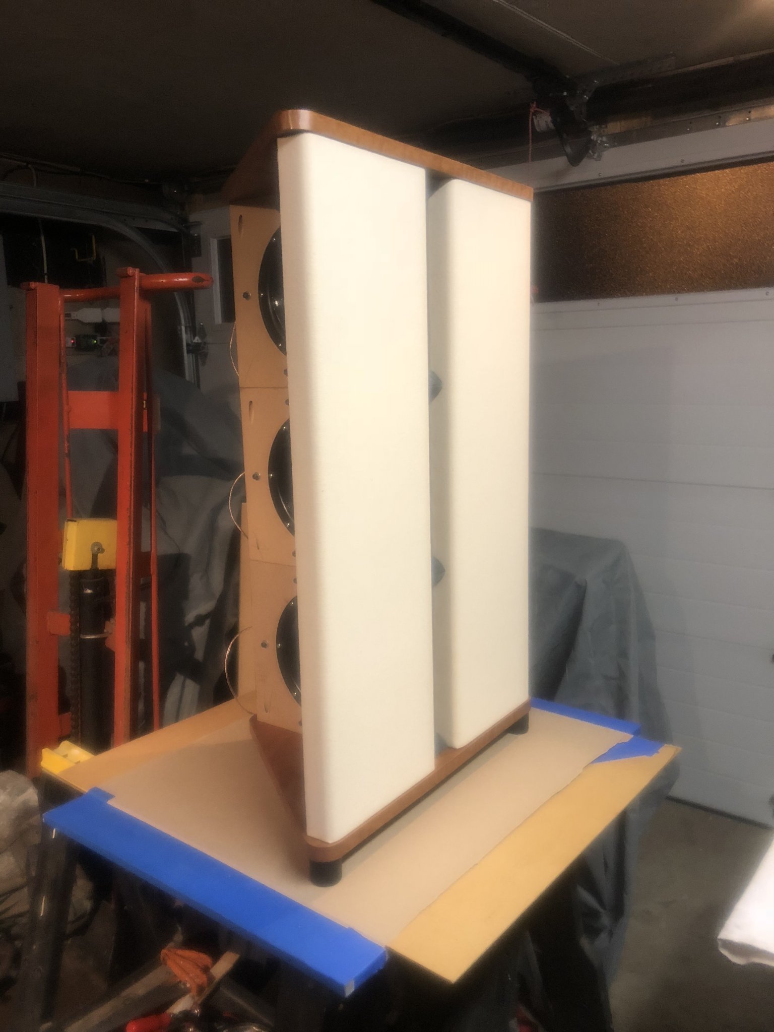

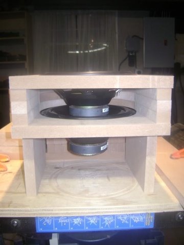

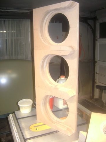

I took an interest in making something similar to this after I read Pa’s SLOB article years ago.
Took it as far as I could without crossover design skills…instead opting to find one of his B5 units used.
I built the bass units separately and stacked them onto the back of a baffle I could “live with”…about 20”X32”.
I used some drivers Pa tipped us off about on “Buy Out” at parts express. Some Peerless 8” 91.5dB poly woofers 12 Ohm wired series parallel (6) per side in same push pull arrangement for 8 Ohms.
I never got the bass output I was hoping for.
Maybe because in comparison I had much more efficient Oris horns on top of them.
I was driving the bass panels with two 120 Watt bridged Rotel HT amps as opposed to 25W push/pull tubes on the horns.
I’m wondering if the missing 8” of additional U baffle width was all that was holding it back?
I didn’t notice if you were doing anything else or equalize or give the bass a boost in your design.
I still have the panels and I’ve often thought of setting them back up active with some hypex amps I now have.
Just wondering if its worth the time in regards to bass extension now that I’ve heard 15” AE dipoles on OB and was considering the pursuit of a larger version slob with multiple AE drivers?

Nice build! Just add a U baffle (i.e., wings) and that extends the baffle width without making the front larger. The bass extension in OB is primarily a function of the baffle width. You are at 20in and that’s less than the 12+8+8in I have. Also, the U shape adds more virtual width to baffle I think. Add some wings and you should get deeper bass. I do not use any EQ. If running active DSP, certainly a Linkwitz transform or bass EQ can help a lot as there is a lot of room left given the low distortion. Can you wire the drivers for lower impedance? I am at 97dB at 2.83v before OB losses so about 91.5dB net. But that’s 4 ohms. If you have a 2ohm capable amp, wire them parallel / parallel and buy a lot more sensitivity. It may even be better to wire 2ohms nominal and add 3ohm power resistor in series to increase Q for more bass extension below Fs. There will be 2-3dB loss but you will have about 6dB more gain than before.

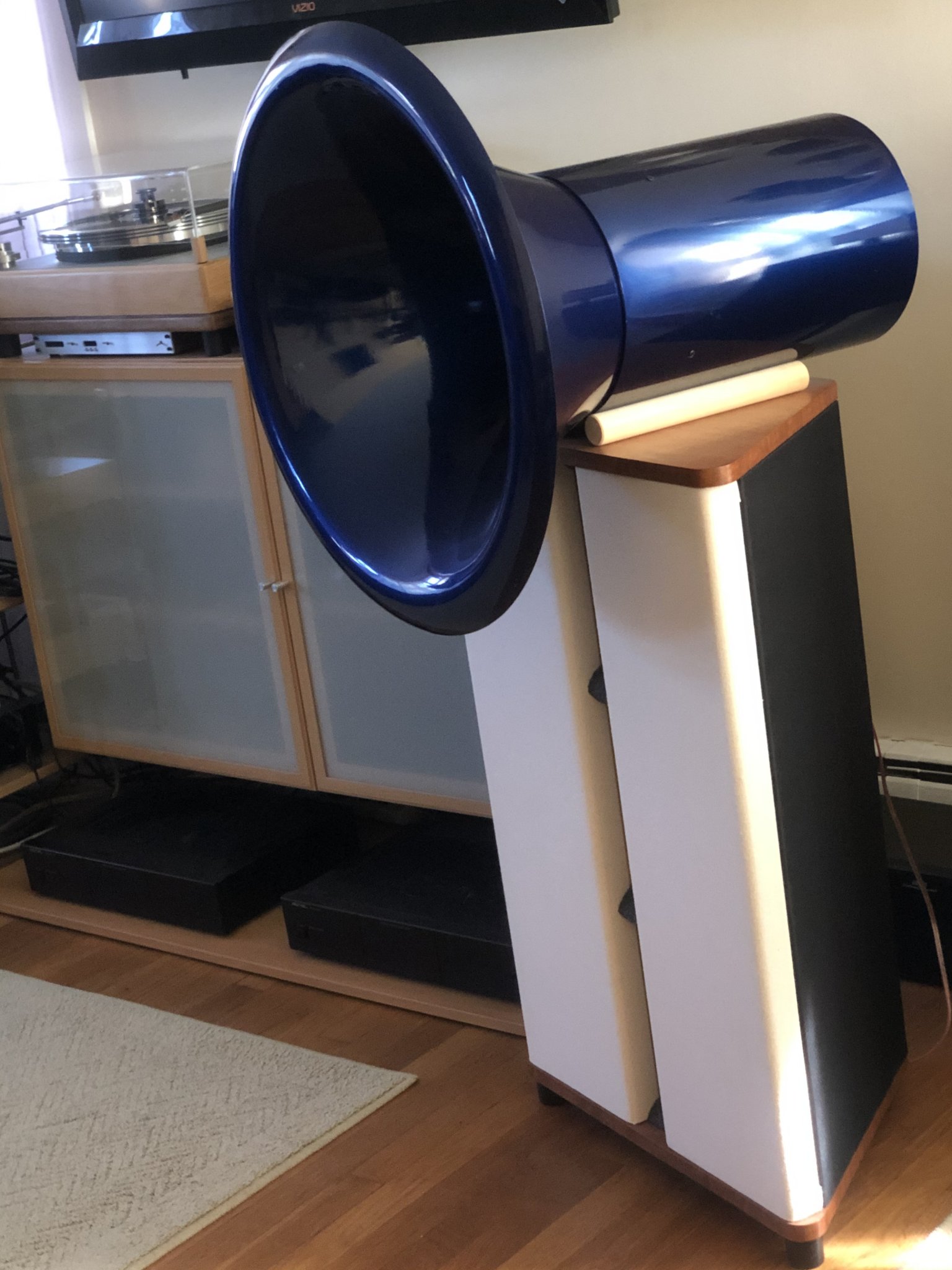

I think I’m gonna give it a try…I like how the top of your “U” legs taper down towards the back of the speaker.
I was struggling to maintain aesthetics and a smaller footprint with my design.
I was thinking to put something with a little lower sensitivity on top like some 4” fullrange Fostex drivers in modified B52 horns I also got on “Buy Out”.
