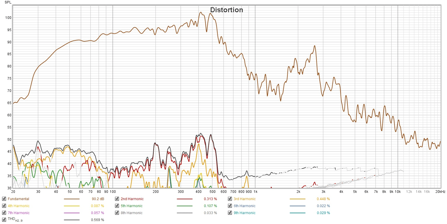

Thanks, lrisbo.yes that distortion graph is impressive. Where does the unEQ’ed woofer response roll off from? are there a resonance from the cavity on the back (hollow back)? maybe what the pyramid shaped damping is for?
Here is the raw woofer in SLOB response. This was before I applied Noico mass damped butyl onto the stamped steel basket. There was a 200Hz ringing peak from the basket that is clearly visible here. The roll off starts at 470Hz as predicted by the depth of the slot. This was before I added the eggcrate(pyramid) foam. Although I am not sure that the foam reduced distortion. More to reduce resonance and midrange leakage above the 470Hz rolloff frequency. There is no EQ per se, as this is a passive crossover. I did apply a shelving function with a high value resistor in parallel with the first low pass inductor. I did not experience a slot resonance peak. Might have something to do with a magic combo of poly cone driver, higher Qts, and rather large slot cross sectional area.
I couldn’t help but wonder what the distortion plot of an XSD with 8x Purifi PTT6.5 would look like? -110dB at 50Hz 😛
thanks xrk971
I suppose the slot acts as a quarter wave resonator - looks like the 470Hz matches the depth of 6.5” frame. The drivers must add some damping as you say. The slot thus gives a 2nd order low pass with some Q value (somewhat larger than 1). Funny to see that the harmonics also get killed by this low pass.
The acoustic front /back shorting of the bass is not very pronounced. Maybe a corner around 150Hz? there are of course these back wings to increase the path length form the back. Wonder how the 360deg radiation pattern looks like. the nulls are probably pointing backwards relative to the baffle front plane?
Will show to Lyngdorf who loves OB and PTT drivers. Maybe the 8x PTT6.5 dream becomes reality. In this case it must be active or use air cored inductors to avoid the hysteresis distortion

the hysteresis distortion is a different beast than simpler types of distortion. it shows up as odd harmonic disortion for sine waves but when the signal is more comples, it reveals that it has strongly nonlinear memory of the past signal. When the current crosses certain thresholds set by past signal reversals the inductance jumps and produces a transient 'crack'. Our ears seem to be very sensitive to this kind of distortion and we prioritise to bring it way down. The PTT6.5X is at -80dB (1Amp peak, 1kHz), the new PTT8 is at -90dB and we have prototyped a 6.5 with -100dB. It is first something one notices when it gets reduced and then after a short while one does not want to ever go back. We have not had resources to do formal blind tests. You can read more here:

some high hysteresis drivers even give a crackling sound when sweeping them. the -100dB 6.5is an experimental prototype. hope to release it. its rather addictive.

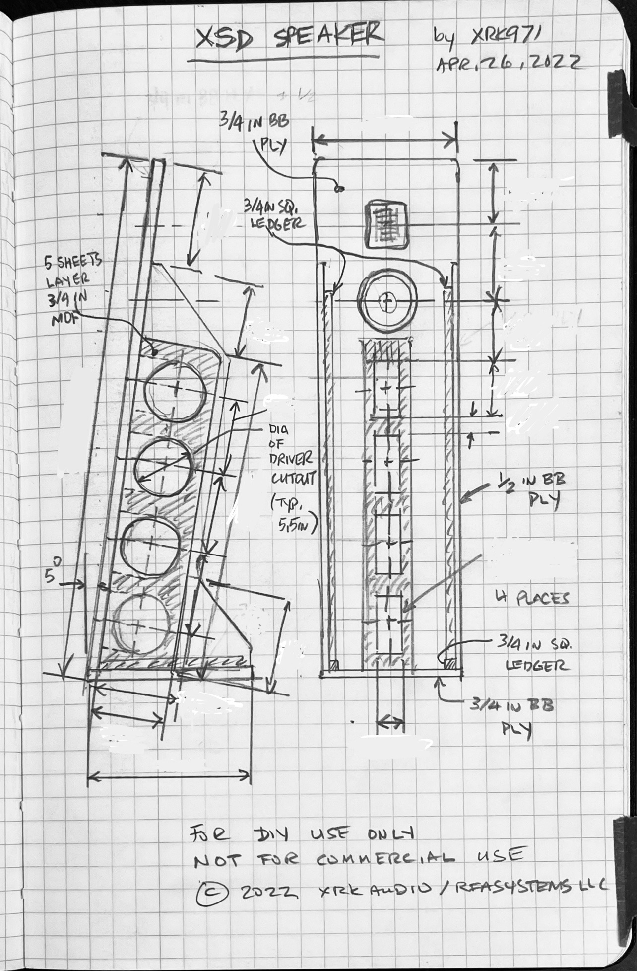

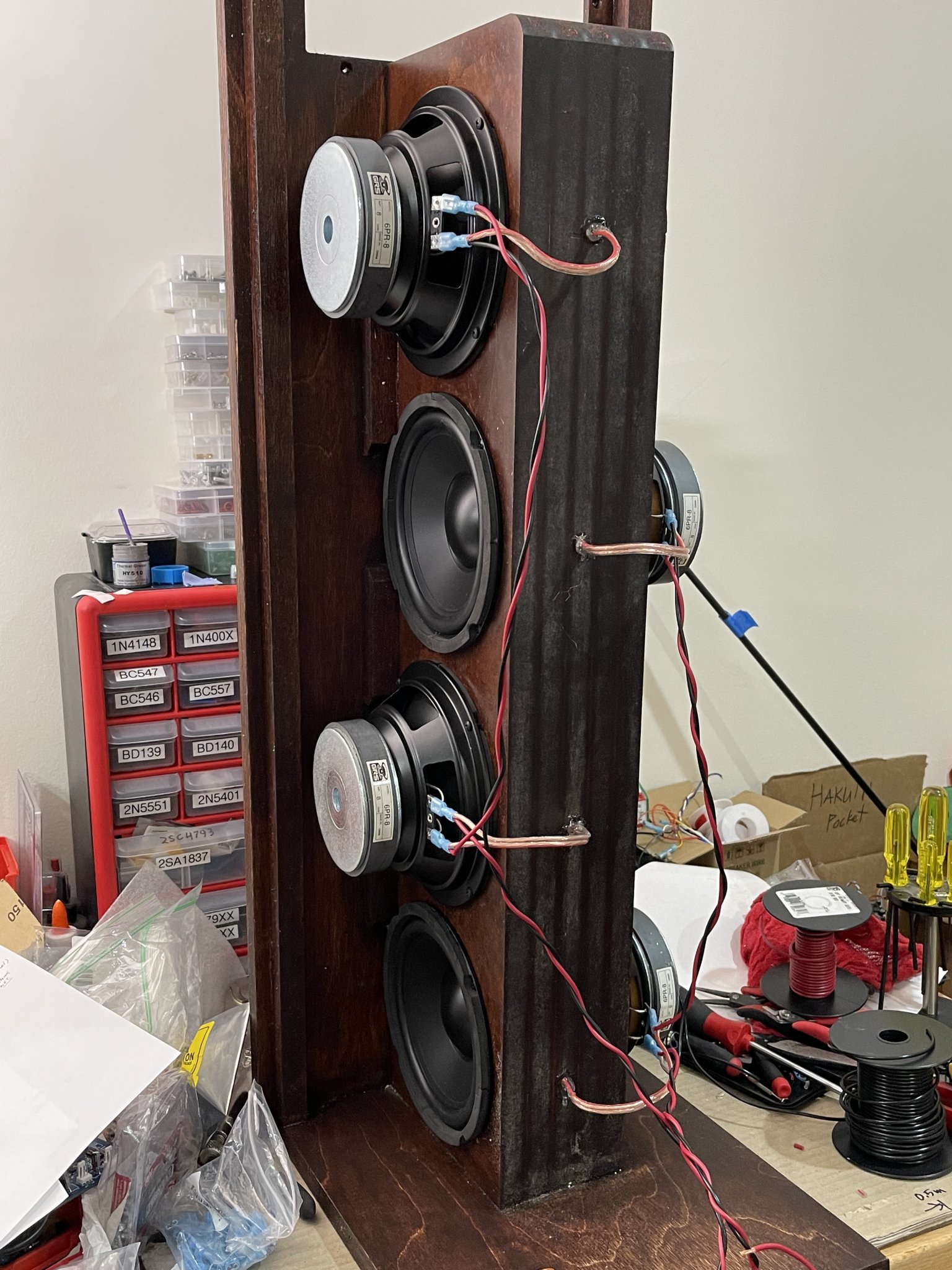

What a wonderful project! I understand this is eventually going to be a commercial design with a passive crossover so I apologise if any of my questions are too intrusive.This is a thread dedicated to the eXtremely Sexy Dipole (XSD) speaker that originated as a cardboard prototype 8 years ago in this thread.
The woofers I used are GRS 6.5in poly cone rubber surround 8ohm budget drivers. The floor footprint is 12in wide x 14in deep. It stands about 45in tall
I should mention that the woofers are wired 4x parallel, then two pairs of those in series, then a pair in parallel at the end. Make sure the opposing ones are wired correctly so that they both squeeze air out when the signal is positive. This results in a 4ohm nominal impedance and a sensitivity of about +12dB on top of whatever the nominal 8ohm rating is after baffle step losses. So for an 85dB driver we get about 91.5dB at 2.83v (that’s 2W into 4ohms). What this means is that the drivers barely move for significant SPL and that leaves a lot of headroom so that the distortion is very low.
For anyone interested in building this speaker as a personal DIY project, PM me with your email and I will get you the dimensioned version of this sketch.
1. For those of us for whom even a 12" wide speaker is too big (not WAF acceptable) what parameters do we need to consider for woofers that are compatible with this type of open baffle?
We have an 8" GRS woofer available in India with a published Qts of 1.1
https://diyaudiocart.com/GRS-8PR-8-8-inch-Poly-Cone-Rubber-Surround-Woofer?search=GRS
6 of these would result in a nominal impedance of 5 ohms and a sensitivity of about 90db. Do we consider any baffle step loss for this woofer configuration?
Do the "woofer-pairs" have to face in the same direction? Why cant they be oriented so that their baskets are on the "outside" and they both face the "ri-pole slot/cavity"?
Would a woofer with a Qts of 0.4 work? I ask because one option is this HiVi woofer.
https://diyaudiocart.com/Raw-Driver...e-Midbass-Woofer-8Ohm?sort=p.price&order=DESC
8 of these would result in a nominal impedance of 4 ohms and a sensitivity of 92db before any baffle step compensation.
It has a slightly shallower basket which can help reduce the total width of the loudspeaker especially if we can orient the "woofer-pairs" so that the baskets are on the outside.

The 8in GRS woofer would work well. It would lower the upper frequency of the crossover down to 350Hz which is not a bad place to be. The sensitivity of the speaker will be about -6dB below the peak predicted theoretical due to it being a finite baffle width and having some front to back cancellation. How are you wiring it for 5ohms? I see 1.33 ohms or 12ohms nominal. But 6x 4ohms can get 6ohms. Lower Qts drivers have a more powerful motor so will not be able to reach frequencies below their Fs without active EQ. But if the Fs is low enough already then it’s fine. You can have drivers arranged with baskets all out. If drivers do not have symmetric in and out non linearities then the distortion will not cancel as well. It will still work quite well. If you deviate from my drivers then you are on your own with the XO.

The 6 x 8" woofers are each 8 ohms and would be connected into 3 pairs of 16ohms each. Then wire the 3 pairs in parallel and that should give 5.3ohms.

I believe you are using the following:
Tweeter: GRS PTT2522-4 with waveguide
Midrange: PRV 5MR450NDY (8ohms)
Woofer: 8 x GRS 6PR-8 6.5in woofers, 8ohms wired in series/parallel to give a combined nominal impedance of 4 ohms.
