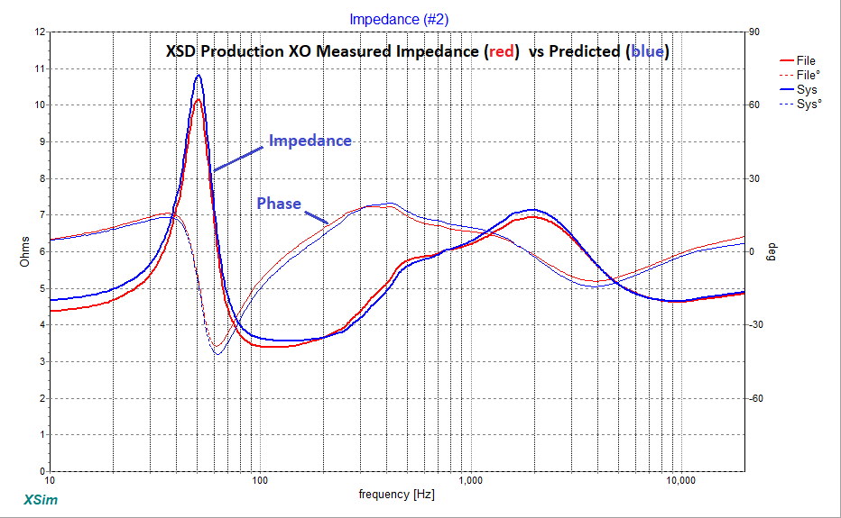

On the bench tonight is a quick impedance sweep of the XSD production crossover as installed in the XSD speaker using DATS2. The measured data (red) is superimposed with the predicted (blue) curve from Xsim shows almost a perfect match. This indicates that the XO component values are very close to the specified values.
What we have here is an extremely easy to drive load for an amp capable of 4ohms output. The impedance varies smoothly from about 3.4ohms to 7ohms with a woofer resonance peak of only 10ohms at 50Hz. This means that most amps won't have a hard time because the impedance does not have large value peaks, nor ultra low value dips and the values vary smoothly.
