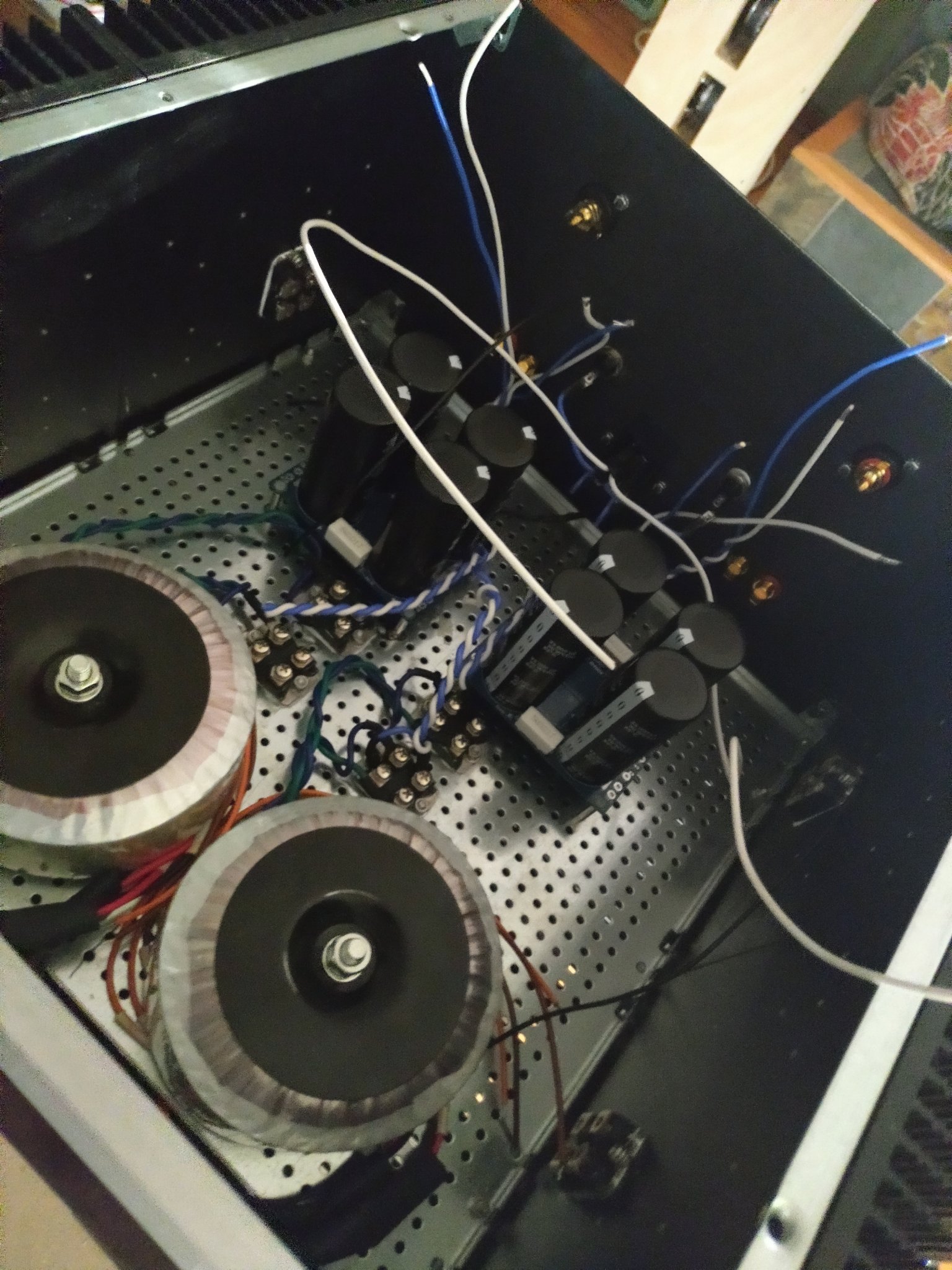

Oh, I'm not finished, they are just playing. Effort now shifted back to amp, very close......
