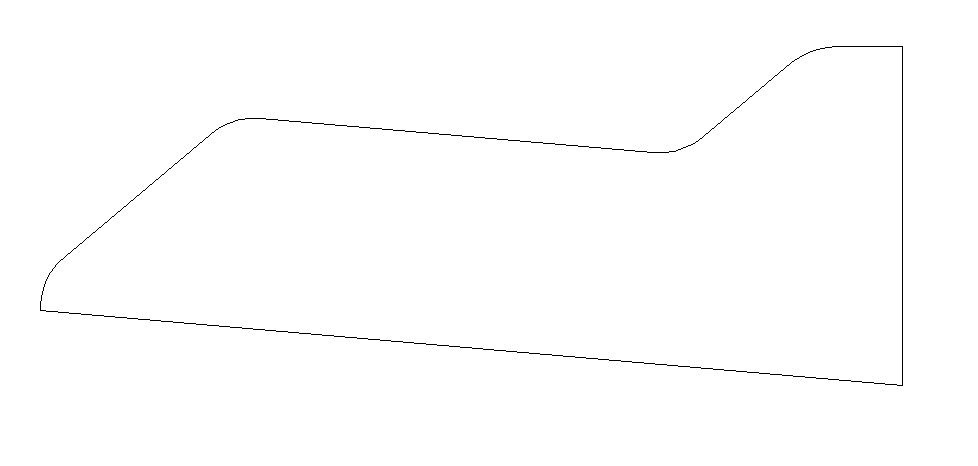

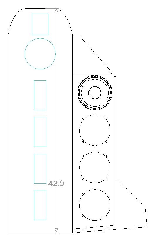

Attached is a 42 inch high version. I also changed the shape of the baffle above the top of the flanking wings to give it a slimmer look. Will that baffle change affect the crossover?

Changing baffle shape will definitely affect the XO. The key rules to preserving a proven crossover are: (1) use same drivers; (2) keep CTC distance and baffle offset the same; (3) do not change the shape or width of the baffle. The latter affects the frequency extension and diffraction. It may be minor but won't be the same. Changing the shape of the wing will affect bass extension. If you make it deeper that is fine but not smaller.From post #102 per xrk:
One last design deviation question and then I’ll leave you alone if you don’t mind?The passive XO is the only way I can have any assurances that the crossover and voicing is as I designed. When you do active DSP XO, I can tell you the crossover frequency points, but the voicing and slopes and integration of the drivers to be smooth in phase space is really all yours. There is no guarantee that it will sound like how I designed it.

If you changed the chamber volume it may affect the upper bass crossover point. Definitely changing the slot dimensions will change that.

Cross section aperture?......you mean the slot height and length? If i were to adjust for the volume, it would be the depth of the slot or the distance between the two cone faces?
Yes the exit aperture area of the slot should be maintained.
Don’t adjust the depth as that affects the 1/4 wave cancellation frequency. The slot depth as designed allows for a 470Hz woofer low pass fall off from the depth. If you make it deeper (for example to fit an 8in woofer) that changes to 370Hz. So that affects the XO frequency.
It sounds like you like you are a tinkerer and not a by-the-book plan builder, if I understand your thinking based on these questions. I would suggest you go the active DSP route and you can account for the changes in the mechanical design of the speaker if you choose to modify it.
If you want to use the passive XO as-designed (the schematic and parts have to be purchased as a kit from my shop as this is a commercial speaker that I designed with assistance of business partners), then you should stick to the mechanical dimensions as close as possible. Especially: driver to driver CTC distances and locations, baffle width, wing depth and shape, woofer apertures, woofer chamber depth, tweeter and midrange rebate depths and brand and model of drivers. These all affect the specific XO as designed. But if you go active DSP, you are in your own as to filter development etc. I can only suggest XO points and slopes. You can see all that from the XO response curve on post 1.
