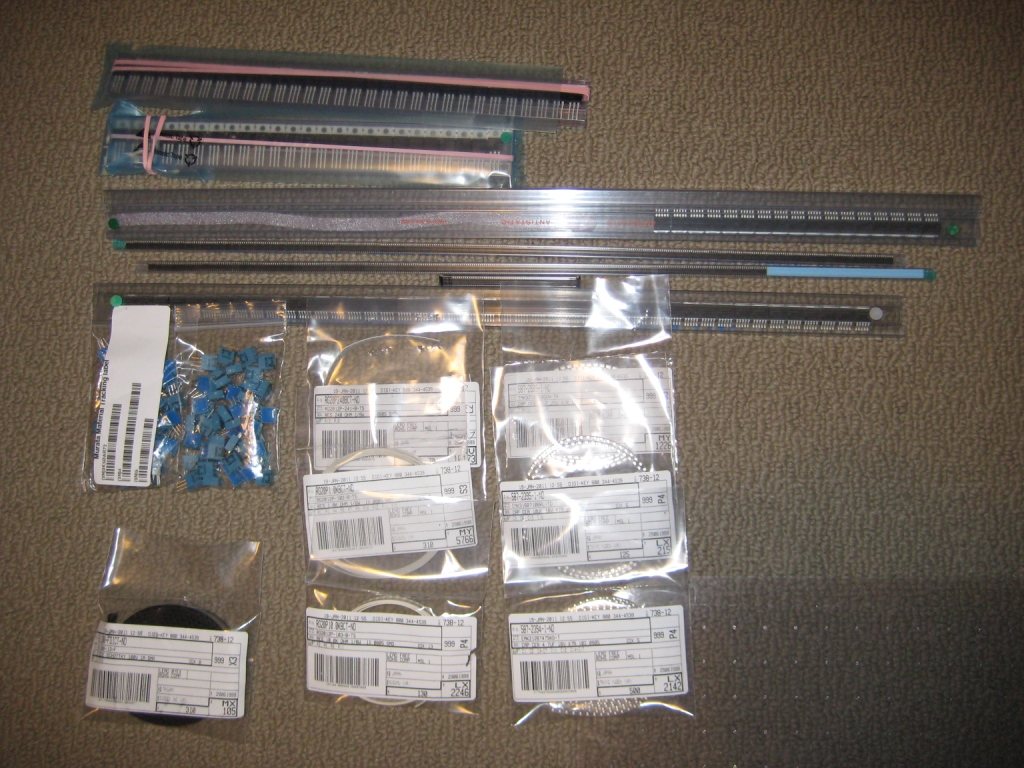

Hi Guys,
Ever wonder what $2200 worth of electronic parts looks like? Pretty nondescript if you ask me.
Absolutely all the parts arrived in good order, and I'll be starting to organize the kits this weekend. My goal is to do 10 kits by Monday, 10 on Wednesday, and the last 10 on Friday. All kits will ship in the order of payment.
