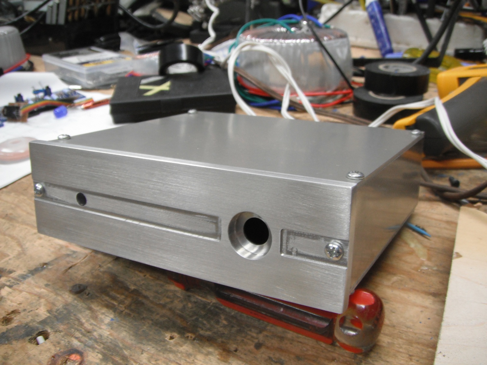

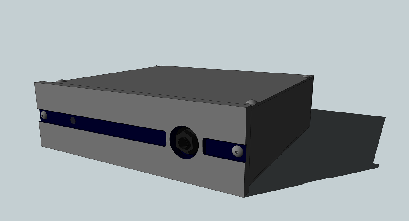

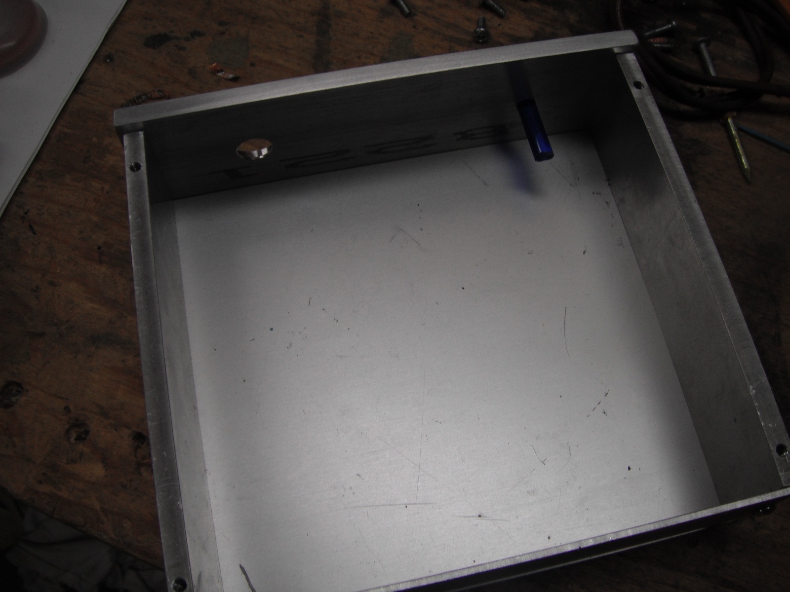

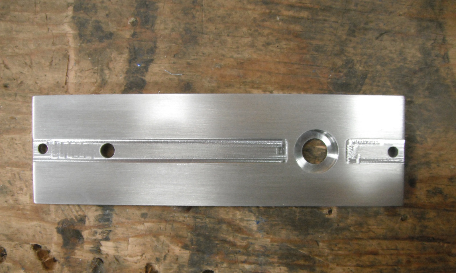

I modeled a case that would fit everything because I'm getting tired of separate PSUs. I went out to my shop and started cutting aluminum, thankfully I'm lucky enough to have a mill, and by now I've nearly completed the case. Just the connections in the back panel and the mounting holes on the bottom to drill. I am planning to paint the milled out portions of the front panel dark blue and replace the phillips screws will allens. The whole thing is 6 3/8" by 5 7/8" by 1 7/8". Pics below.
It sure sounds like what you propose for your case will work, I considered it, but still wanted a single case for this project.

Looks good 🙂
For now my preference would be to put everything in one extruded enclusure of 100 x 160 mm. I will reconsider after I have received the boards.
