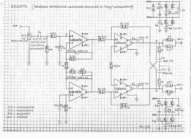

Hi OPC, and everyone interested.
My suggestion for Your next project with balanced output:
Here You can see my idea for a balanced headphone amplifier.
Instead of a “old!!?” LME49710 is useful to use the new LME49990 or another ultra Hi-performances operational amplifier as pleasure.
I think the “Super Symmetry” topology is better than a conventional balanced output stage since the S.S. have an inherent crossed distortion cancellation that push the output stage to a very low distortion performances . Moreover with a little amount of components combined in an very elegant way ,as the SuSy is, is possible to realize a super Hi-performance headphone amplifier that can drive any kind of dynamic headphone at any level with negligible level of distortion.
As Mr. Pass say ,for the best performances is very important that the resistors and the traces placed in the crucial positions for the mutual cancellation action should be matched at least 0,1 % or better. So is also important the perfect symmetry and equal length of the physical traces placed in the P.C.B.
For other info about SuSy applied to the Current Feedback chips check the phrase “Monolytic Supersimmetry” in the Nelson Pass forum.
Due to low power supply rejection ratio of the current feedback operational amplifiers is probably better to use a “Jung Super Regulator as power supply circuit instead of conventional LM317/337 regulators.
Since the current feedback chip employed has a relative big (for a headphone amplifier) DC offset , I suspect that a offset ,manual or servo, circuit control is needed.
Maybe the crossed distortion cancellation topology can null also DC offset?
Best Regards
Semola.
